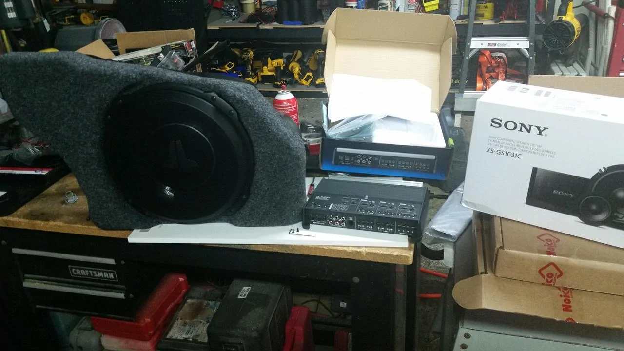

I tried upgrading just the speakers and it wasn't enough.
I just got the rest of my stuff today:
Stealthbox
JL XD700/5v2
Sony XS-GS1631C
The amp will fit in factory amp location (same physical size) with some work see Racemaster's post here https://www.mustang6g.com/forums/showthread.php?t=58862
I can drive everything with a single amp using the 3-way components up front, and if I eventually want to go full active, I can another smaller amp and a DSP.

Kratch,before you mount those speakers,did you look at the specs?
They have a 87db rating which means it will take some power to get loud.
Speakers with a rating on 90-92 db will take less power to get to listening levels.Just thought you should be aware of that.
Next is the crossovers.How are you going to wire them?Factory wiring?
Here is what I did before going active and worked out well.Each "section" of the crossover was mounted near each speaker,using the stock wiring.

I did take a very close look at the specs and I realize they're not as efficient as some other sets, but I am OK with that. I am replacing factory wiring with twisted 16AWG for front woofers and mids and mounting crossovers under dash on starboard panels. The crossovers will accept 2 inputs for each side, so that may help with the low efficiency. It may not, but I'm gonna find out.
I would rather have good quality sound, and this set was recommended by the local audio shop, and they even offered to take them back if I don't like how they sound because they are that confident that the new Sony 3 way is awesome. I think they're still listed as available soon on Sony's website so there really aren't many reviews on them yet. Am I taking a risk trying out something new? Yes, but someone has to do it. These could be the next big thing for late model mustang audio if they pan out. If not, well then I'll get the Focal AS3 or Hertz 163.
There are a number of S550 owners at work interested in how this turns out, and I think this represents the type of audio upgrade many of the people I know are interested in - a little beyond the typical amp and speaker upgrade, but hopefully still a good value for the sound quality. I guess we'll see soon enough.
Racemaster, I've referenced some of your threads and I have to give you credit for the inspiration behind this effort.

You could use the both door wires for the woofer and mid,then just run a new wire to the pillar for the tweets.Saves a lot of grief.
You are going to have to bridge the channels together and feed each crossover the full 200 watts at 87 db. Not a big deal.Use the 16 gauge wire to go to the crossover,but don't get too hung up on the small door wiring.I have not seen it make any difference.
