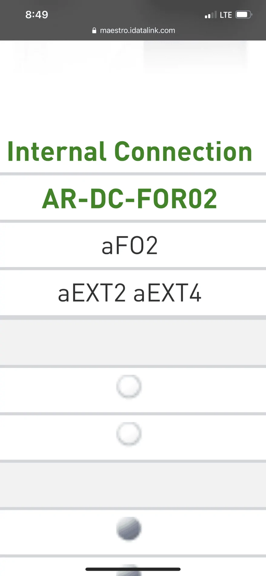

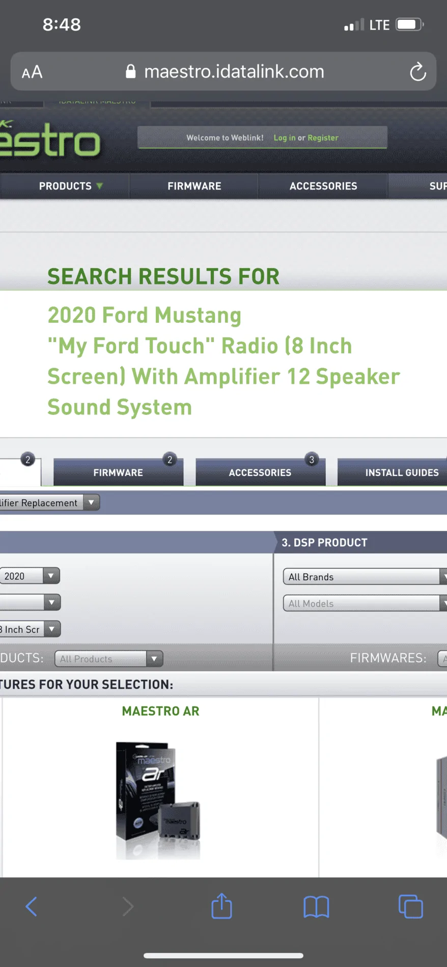

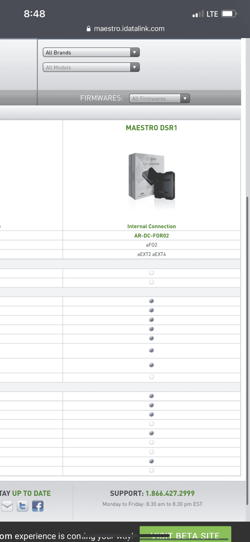

OF5.0
Mar 28, 2019
458
265
Pittsburgh
Scott
2022 Shelby GT500 CFTP
The description of the harness says it works with Ford vehicles with Sony audio (through 2017). Would like to confirm you for this to also work with b&o before adding it to the list of options. Thanks!
If you go to maestro.idatalink.com, you can select your vehicle and project. I’ve attached the screen captures using 2020 Ford Mustang with 12-speaker system:
