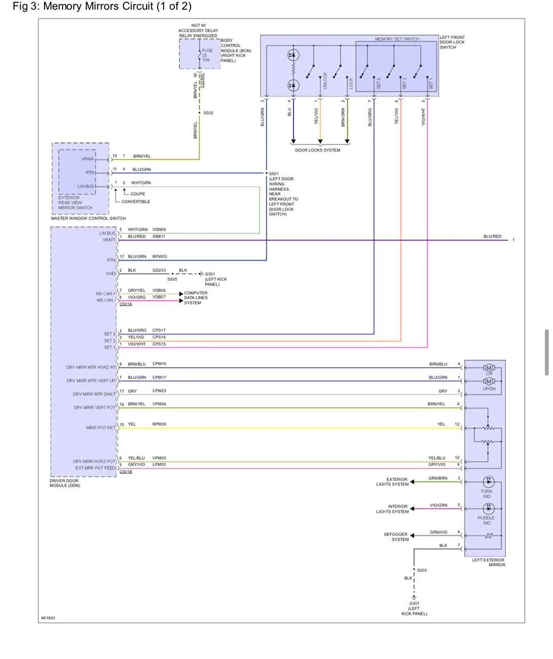

Hello I need help figuring out how the drivers door harness works with the door module and window switch and door locks and memory seats. Does it require the window switch for anything to work?

I’m wanting to put a premium door harness in my base car I have the door modules and the harnesses and the lock and memory seats button and just need the different window switch because they are different
I have it all hooked up but nothing works so I’m wondering if it’s due to not having a window switch hooked up the plug is the 3 pin needed for the switch

I had everything connected but the window switch and nothing would work so I'm wondering if the window switch is required to power the module and the door locks along with memory seats

So I’m curious where does the door locks and door module get their power from
Power comes through the BCM through various fuses.
Have you considered getting a FSM with wiring diagrams? It might help you get it sorted.

I think I found a wiring diagram would any one be able to confirm that all the power comes from the window switch?
