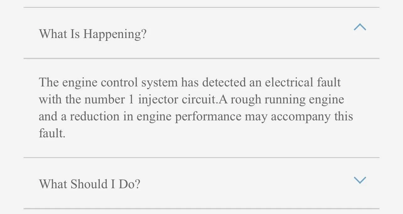

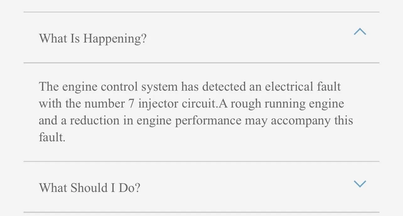

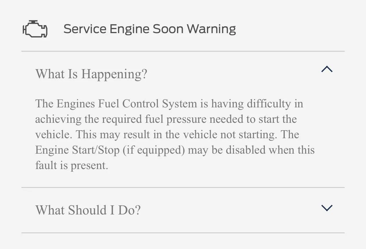

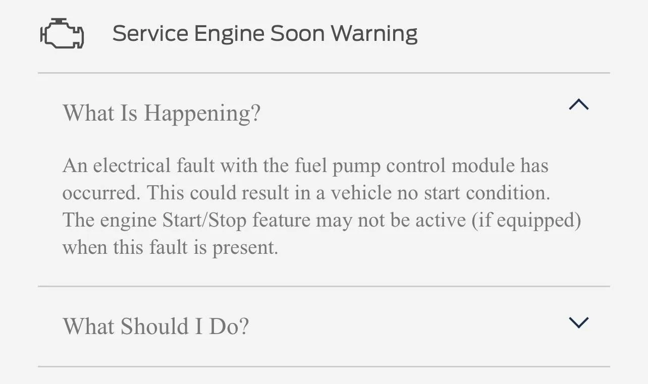

Here’s my problem. I have a 2020 Mustang GT. My problem started friday night. I topped my tank off, drove about 40-50 minutes, and when I came to a stop and shut my car off, it sat about 5 minutes and wouldn’t start again. It would fire over and immediately stall after firing, it wouldn’t stay running. After awhile, it won’t fire over at all, just cranks. What’s particularly weird to me is every once in awhile, it’ll fire over and run fine, after amount 3 hours of trying that night that’s how I was able to get it home (about a 15 minute drive with a few stop lights). The fuel pumps, both high pressure and low pressure pumps seem to be operating fine.

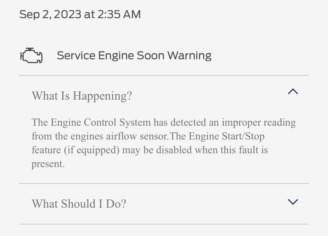

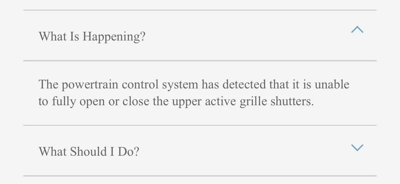

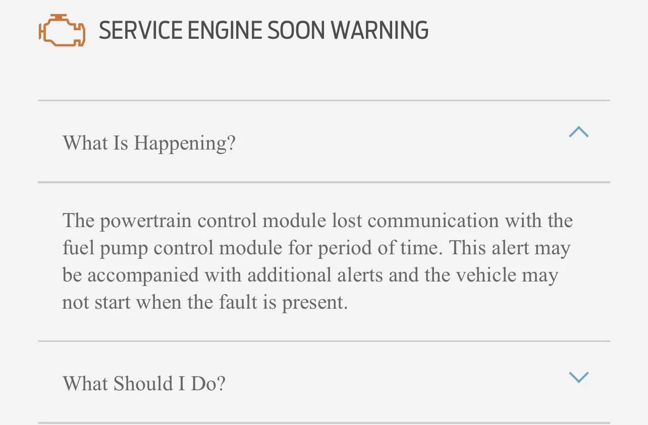

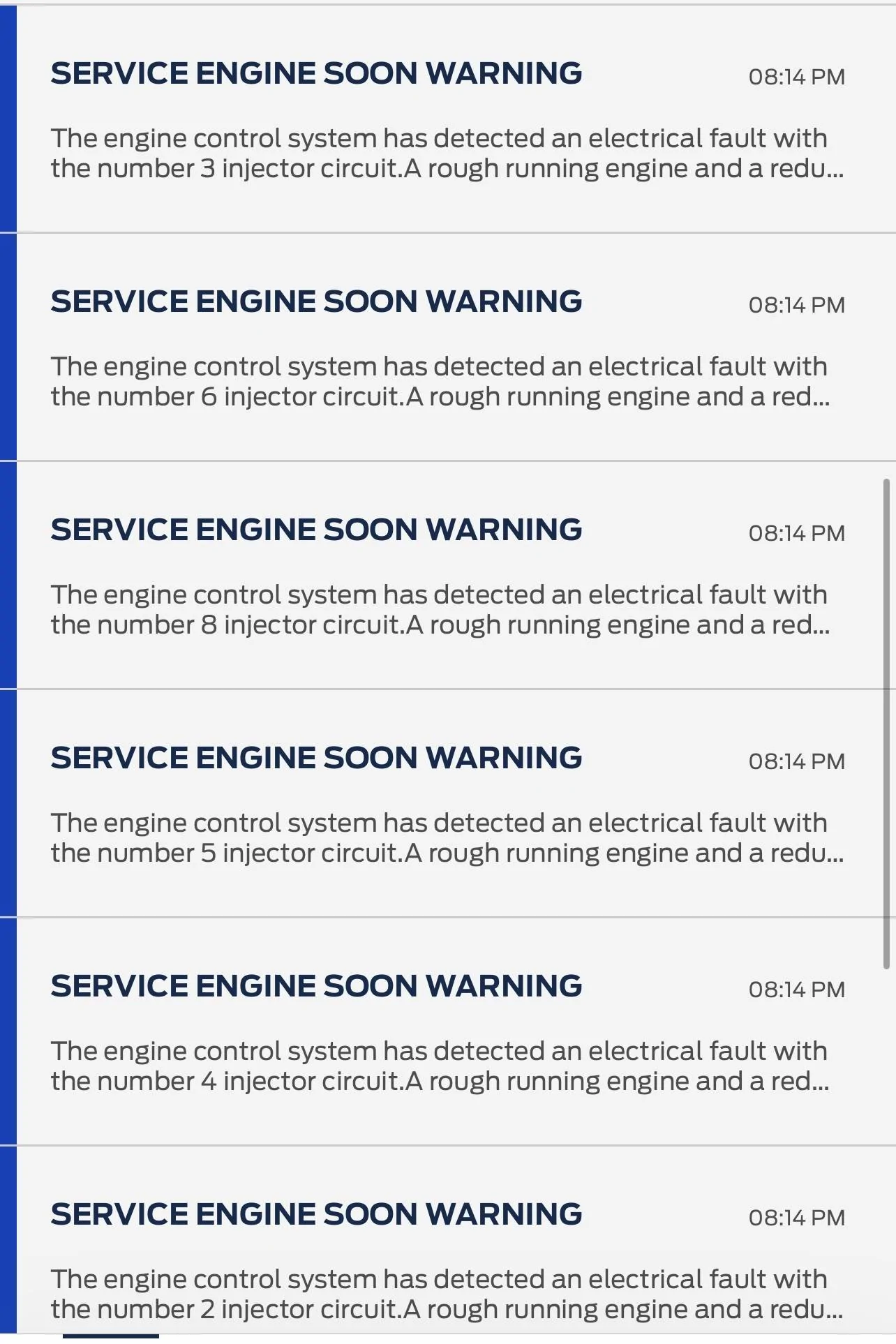

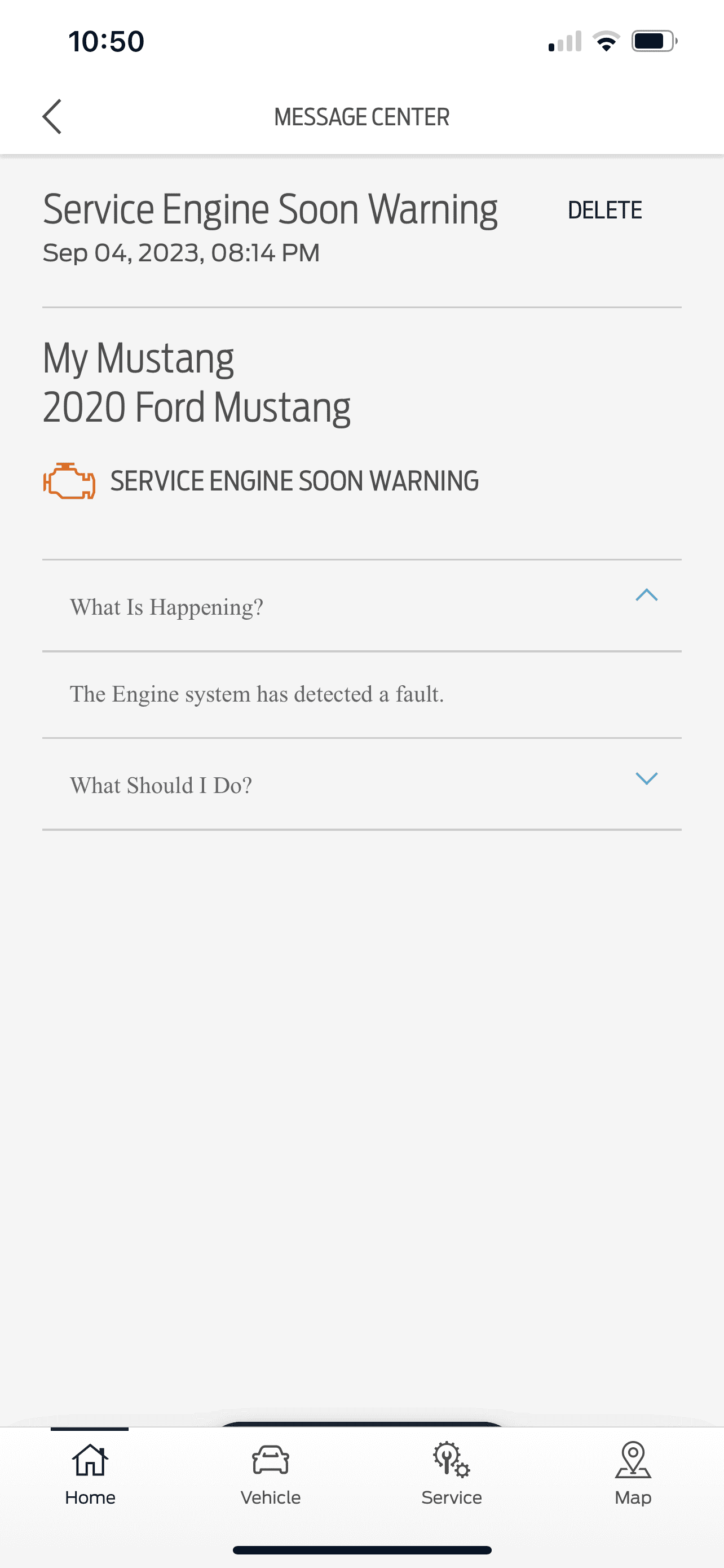

Attached files show the error messages that FordPass gave me. I checked fuses and plenty of wires and connections, they all seem to be good. I’ve drawn blank on what to do before I dumped tons of money into something that may not be the issue. I’m out of warranty, the car is modified.

If it's not the evap system all faults point to an electrical problem. My guess would be with the pump controller.

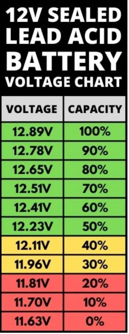

What is your definition of a healthy battery voltage?
FWI, a fully charged battery is the first step when diagnosing anything on a modern car.

Voltage read 12.2 when I checked the voltage.

12.2 volts may not be as healthy as you assume.
Charge it fully and possibly have it load tested before proceeding.
