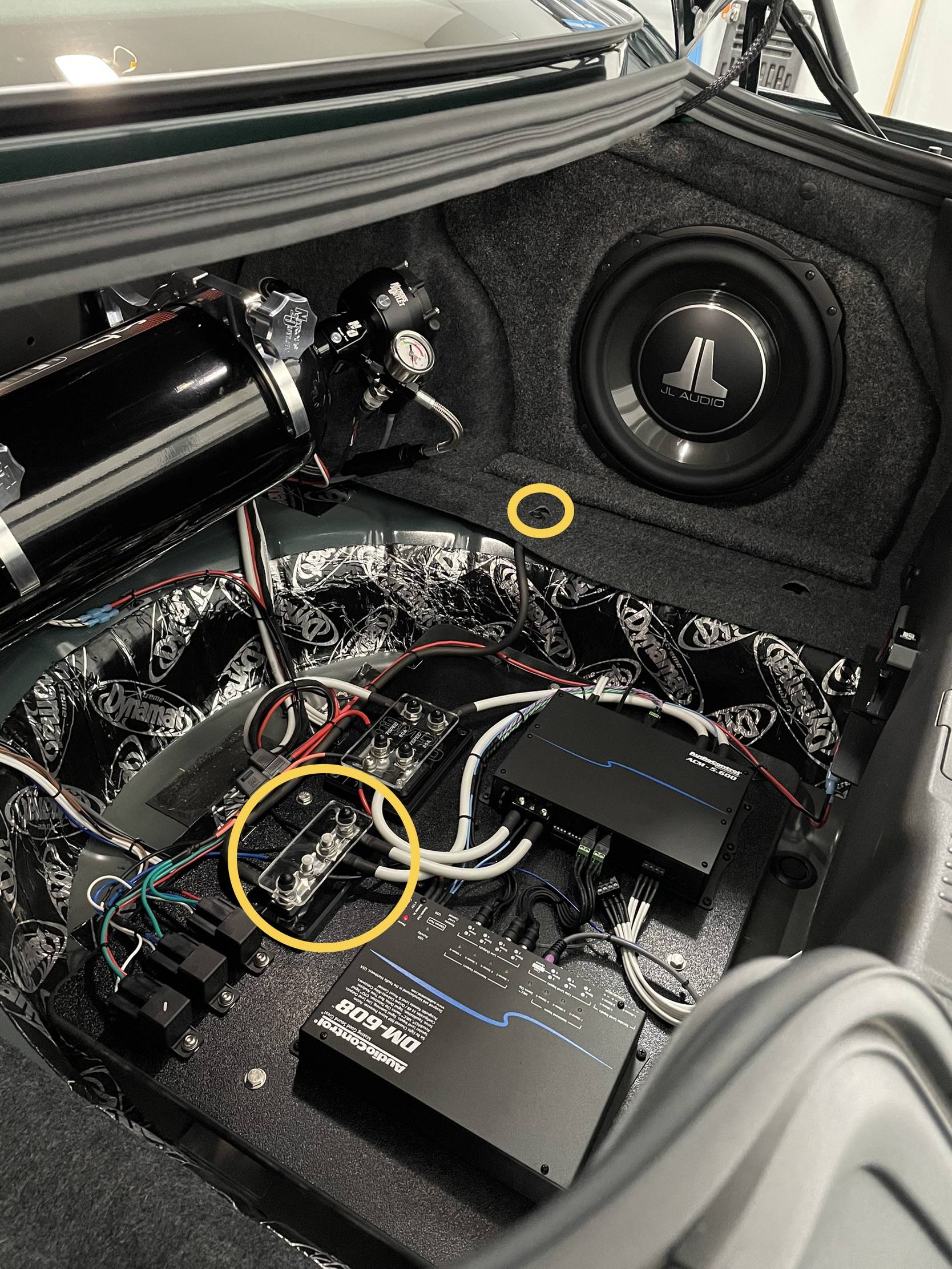

Are you set on mounting the amps underneath your seats? I had that done once before many years ago before I started doing my own installs and the amp would get extremely hot and clip often.
I recommend getting them out into the open if possible (maybe even in the spare tire well or on the rear seat backs) for good circulation. I mounted mine in the spare tire well and used one single ground wire running from a bolt that secured the factory B&O sub enclosure bracket, to an SMD ground distribution block which I used to ground both amps and a few other things. See pic (yellow circles are used to identify the ground point and distribution block).

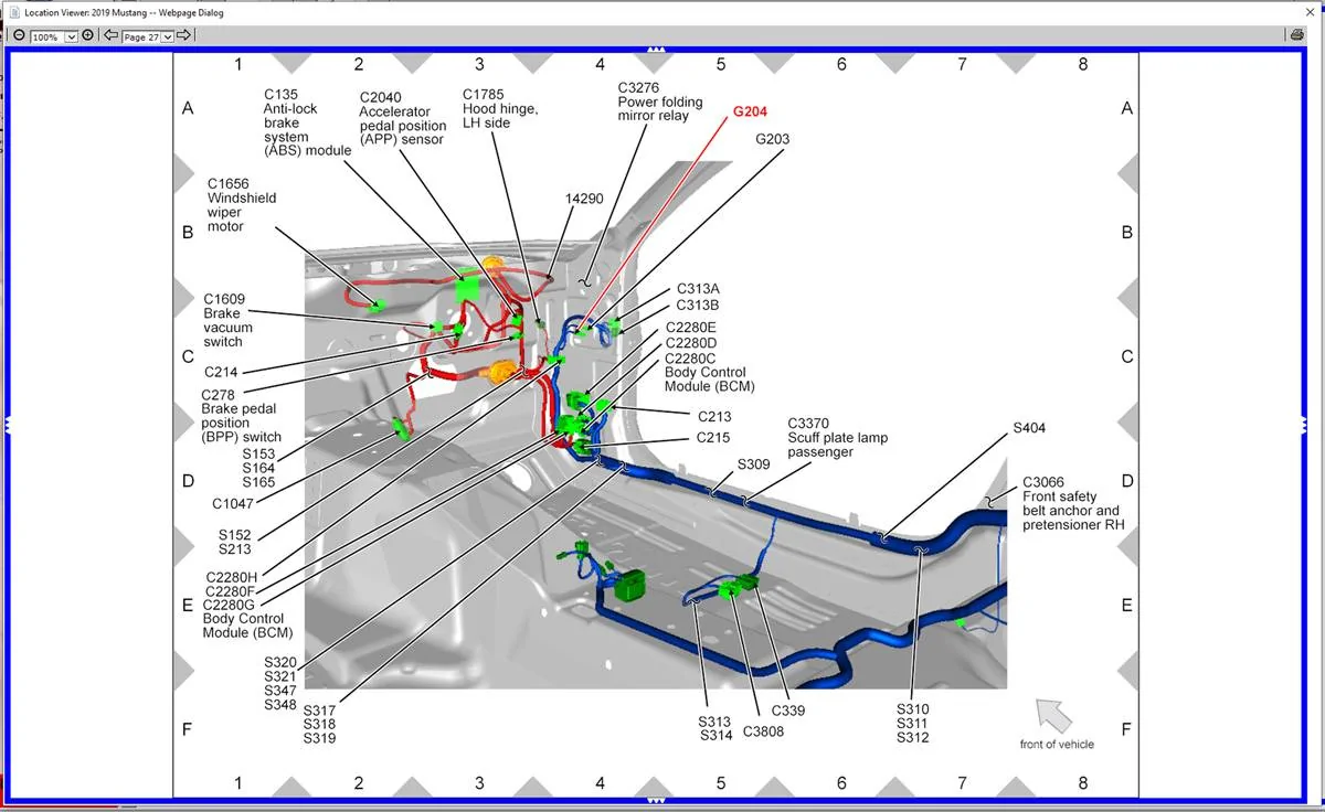

There are two nice grounds above the passenger footwell area.

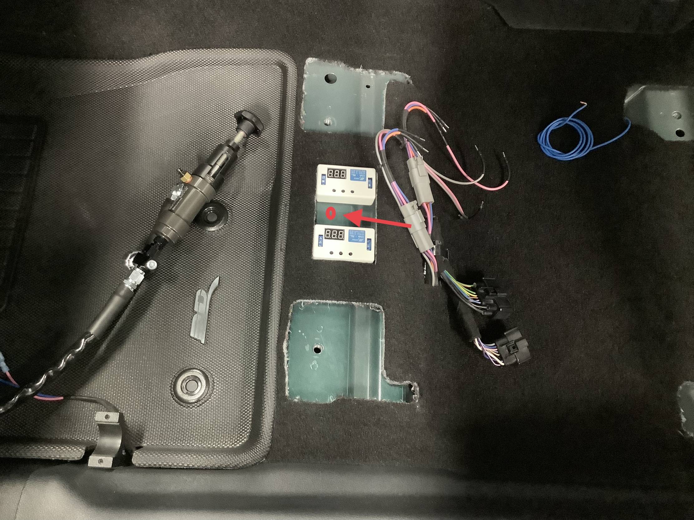

How about cut away the carpet like I did here to install my launch and shift timers, drill the appropriate size hole, install a nutsert and a flange bolt to attach your amp grounds under each seat? This will provide the shortest and cleanest run for your ground.
