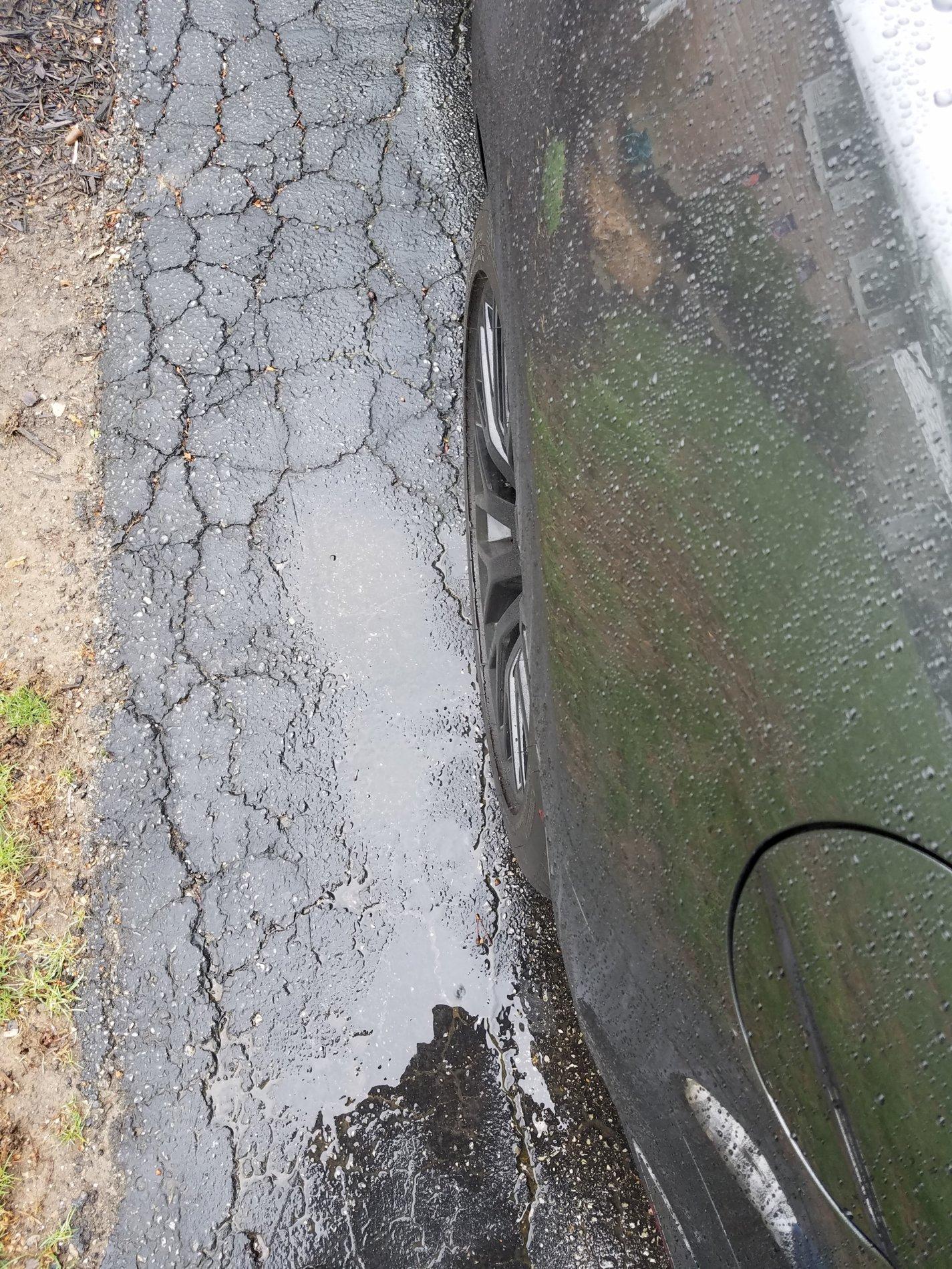

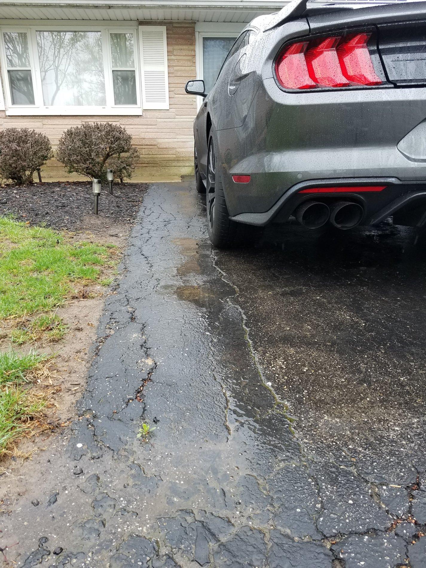

Had the Ford performance center at my dealership install the stop the hop ultimate kit. I noticed the other day it appears the rear tires toe out. Did they do it correctly or am I right and need to go get an alignment? Stearing wheel isn't perfectly straight with the tires either. To me it seems they half assed it.

The ultimate kit has the adjustable toe links, so it should have been aligned after install. Did you pay them for an alignment along with the parts install?

That looks bad. If you can visually notice the toe its really far out of spec. Good thing you noticed, that could be a real handful at the limit. That much toe out in the rear leads to quick spins.
Also you know how much you can trust that particular Ford service deptartment to look after you (you can’t). Find the local shops that the racers use if you can. They may cost a smidge more but they’ll get it right.
Get an alignment, and let us know what the toe was at.
Not sure. I told them what I wanted and they installed it. I assumed being a perfomance center and charging $700 for the install that it would have been included. I know it's supposed to be done.
That's what I thought. It doesn't spin worse than I would assume but it does seem to want to get a little sideways when taking turns quickly. Sad thing is this is a well know shop. One that is praised for their performance packages.
