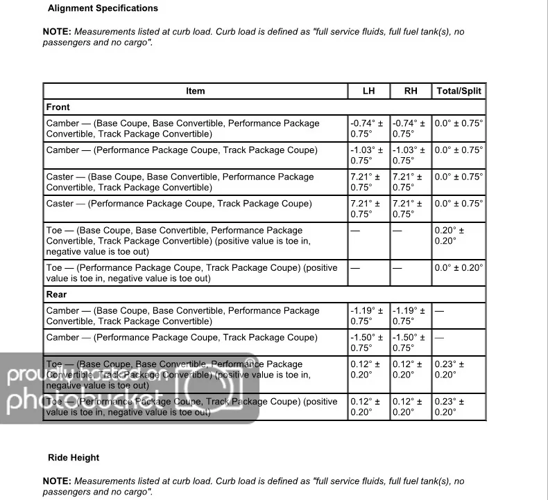

Greetings,
I looked in my 2022 Mustang Owners Manual for the alignment spec's for my GT base suspension, and performance pack suspension, and all they had were the alignment spec's for the Mach 1. I found this rather odd. I will be doing a suspension upgrade in the Spring, and it would be nice to have the alignment spec's on both Base and Performance Pack suspensions. Does anyone know where these can be found?
Thanks

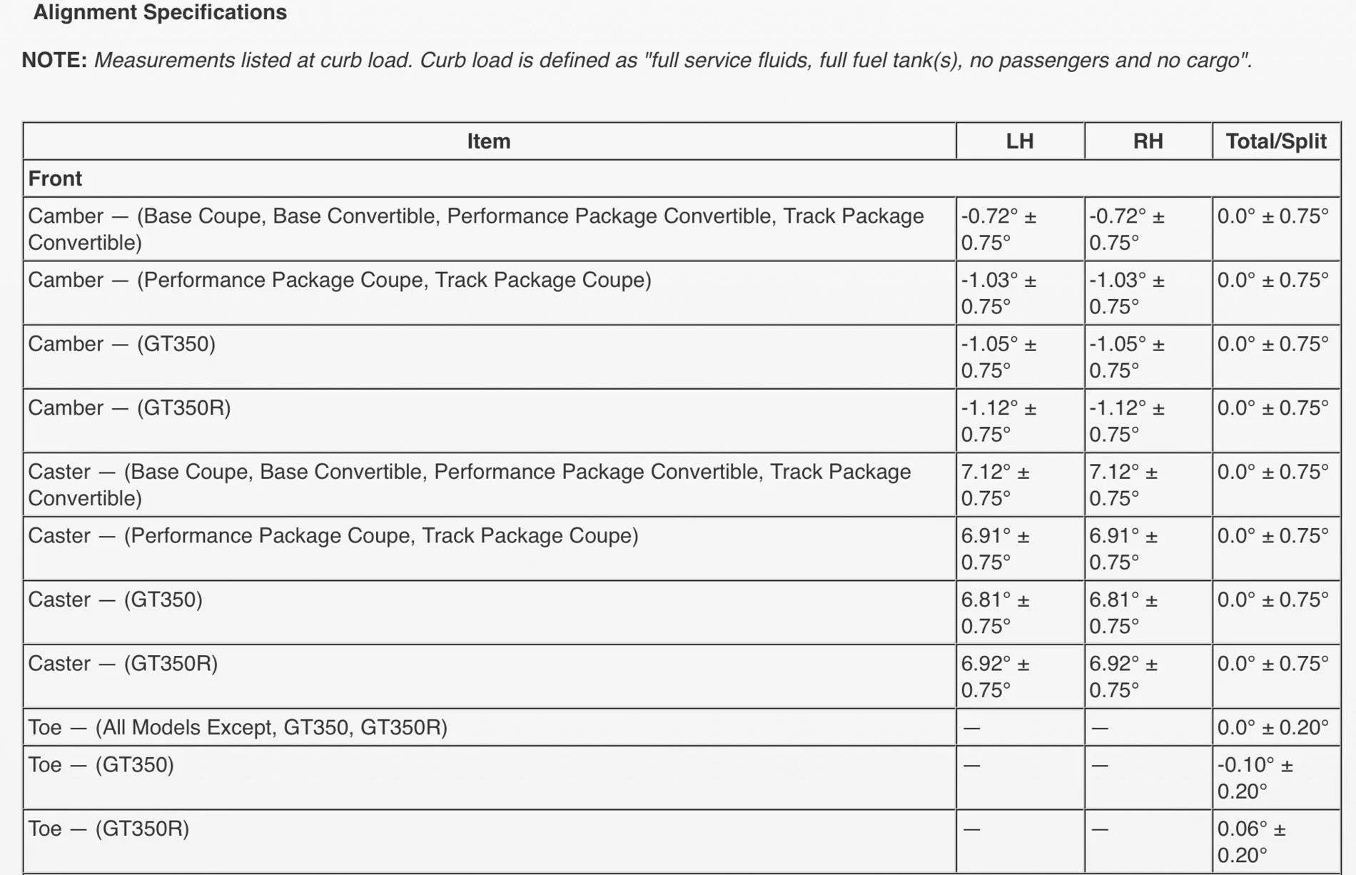

I'd be interested for others to recommend if you should run stock GT specs or PP1/2

Is there something regarding the cars dynamics that you're looking to change with a different alignment? All of the factory specs shown above are so similar, they're all going to drive about the same.

It's interesting how the camber and caster values are so exacting i.e. 7.12 degrees, 6.91 degrees but then +/-0.75 degrees 😂 What gives.

I am doing a complete suspension upgrade from my 2022 Mustang base suspension. The upgrade will be similar to the PP2 suspension, so I was hoping that Ford had some published calculations on the alignment on heir various type of Mustangs, Base, PP1, PP2, GT350 to reference.
