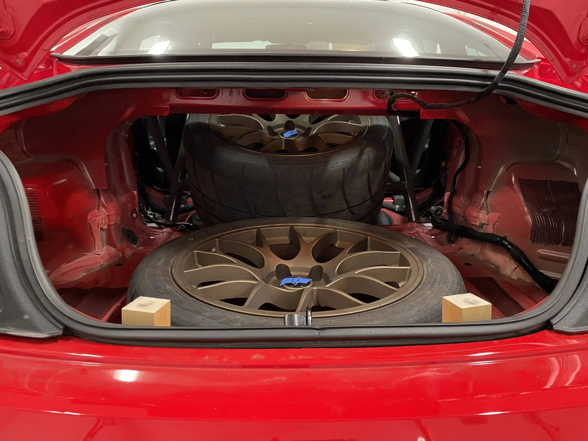

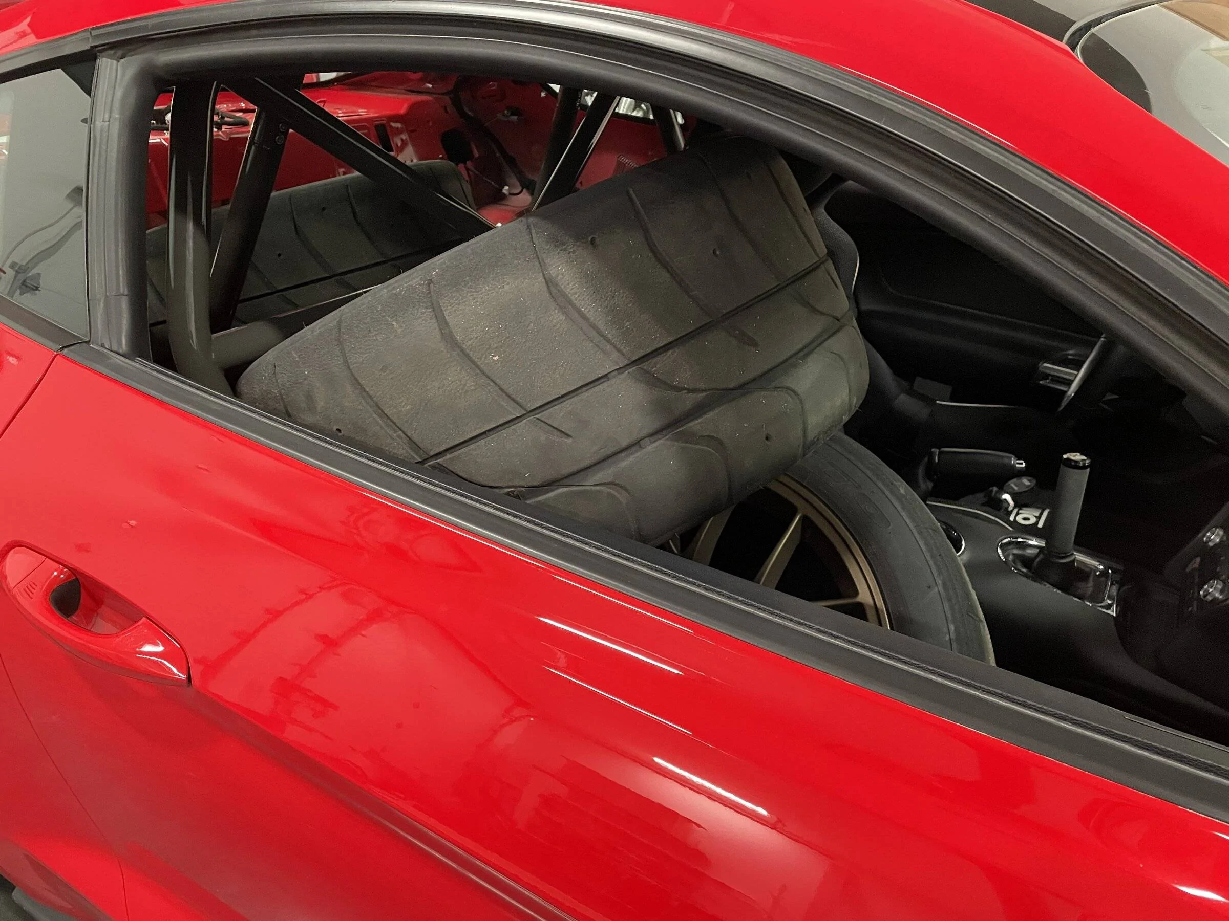

@Scootsmcgreggor @PaddyPrix there is a S197 guy on TMO who says he fits 4 wheels in the car with a roll bar and no passenger seat. Patrick, I think Frank has done this too. I haven't tried it yet myself but if I can fit 4 wheels, jack, stands, basic tools in the car with roll bar, then I will for sure get rid of the trailer hitch and save myself 36 lbs.
I think it'll be one in the trunk and maybe 3 in the passenger seat area...or possibly one between the down bars and then two in the passenger seat area.

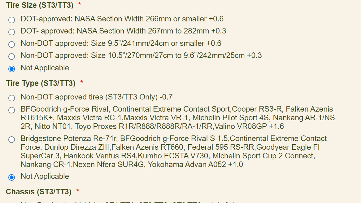

On the car class form for the TT3 cars if you use a tire from 267 to 282 section width you get a .3 HP to weight benefit on your power to weight ratio. That is why I can go so low on my weight at my current HP because I run a 275 tire. If I go wide and sticky I don't get the .3 benefit and my weight is pretty close to min at 3850ish.
Here is the part of the car class form I'm talking about.

For you Eric. The downbars on the Watson roll bar are a bit further back but hopefully this configuration could still work. God help you if you get hit on the street with the wheels up front but pretty sure the time on track is still the more dangerous part of the day.

Yeeeeess! Seriously wish I tried this before I bought a tire trailer but that's ok, learning experiences were had.
Sshhhh, we don't talk about that part 😅

You just have to be above the minimum power-to-weight ratio for the class. So TT3 is minimum 10:1 but there are modifiers. The big modifiers are weight and tires.
For example: tires may be +1.6, +1.0, +0, or -0.7 modifier. So if your car is exactly at 10:1 and you then choose a +1.0 tire, then your adjusted ratio is now 11:1. That means you can add more power or drop more weight to get you back down to 10:1

Not saying RTFM... buuuuut :D -- https://drivenasa.com/time-trial/
They have a real nice calculator that you use to start your form and declarations though -- https://form.jotform.com/drivenasa/st-tt-car-classification-form
So from there choose your intended class, and what options you are taking. The 1-2 is different than 3-4, and moreso than 5-6, not that we have a shot in hell of making it. In short, TT is the gateway to ST, and so we're using those rules for classing/mods/weight. So, TT3 is 10:1 power to weight, with each class being off by 2, to TT2 is 8:1, TT4 is 12:1, and so on.
If you're under weight, you're cheating, DQ! If you kick ass and take too many names, they can force you to dyno, or an angry competitor can just the same, and then who is in the wrong pays the dyno fee. If you're over, DQ! Definitely don't want a DQ, as it's 0 points, not dead last, and you cannot use one of your drops against it. Might as well carry just a few extra pounds or add a few extra HP just to allow for dyno variance, or best yet, get your dyno done at the track, so it's on their official dyno which may make or break you. For sure, definitely not the place that gives huge numbers to brag to your friends, because if they're overstated, you're lining up against a guy who is potentially understated, and 10-20rwhp might be enough if all other car and drivers are equal.
But in short, the smaller the number, the better, and you want to get as competitive as you can and just barely make the class limits, because just barely making one class above means you'll likely catch beatings from cars that just barely make theirs.
The baseline is a 3000# race weight (car + fluids + gas + you) as measured as you come off the track, if you're lighter (say, 2400), you get a mod penalty because you brake later and have less to stop and accelerate on what, and if you're heavier (3600), you get a bonus to run more power or better tires to start and stop that boat. More or less, our competition are usually 3000#ish Corvettes WITH SHITTY DRIVERS.
Everybody who races ST/TT has their forms up on the internet, so you can stalk your opponent and try to figure out what makes them tick == https://airtable.com/shrtuIZcugofvmCJZ
For example: tires may be +1.6, +1.0, +0, or -0.7 modifier. So if your car is exactly at 10:1 and you use a +1.0 tire, then your adjusted ratio is now 11:1. That means you can add more power or drop more weight to get you back down to 10:1
It actually goes the other way, which is hard, but 10:1, if you use a +1 tire, then you're technically 9:1 then, because the power is the denominator.
