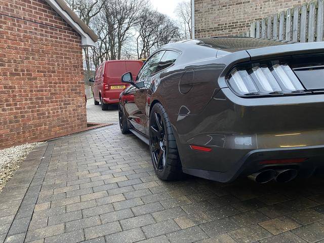

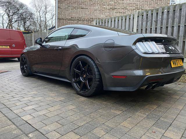

Like the side view picture, makes the car look smaller than usual.
I've got 19x11 rear wheels wearing 305s.
Didn't think I'd be able to squeeze 325s on.
Seating & clearances ok?
Sorry if I've missed it, but did the springs lower the car or was it just a change in rating? Furthermore, do you plan to do anything with/to the ARBs?
I've got some GT350R ARBs on order, but having issues sourcing some bushes.
Enjoying this thread, keep going!
the tyres clear fine. Need to get the car aligned though as I can see the camber at the rear is off from one side to the other.
the springs have dropped it 25mm at the front and 20 at the rear. Ride is nice and doesn’t feel any more harsh than the stock springs.
non plans to do The ARB yet but might do in the future.
Thanks, I wondered because there appears to be clearance above the rear tyre. So you didn't drop the rear as far as the front. I prefer the visual appearance this gives your car, as opposed to when the top of the rear tyre disappears up into the wheel arch.

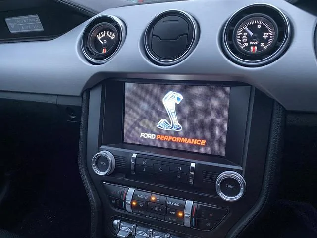

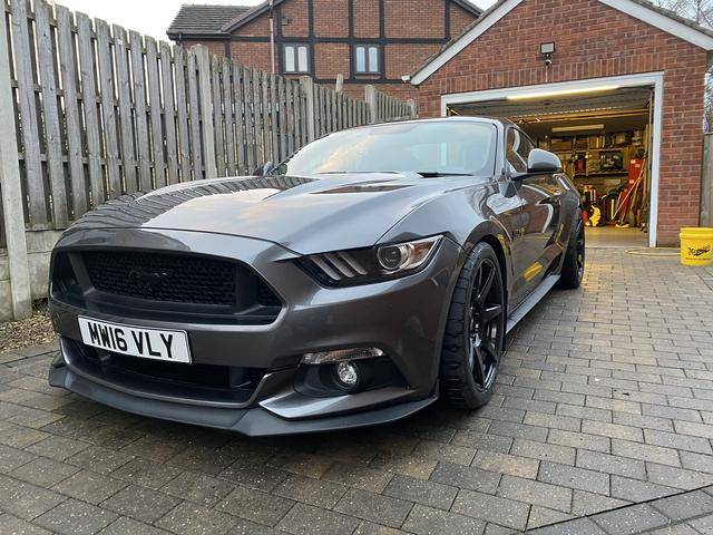

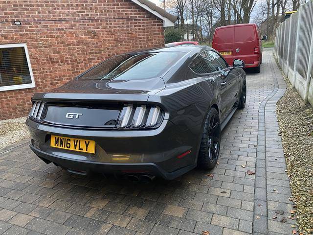

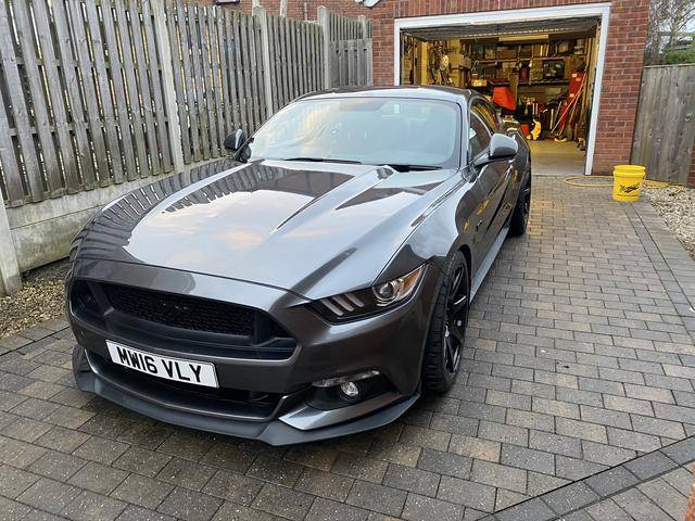

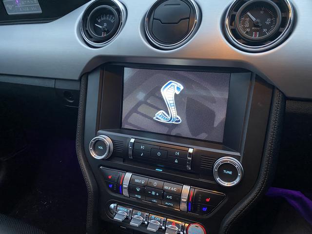

Not much of an update but the car is back on its wheels and driving. Exhaust is done and sounds great. Still quiet (ish) with the valves shut even on the motorway and not intrusive. Open the valves and shit the bed it makes some noise especially on wide open throttle. It does sound just fantastic though.
Still just doing some running around and rechecking as i have had so much of the car apart over December i want to be sure every thing is staying tight.
Also managed to update the sync3 to 3.4 with the help of @GR11M just so i could have the Ford performance splash screen. Its the small things that matter.
Also the Cooper Zeon RS3-S tyres I got from the states are proving to be good so far.
Just gave the car a quick wash after a 60 mile shake down.
Will be taking the car in for 4 wheel alignment in the next week or 2 and fitting the Mishimoto oil cooler if it ever arrives.

I like the sync 3 mod ... :sunglasses:
Please tell me more - when my 2020 arrives I assume it should have the latest software, how do I check ?
Can any image be used or are they pre loaded options only ?
And finally, do I need anything special (including IT skills lol) to change the images ?
Cheers,
WD :like:

Also intrigued to learn of a splash screen hack :bandit:

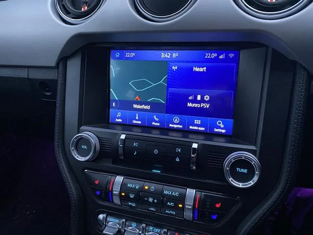

Your car sits very well on those wheels with the lowered springs!
I like the dark blue backround to the Sync display. I find the day colour on mine too bright & when I tried running with the black night mode it was less visible during the day.
So either I've missed changing the backround colour or it's a change that's come in with 3.4??

To change the splash screens you need Forscan and a ELM327 interface.
Forscan is free and the licence is free.
The interface can be bought from eBay/Amazon etc for about ÂŁ15/20
All the Sync 3 have different splash screens built into them but as far as im aware you need Forscan to change them.
Early sync 3 version below 3.0 i think have the Ford GT splash screen but from 3.0 on wards this was removed in the update.
The Ford Performance i have on mine is only in version 3.4 as far as im aware. It maybe in 3.3
Other screens from memory are:
Ford Logo
Lincoln Logo
Raptor
Mustang
GT350
GT350 R
Vignale
ST
RS
GT
plus some others.
You can change the theme just by going into the hidden settings. you press eject and FF/skip at the same time. Hold down until the speakers start to emit a high pitch tone. let it do its test or tap "End test" then it opens its hidden menu.
Click on "test settings" i think it is and there is an option for themes. Any thing you change you do at your own risk. Not sure if you can change splash screens from there but you may be able too.

This video shows you how to do the theme change. very easy to do.

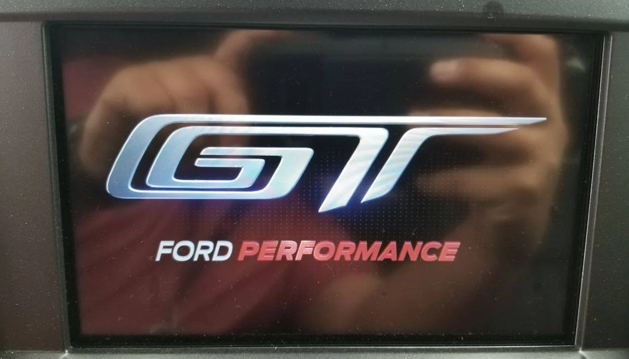

Thanks for the info...may have a go at this at some point. Loads of vids & guides online, seems pretty straightforward. Quick google search & I found the GT one, which seems quite fitting!
