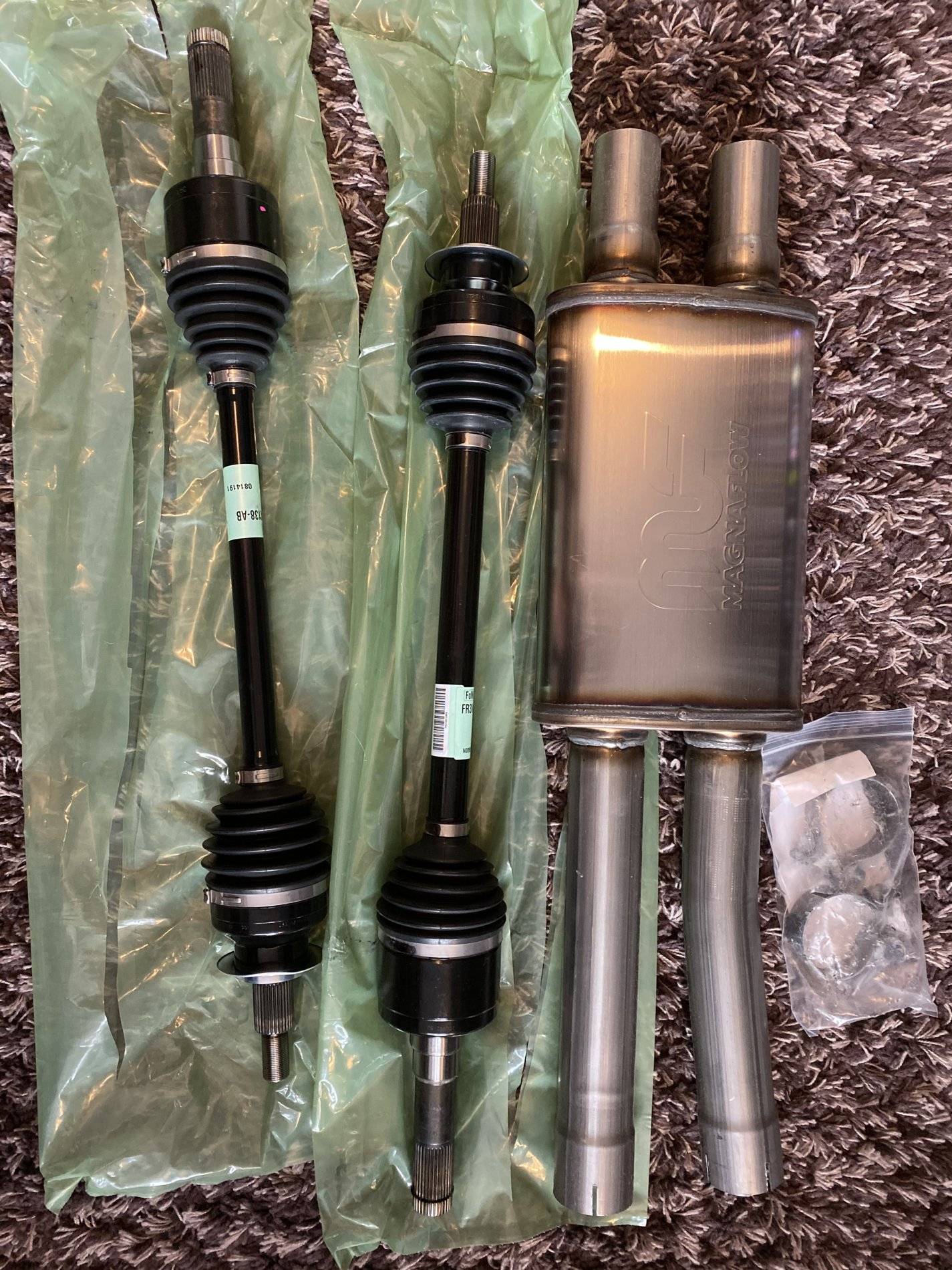

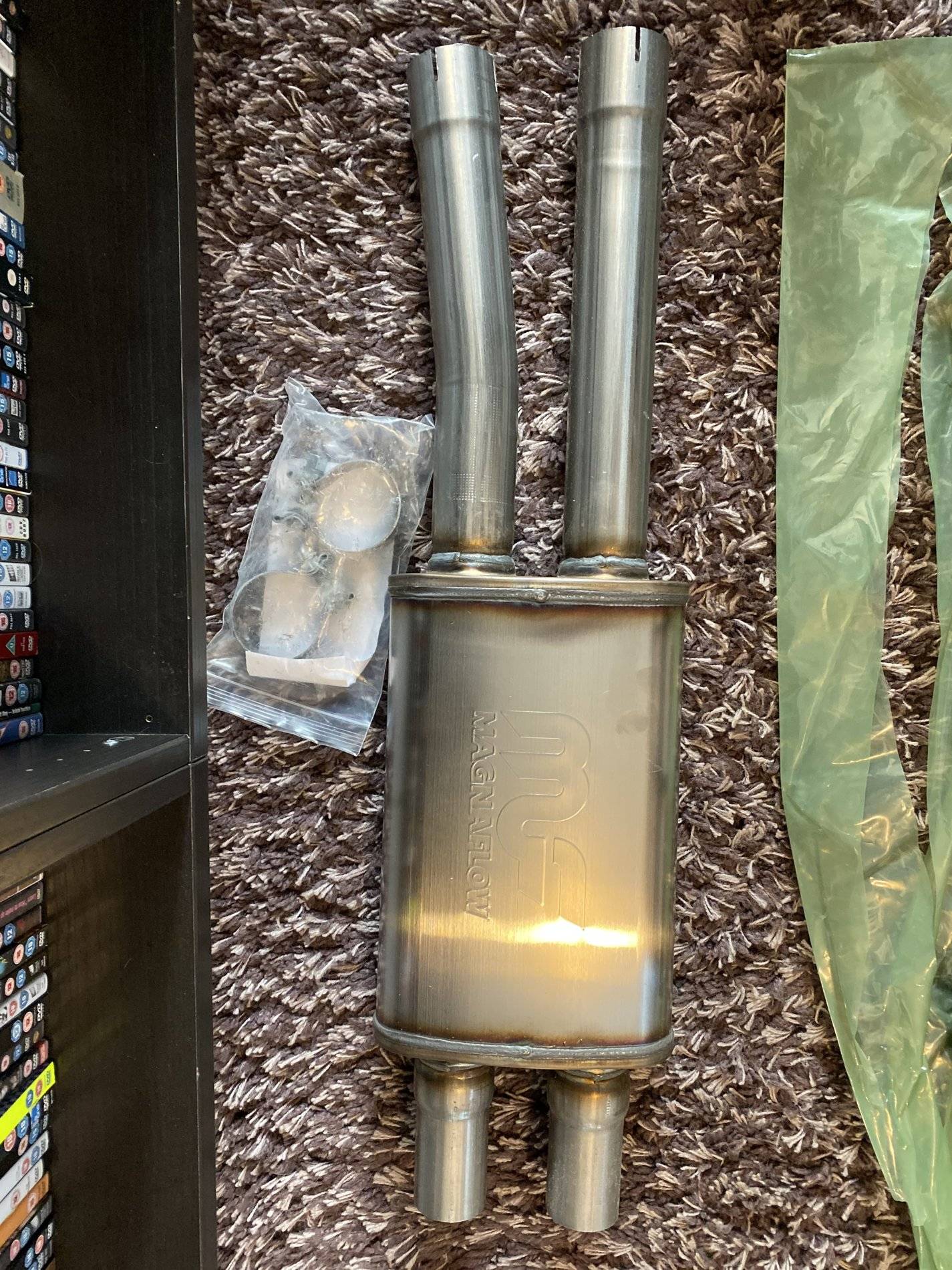

3. Have you removed the center resonator from the exhaust assembly...not only is it heavy, but it is also a fairly good choke point for the exhaust (recommend replace with X-pipe
Magnaflow Tru-X is arriving today. System will be long tubes to 3" cat then down to 2.5" mid-pipes, Tru-X (opened up to 2.5" inlet from 2.25") then exit via 18+ active axle backs.
Reason for dropping to 2.5" is to keep noise down. Should still get a good power increase.

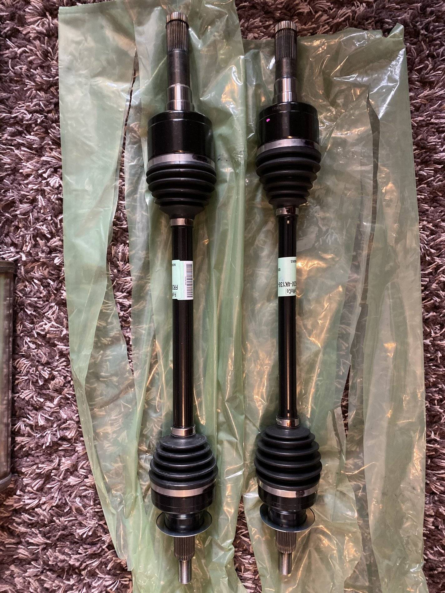

Magnaflow tru-x arrived along with gt350 half shafts.
just need a couple of days to get it all fitted now.
