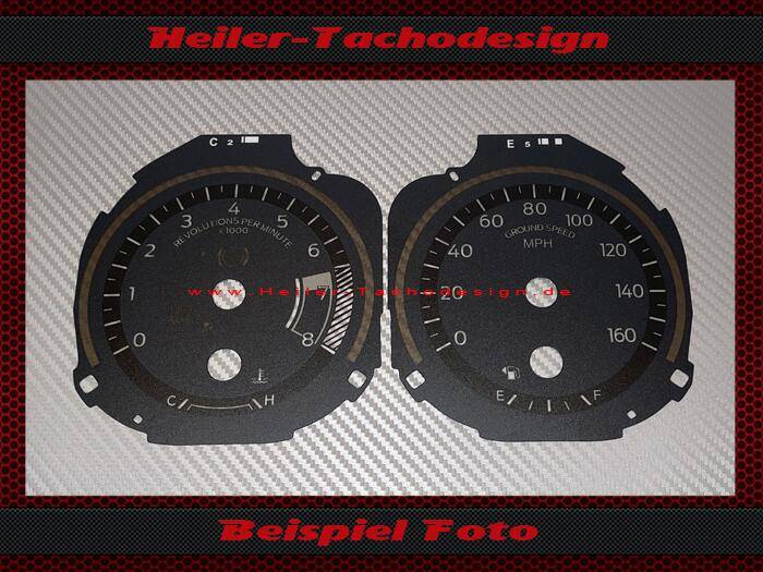

This is what I am after - I see it on ebay and some other sites. Just wondering how easy it is to get to the tachometer gauges.

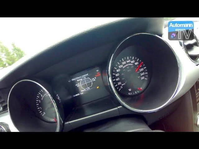

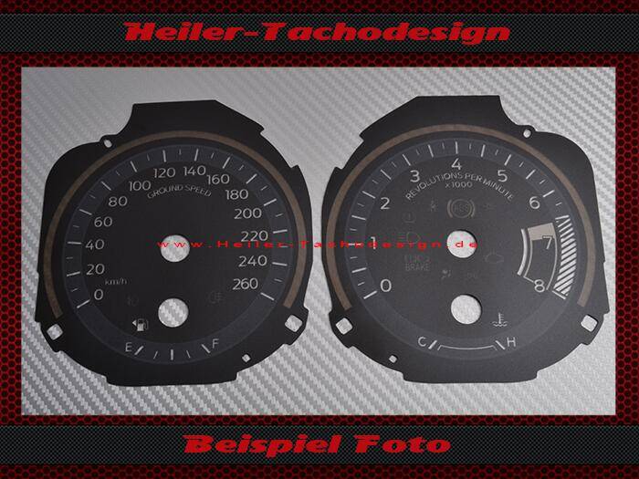

My Current Guage is Canadien so Kph on the outside and mph on the inside very small. So that says to me the backing can just be swapped out. ?
So I have the opposite of the UK dials but the innner numbers are grey on black so not each so read and much much smaller.

problem is your odometer will read in kph and any speed related actions taking the speed input might also be kph for example cruise control / ABS / power steering. I think in another thread some folks gave you pointers for garages / specialists near where you will be in the UK so i'd be speaking to them so as to find out how you can change it. Potentially you'll need a complete clock change so as all speed signals are in the displayed unit.
You could of course just remember 100kph is 62mph and work from there with your current display.
