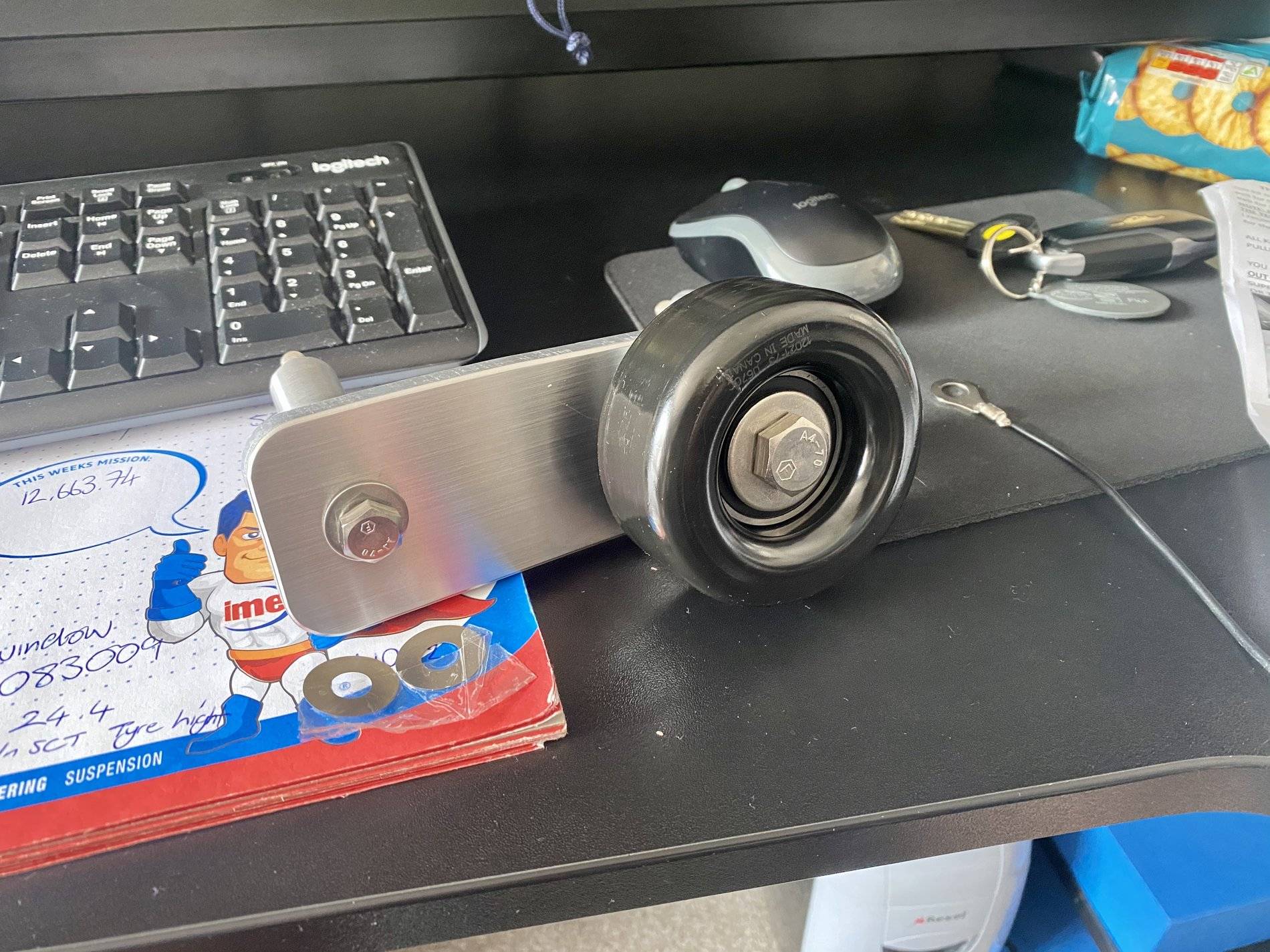

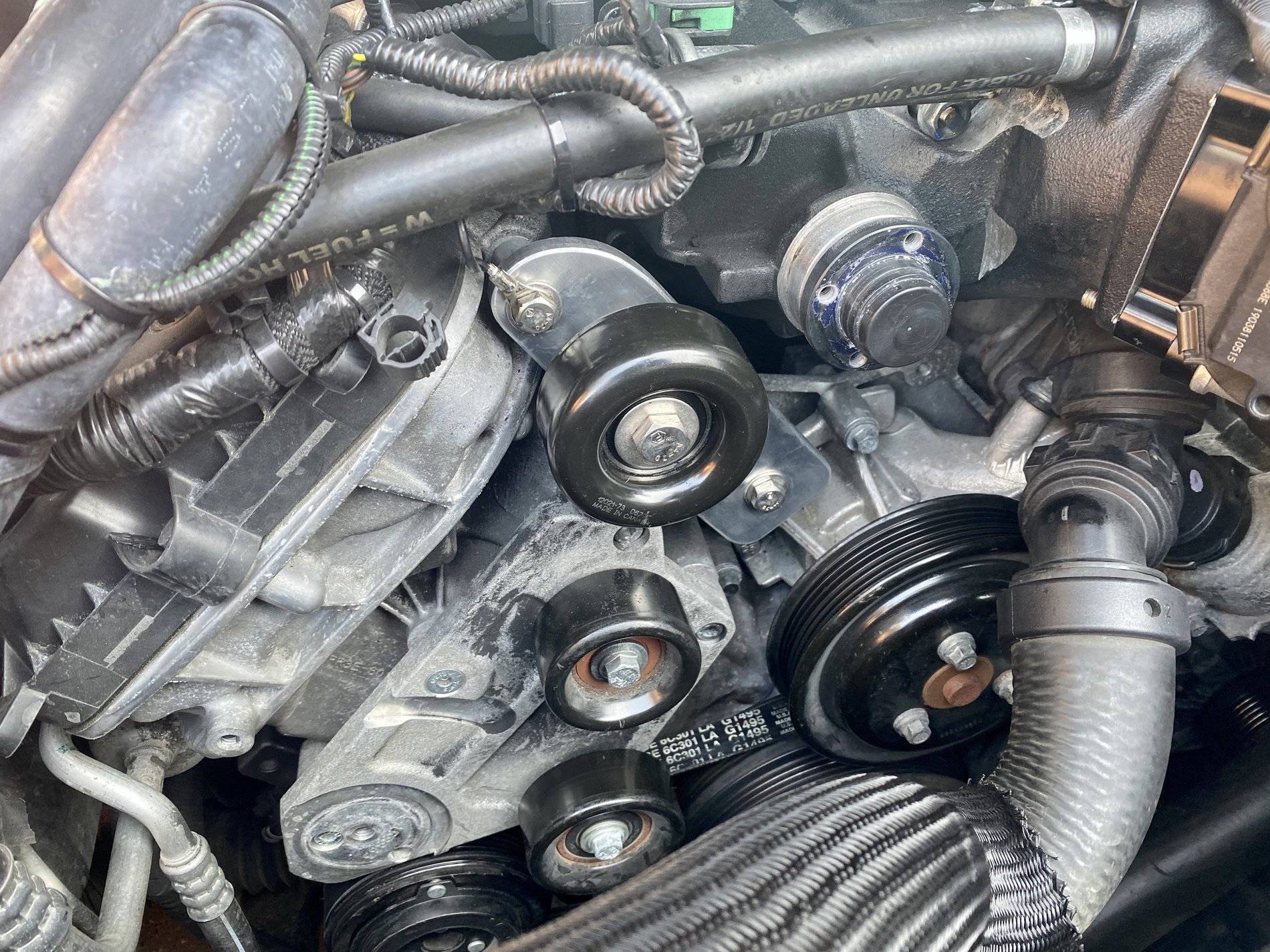

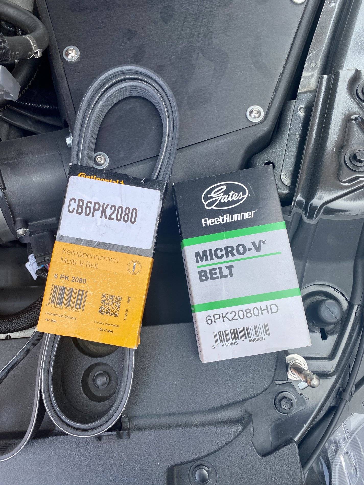

Package arrived today from Tulsa after a long long wait due to USPS.

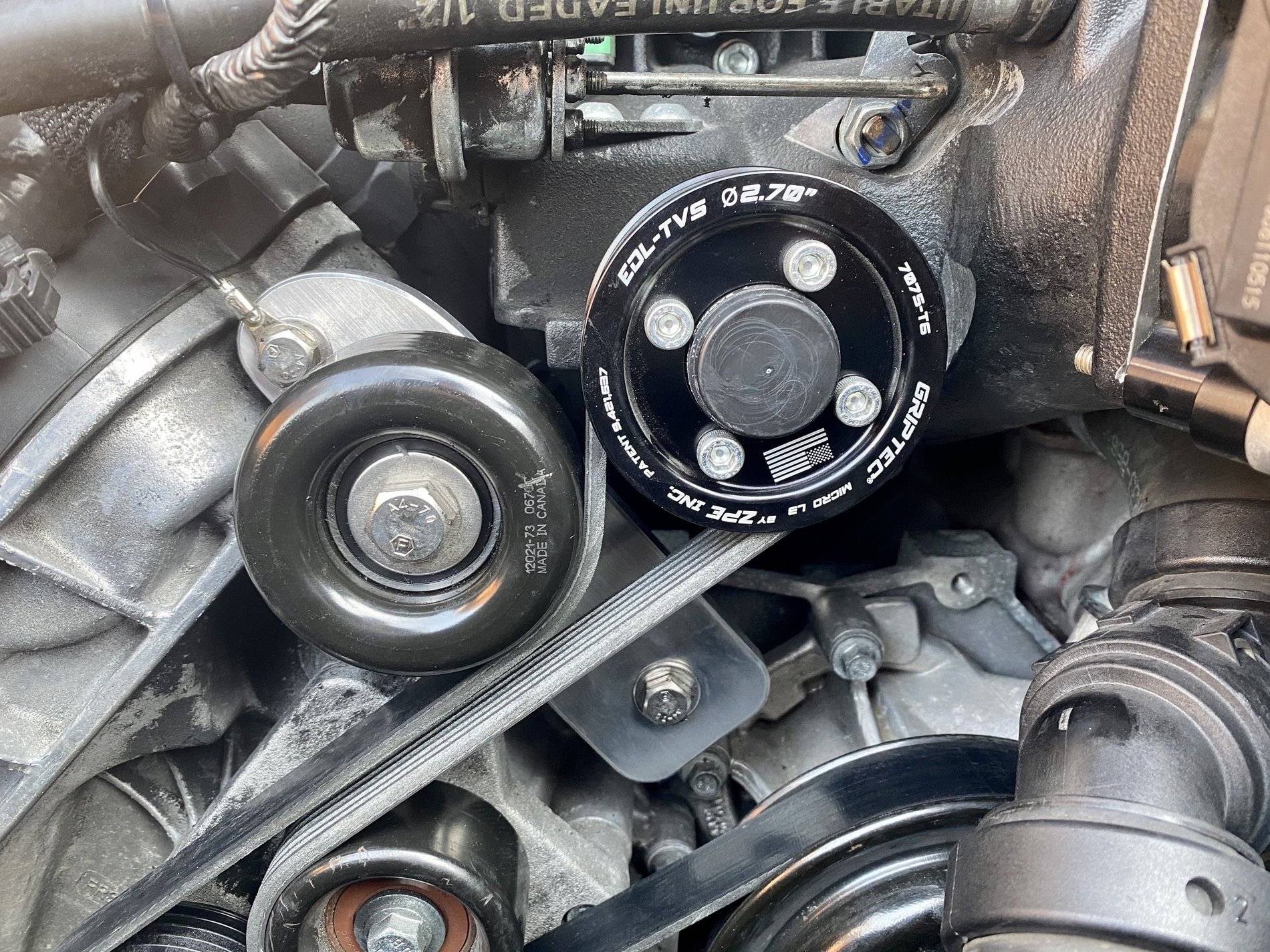

This is a kit made by Seth White on the Edelbrock Facebook page. It’s an extra pulley and gives more belt wrap on the blower pulley. Hopefully stop the belt slip I got on the last speed run that cost me a belt.

That pulley is fully covered now!

Is that an earthing lead with the new pulley?
I assume the supplier calculates the required belt length when the pulley is ordered?
Also, is that your smallest pulley?

@CraigJ
yes the pulley comes with an extension to the earth as it needs to be relocated.

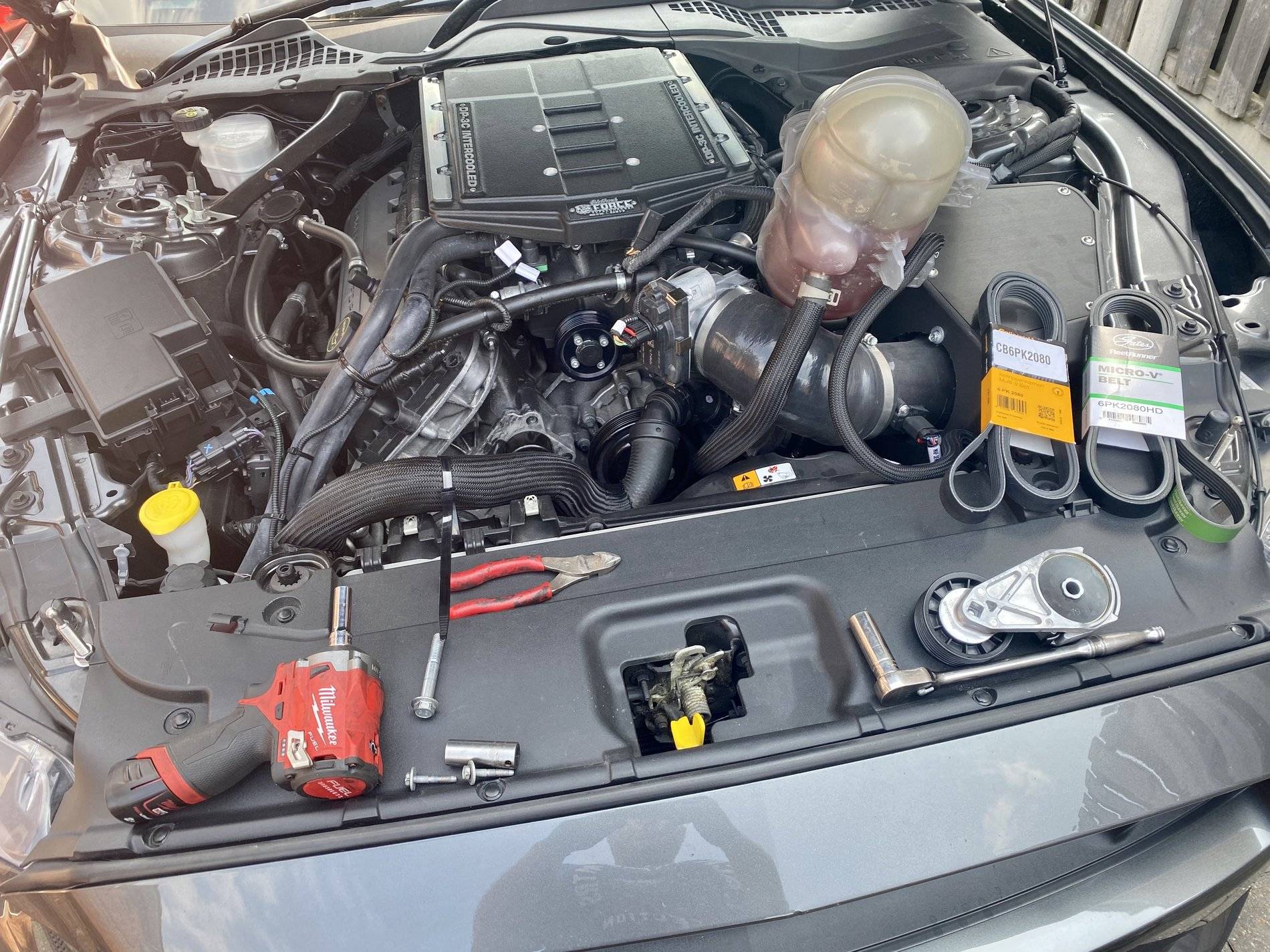

The belt(s) the supplier suggested were wrong, way too tight.

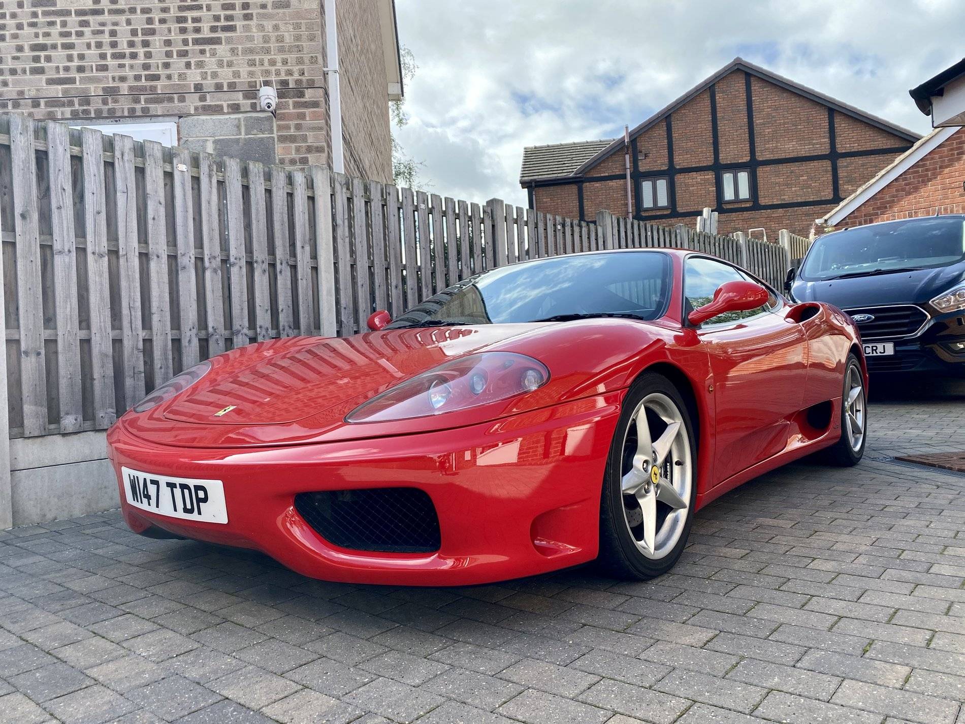

Small update, the Mustang has sold.
It went last Thursday to its new owner who is going to be cutting up.
The day after I bought this...
