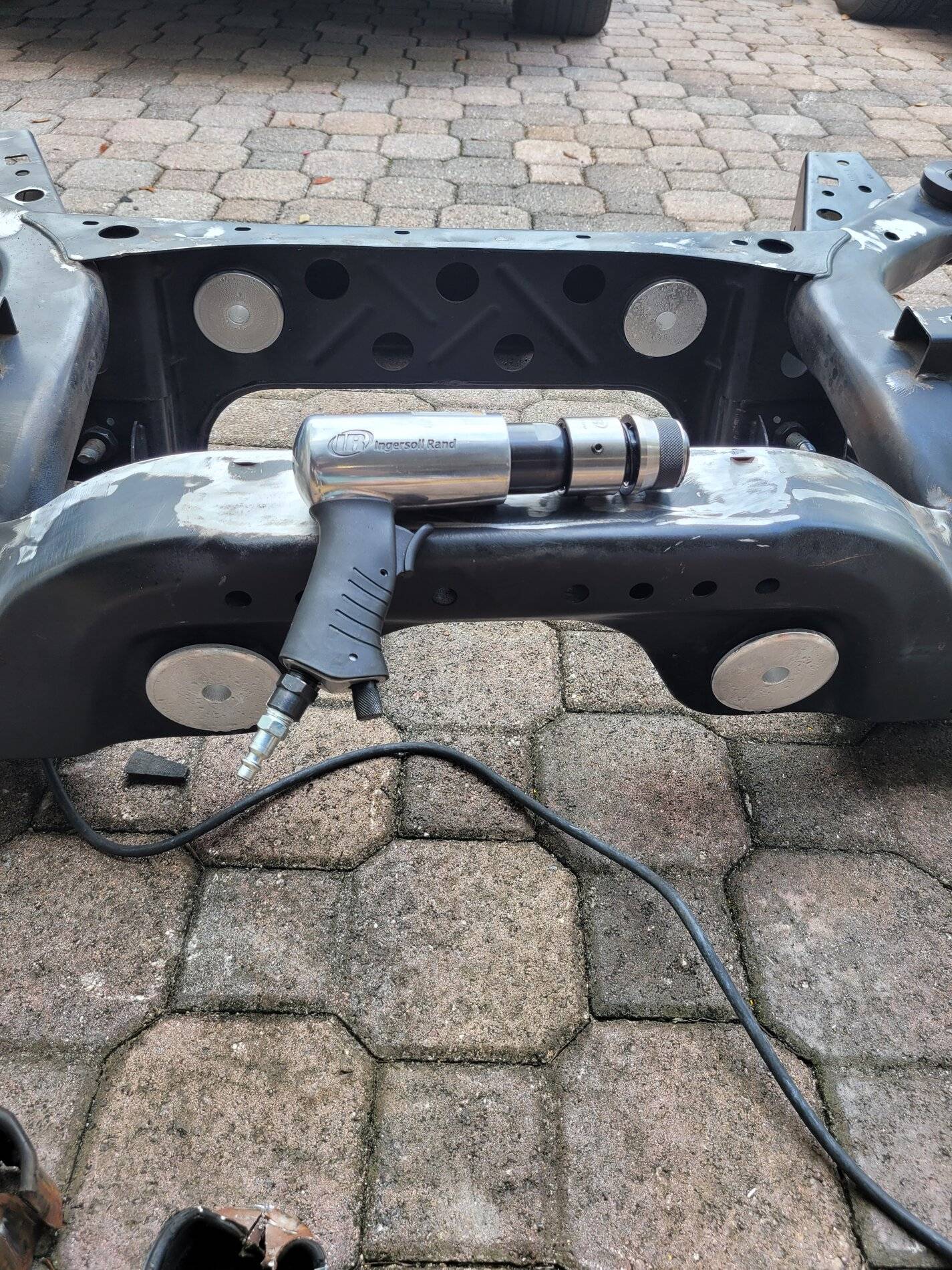

So... I dropped the subframe today. What a piece of cake that was! I already had the diff out so 4 bolts. Now, like you said I cut the rubber bushings out and I'm left with just the collar inside the subframe. I've got all kinds of tools but no air chisel. Anybody have any other ideas? Torch, ball joint press? I was even thinking of laying a bottle jack between the bushings and using it as a press to pop them out. Thoughts?
sawzall but carefully. Cold chisel. The camaro guys use a torch and heat the sucker till it's smoking since their's are glued in as well.
I used my sawzall and cut a bunch of slices in those collars, it’s worth taking your time so you don’t cut the subframe it self.

Mission accomplished
Amazon Primed an air chisel and they came out. Thanks again man for the help.

Are you doing the subframe to body bushings as well??
I did and have since went another route to reduce the whice; but not sure you meant to ask me.
And looking in the upper corner of the Pic looks like he did.
