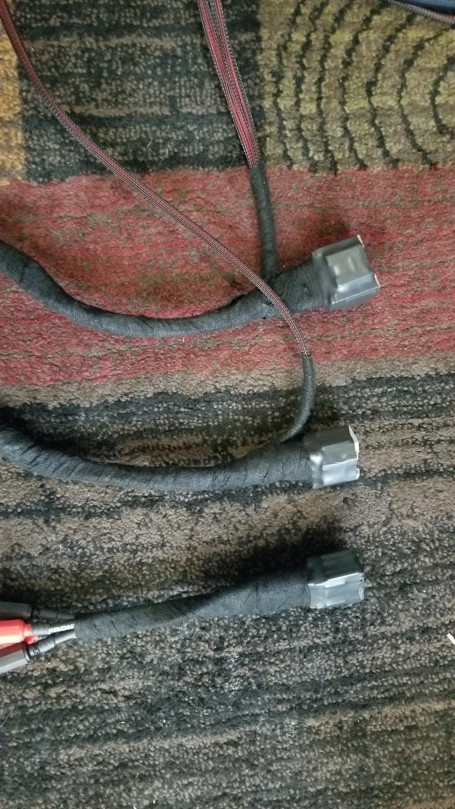

Soldered all the wires. Heat shrink, Tesa taped, Tech shielded. Pics tomorrow.
z06psi
z06psi
May 15, 2015
72
4,157
1,396
Evans, GA.
Andrew
The pot stirrer
Cable #1 and the two wires are for the tweeters.
Cable #2 and the one wire is for the center channel

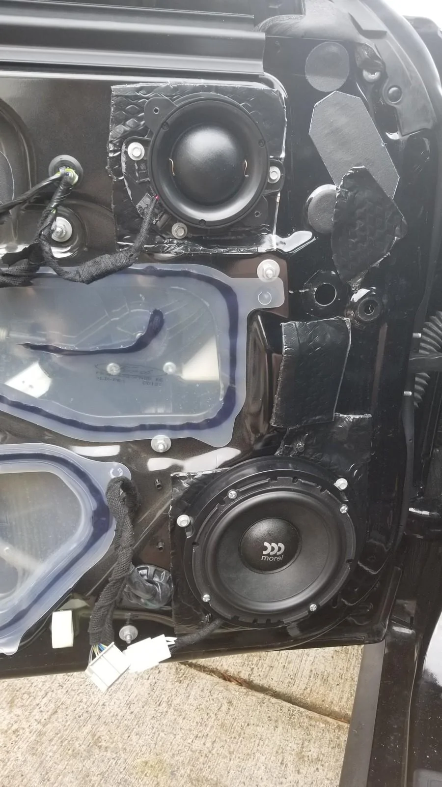

Did the front stage today. The Morel's were pretty much a direct fit. There were a few small things that I had to deal with.
The 3" door speakers used the OEM rings. Just had to airsaw the connector off and drill three 5/64ths holes to mount the speakers to them. The 6.5s went in with zero mods with the rings that Crutchfield sent. Just had to cut some tabs off on the inside of the rings. The tweeters are surface mounted but I will change them to flush mount. I used the factory capacitor to be used as a bass blocker until I go full active with the DSP.
All and all everything went smoothly. Sound deadened the inside carcass of the door as much as I could as well as the door panel side. So right now I am running the entire Morel component set and the Infinity Perfect 300 in the dash on the factory amp/dsp.

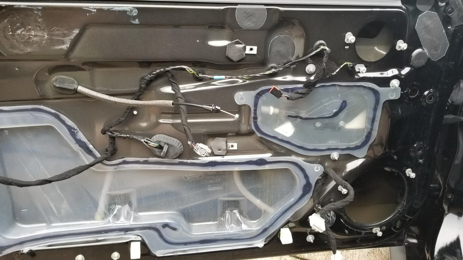

What I started with.
Just missing the foam surround rings. They are in there now.

Great work as usual! Before you button everything back up, make sure you can roll your windows all the way down and aren't hitting speaker magnets...
z06psi
z06psi
May 15, 2015
72
4,157
1,396
Evans, GA.
Andrew
The pot stirrer
The Morels are actually smaller than the factory ones.
