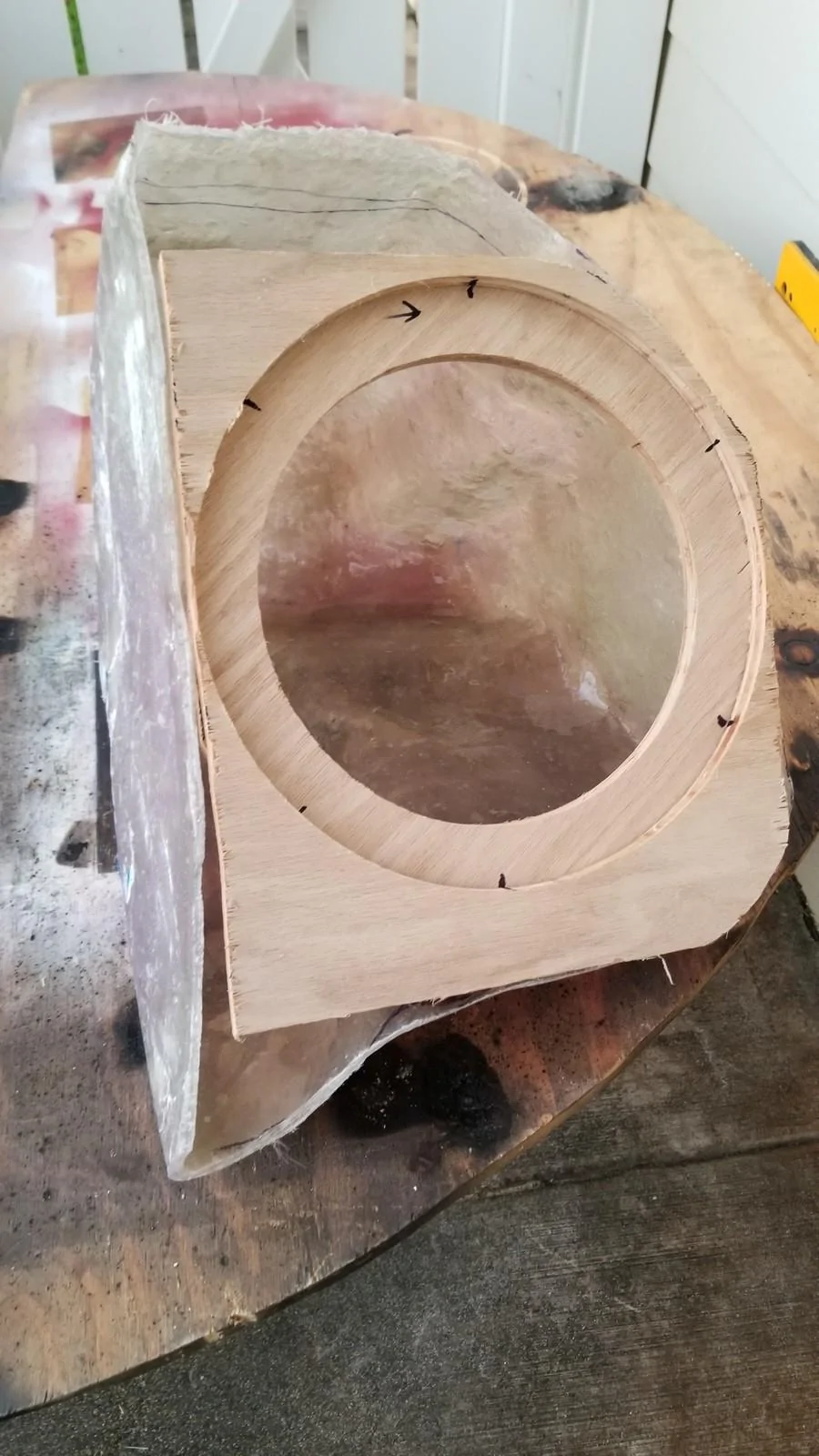

A little progress tonight. I trimmed the fiberglass enclosure and fitted the ring and the trim ring. Should be ready for front fiberglass tomorrow night. I mechanical and chemically mounted the rings into the enclosure. I will follow up with some supports tomorrow night to the back of the enclosure tomorrow before fiberglass.

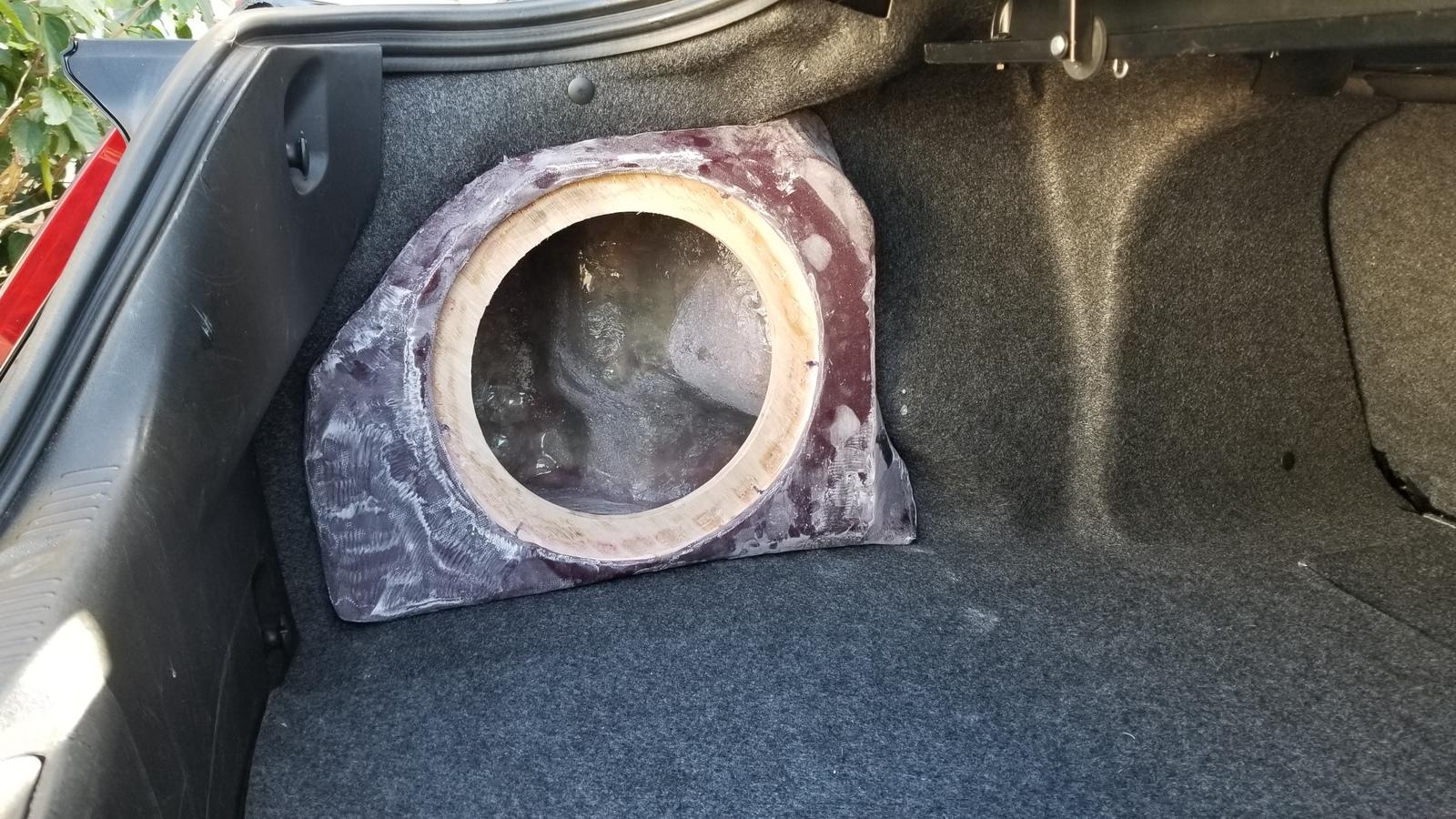

Mission accomplished. Fits like a glove. I have some finish work and a little epoxying to do. Throw some carpet on it, drill the rivet nut holes, wire hole, and put the speaker in.

Awesome man, looks like it fits great.

One down. One to go. Obviously you won't see the wire as it will run up to the amp behind the factory interior.

That looks amazing! Wish I could hear it in person.

+1 that looks awesome.

Truly impressed by your work... kind of makes me want to get rid of my IB setup.

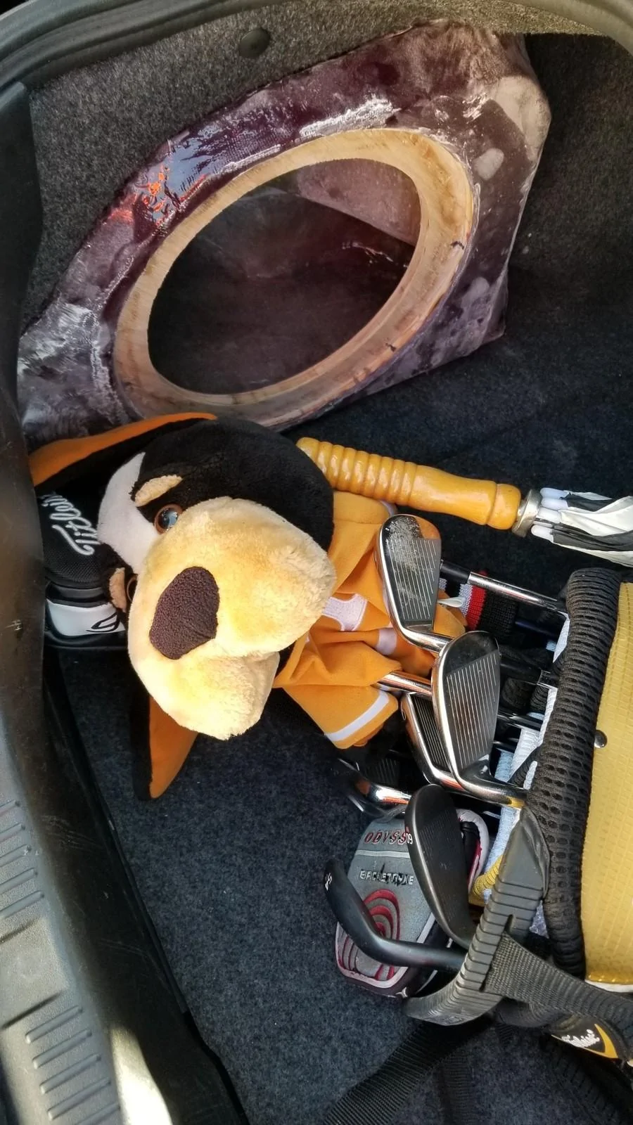

Started in on the passenger side. Got the mold done and all the fiberglass laid. Just got to build the front and mount it all up.
Next up will be the Sync 3 conversion, wiring, and then the door panels/a-pillars.
Then I have to rip it all out before the car ships. Lol
