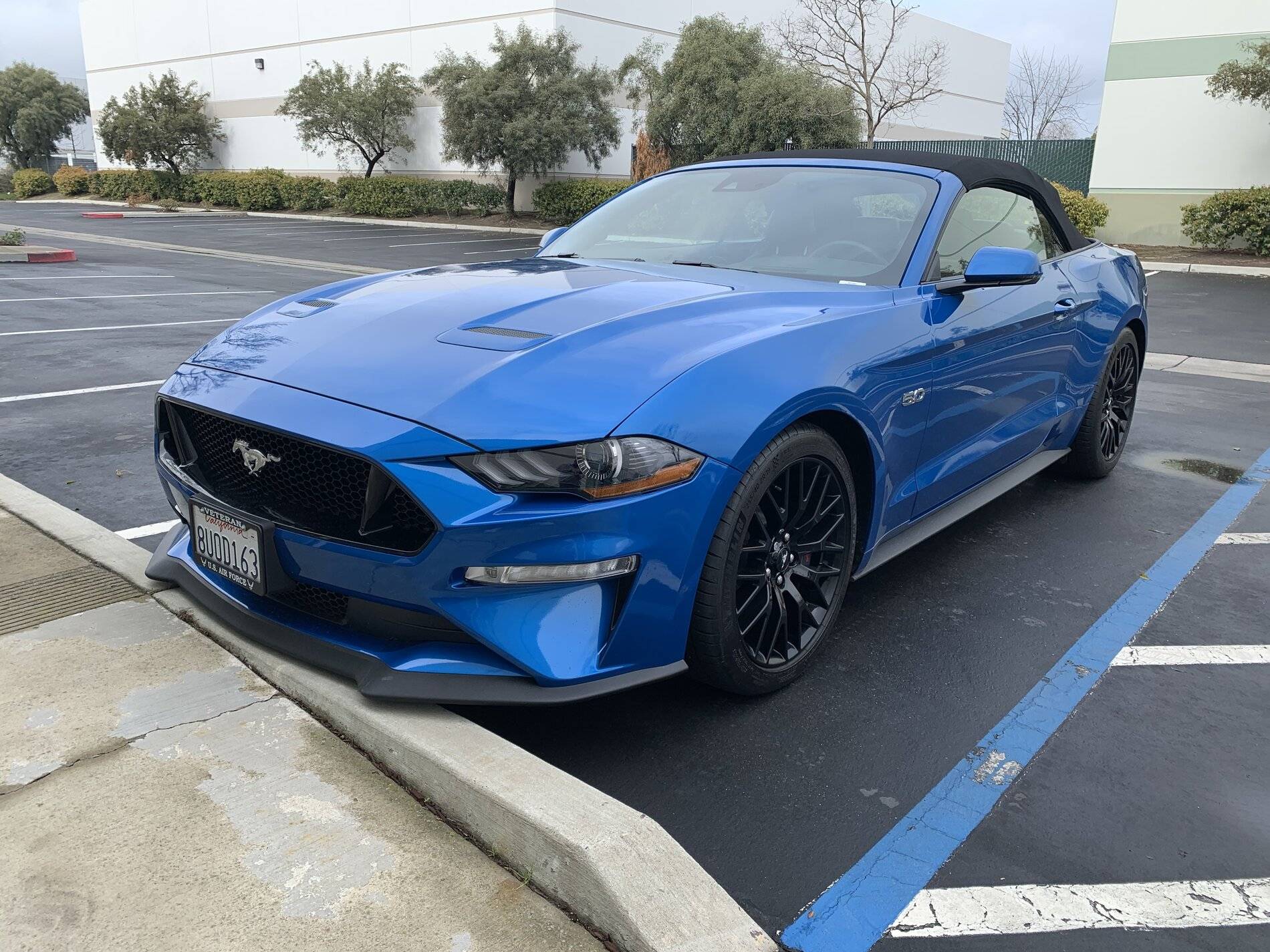

This is my current wheel. How can I figure out the offset? Nothing in manual and searching fords part site gives me conflicting info. It’s a 2020 GT w PP1. Would offset be different for front and back? I think I want to stick w wheels that have are the same size and offset as I have now.

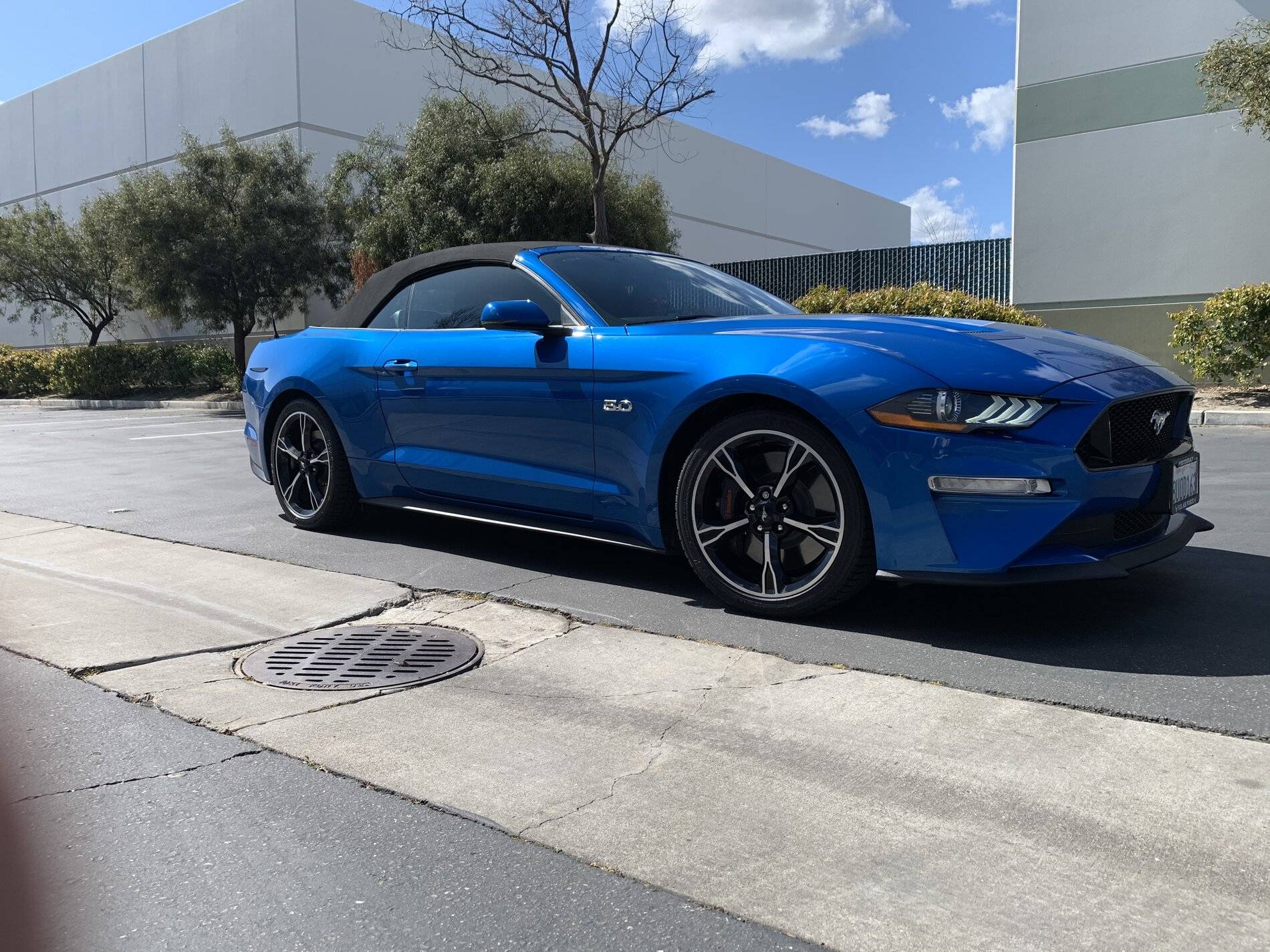

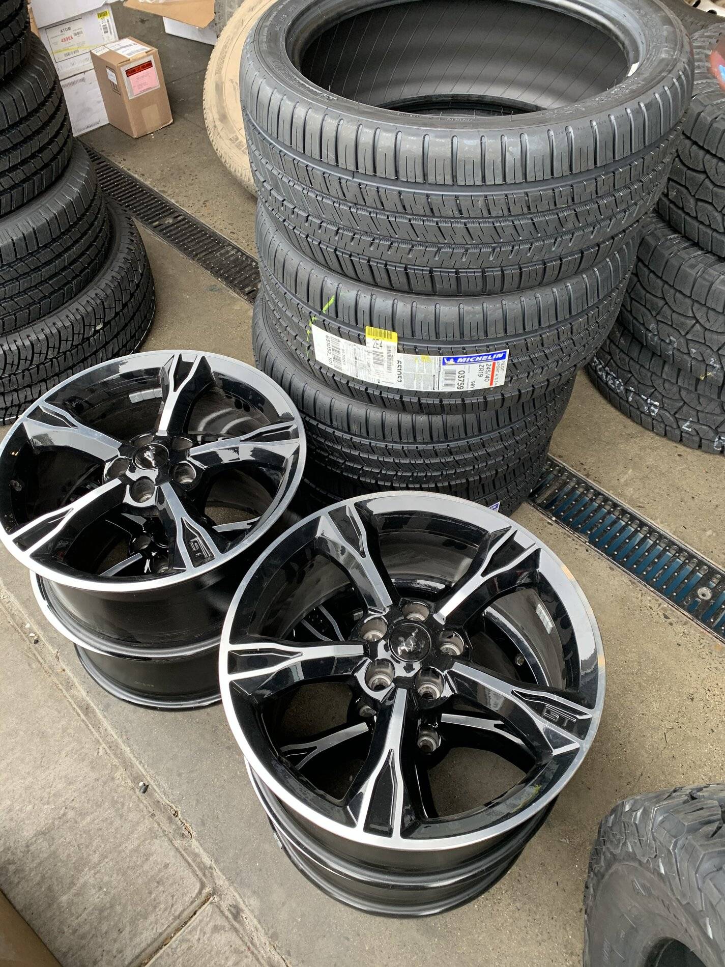

So I need a set of winter tires for my 2020 GT PP1. I am looking at a set of OEM California specials taken from a 2017 GT. Although they are 19” as well, the rim widths and offsets are smaller. Looking on https://www.wheel-size.com/size/ford/mustang the stock options are
2017 GT California Special
4x 255/40ZR19 96W 8.5Jx19 ET42.5
2020 GT PP1 front
Front 255/40ZR19 96W 9Jx19 ET45
Rear 275/40ZR19 98W 9.5Jx19 ET52.5
So I checked out www.tire size.com to compare the overall sizes and offsets and the 2017’s are just a tad smaller than the 2020’s which is great as the purpose of these tires are for rain/snow cold weather driving. (Wider tires = easier hydro planing + slippery in snow)
I am opting for a slightly lower profile 245/40R19 in the Michelin Pilot Sport A/S 3+ due to availability.
my research was aimed at keeping the car close to stock and Hopefully once everything is mounted I won’t have any issues with rubbing nor protruding outside of the fender wells.
All comments and recommendations are appreciated.

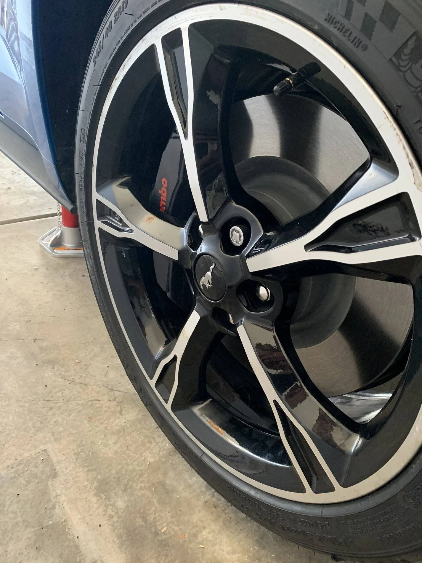

This is the end result, definitely a little smaller, as the fender is now more prominent. No rubbing, the tire weights clear the PP1 brembo brakes.
