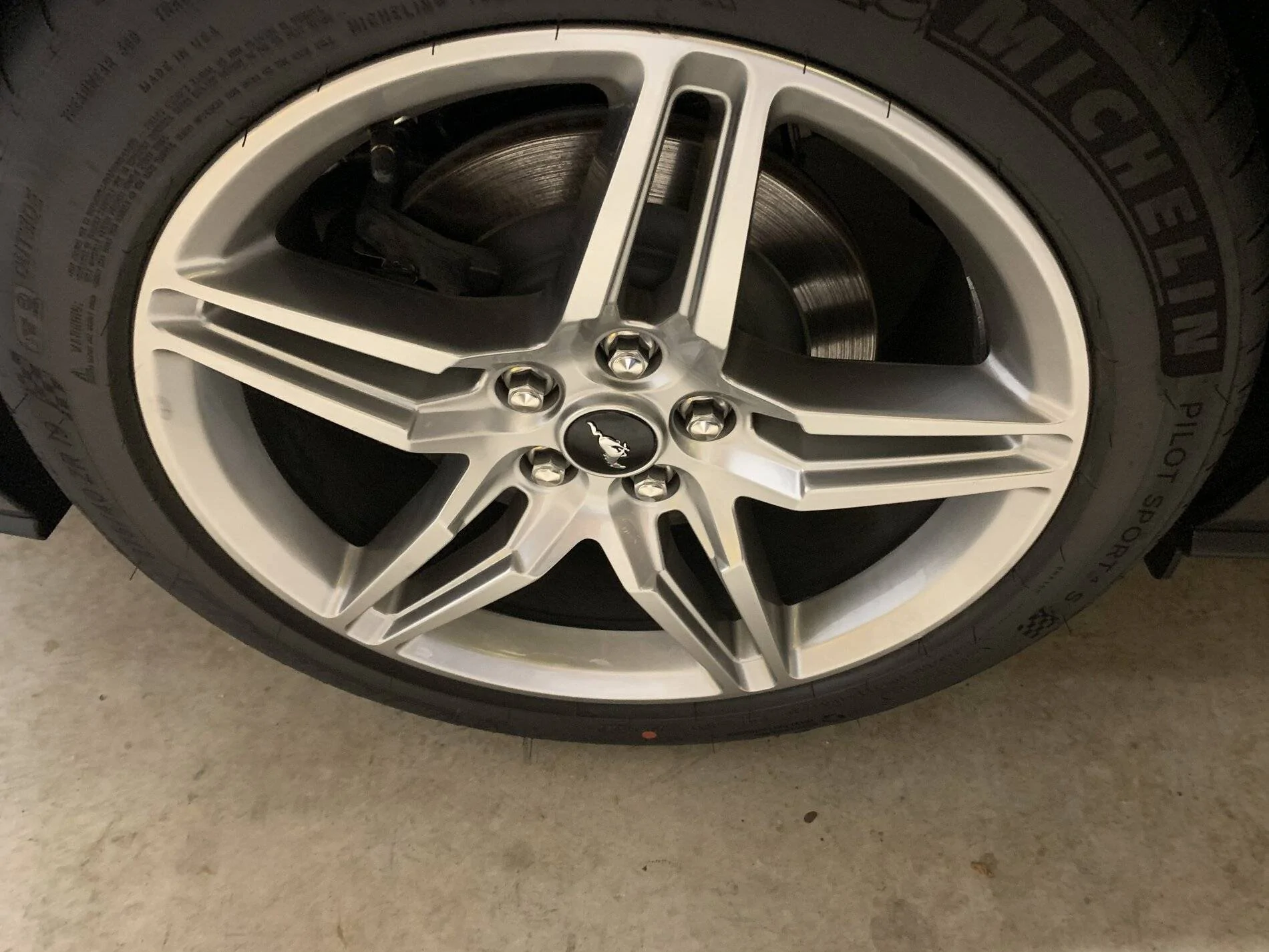

This is my current wheel. How can I figure out the offset? Nothing in manual and searching fords part site gives me conflicting info. It’s a 2020 GT w PP1. Would offset be different for front and back? I think I want to stick w wheels that have are the same size and offset as I have now.

Yes the offsets are different on the factory PP wheels, even the nickel five spokes you have. The factory rear PP1 19”x9.5” wheel has a +52 offset, and the front PP1 19”x9” wheel has a +45 offset.
