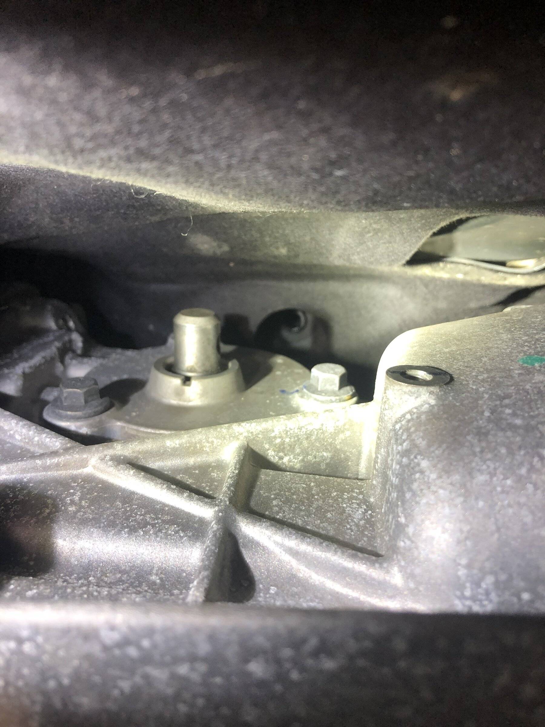

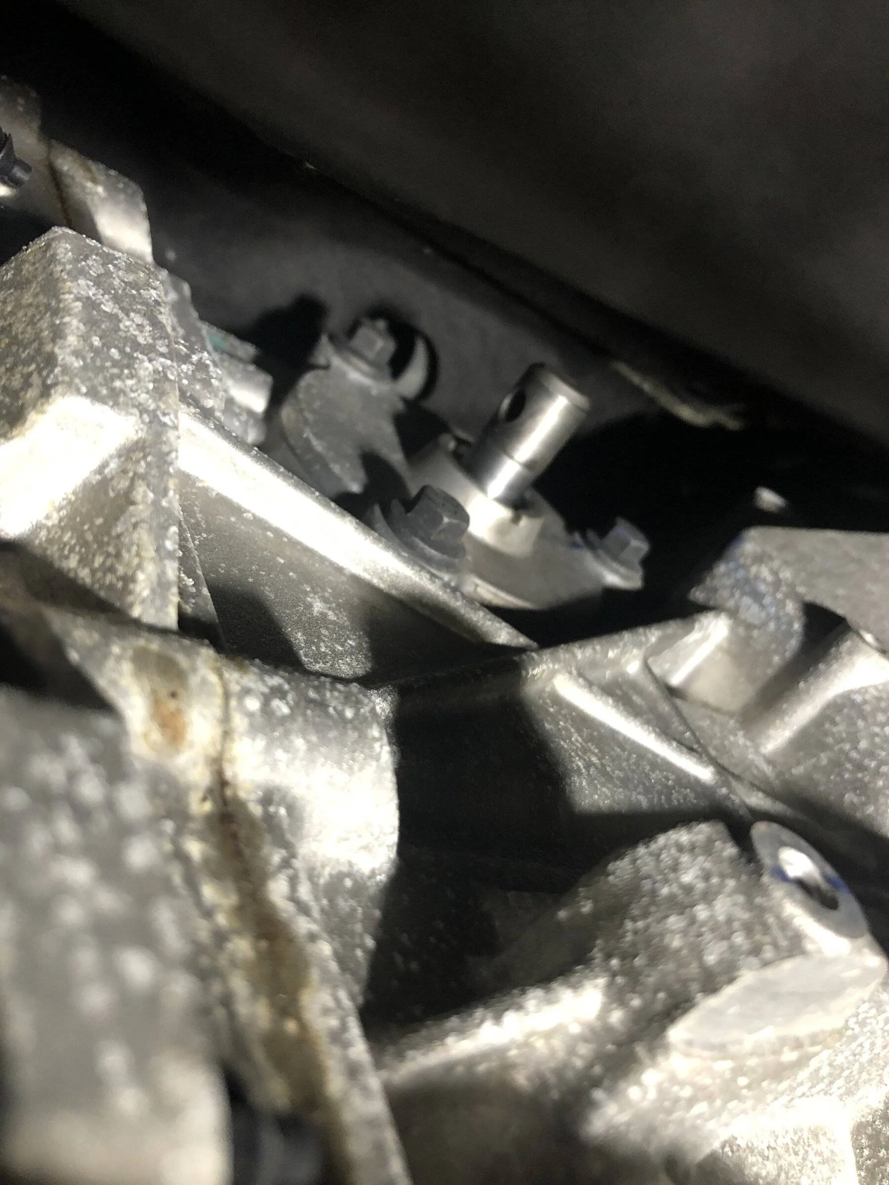

So I just got my car back from roush a few days ago for SC install, tonight I noticed a weird vibration in the shifter so I jacked it up and crawled under there, a drive shaft bolt had backed out and was touching the shifter!

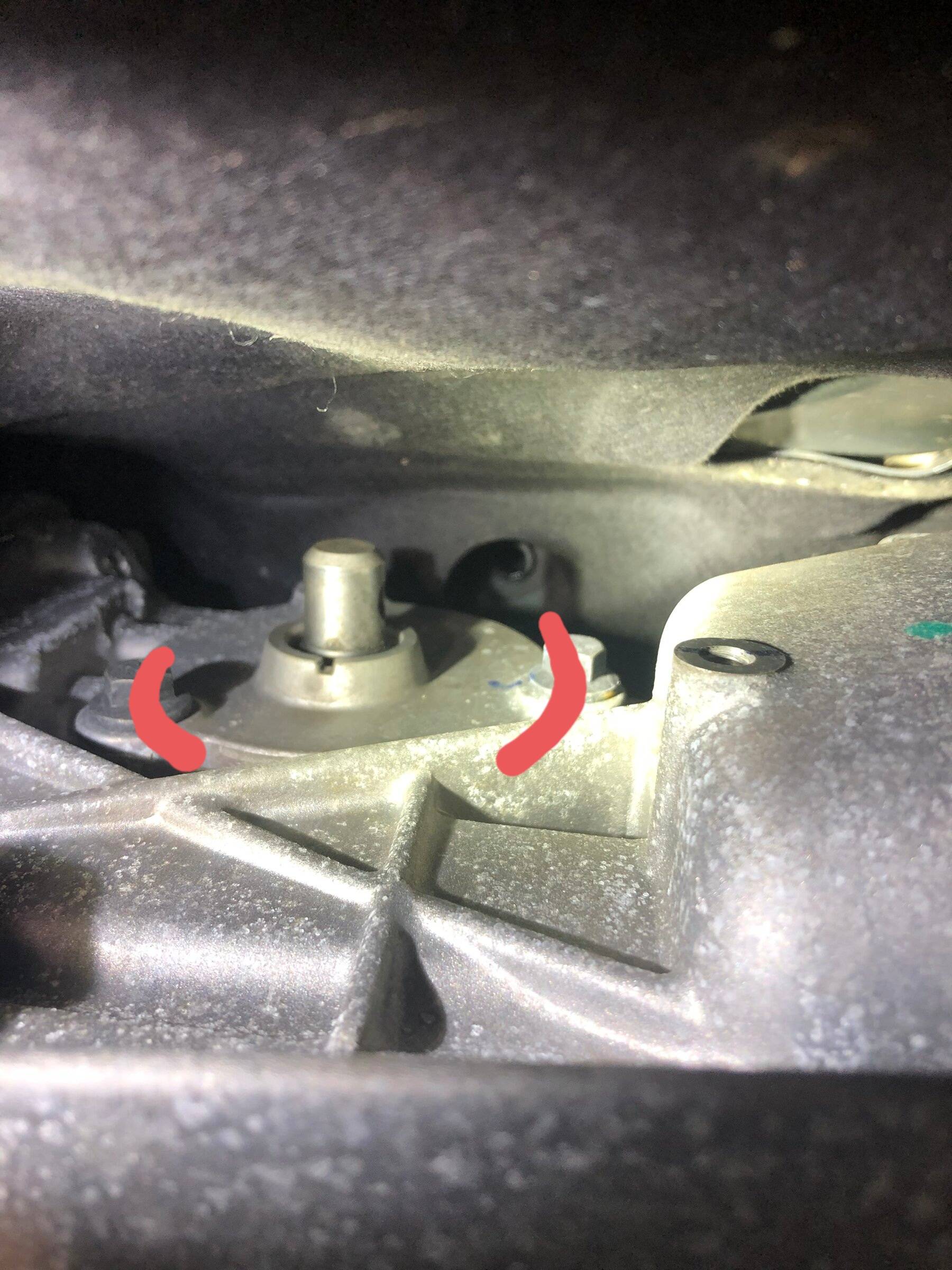

Anyway, reason for the thread, I noticed this pin on the passenger side of the trans that I could move back and forth like a half inch with a hole going up to what looks like the floor board directly above it. Any clue what this is?

You should have a counter weight there but apparently the pin fell out and yours fell off too. Best bet is call calimer transmissions and order a block off plate. I will warn you it's a pain to pull the rest of that assembly out while the trans is in the car but it is doable.

Put a jack underneath the trans and remove the tranny mount. Lower it as much as you can. Then getting to the 3 bolts is easy but once its loose its a very tight squeeze wedging it out of there. I ended up cutting one or two (can't remember for sure which) of the bolt flanges off with a Sawzall. It came right out after that. Getting the block off plate on after that is a piece of cake.

Once I pulled it away from the tranny it was easy to get a Sawzall up in there and this is where I trimmed it. You might luck out and get it out without cutting but I sure couldn't.
