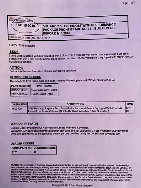

If you have a non-PP GT or a PP EcoBoost with a date of manufacture prior to sometime in February of 2015, and you have a brake squealing issue, then TSB 15-030 probably applies to you.
The TSB calls for the front rotors to be replaced with a new part number, and a new set of front pads (same part number) to be installed.
I had this done last April on my 10/2015 built GT with 10,000 miles on the odo. Today, at 23,000 miles it is still quiet as a mouse.
All that said, if your car was built after the February cutoff, it already has the new style parts - you are looking at some other problem.
Search the forums for 15-030. Someone posted a picture of the TSB, you can read it for yourself. (never mind, I found it - see attached)

You said your car was a GT with Performance Package.
The TSB does NOT cover the PP cars.
Your dealer will tell you to pound sand because the TSB doesn't cover GTs with the PP.
As suggested, buy some quieter front brake pads (ie, ceramic).
thanks for the insight. why would it cover the standard 5.0L and not the PP one?? but it covers the ecoboost PP? do you think if I showed the dealer that TSB image they would replace? because that is clearly the issue and its bullshit that I have to pay out of pocket for new pads on a brand new car....
Unless I suddenly went illiterate the post above yours shows the TSB and says "5.0 and 2.3L WITH performance package..." Without a differentiation it's implied in writing that the "and" means both motors with PP. They can't deny you a TSB because the dipstick who wrote it doesn't know proper grammar.
I was thinking that same thing when I first read it.... that's why I figured I might be able to convince the dealer and pull one on them..
Yeah, the way it was written has been beat to death on other threads about the TSB.
What is meant by the TSB is that it applies to:
  • GTs ... and,
  • Ecoboost with PP
That is because the GT and the Ecoboost with PP have the same exact front brakes.
The GT with PP has entirely different front brakes.
Go to the dealer with your complaint of squeaky brakes on the GT with PP and they will run your VIN and come back and say the TSB does not apply to your car.
