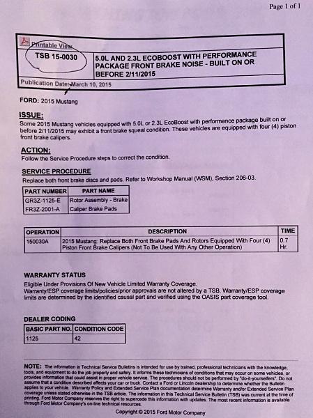

Does anyone have a link to the TSB? I have a non-PP GT and starting to get serious squeals. I could not find 15-030 TSB online.
It doesn't seem to be posted on any website (that I can find), other than the various Mustang forums, but a photo has been posted a million times (by my count) on this one.
Note that the title is not nearly as clear as it should be. A little punctuation would have gone a long way. It says "5.0L and 2.3L EcoBoost with Performance Package front brake noise - built on or before 2-11-2015.
Some have read this to mean "cars with performance package, whether 5.0L or 2.3L". This is not the case. It should read "5.0L without PP and 2.3L with PP":
Here's why - there are 3 brake configurations available on 6th Gen Mustangs so far.
  • GT with PP
  • GT without PP and EcoBoost with PP
  • EcoBoost without PP and V6
The GT with PP has unique brakes. Different calipers, pads, rotors from every other car. The non-PP GT and the EB PP share the same brakes. The V6 and non-PP EB share the same brakes. The only way to read the title that can possibly make sense is the way that I described.
Apart from that, dozens of members of this forum have had their non-PP GT brakes repaired under this TSB (including my own), while zero of the GT PP owners have. And finally, note that there is only one part number listed for the rotors (and one for the pads). This can only possibly fit one of the 3 options.
I hope this helps.
Here it is again:
