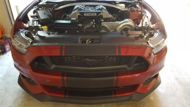

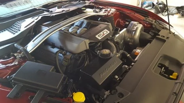

Well, the install is done and the she is buttoned back up (only a couple of push pins left over, lol). Still working with Lund on the remote tune, just did a WOT of Rev 4. Still a little choppy at 2500-3500 and a lot of negative knock.

Good stuff.
So, how does it feel so far? Do you notice much more torque down at the lower rpms? Or do you really need to rev it out to notice?

Not a good feel for it yet, will be able to tell more once the tune is squared away. But I can say it pulls like mad over 4K :D.
