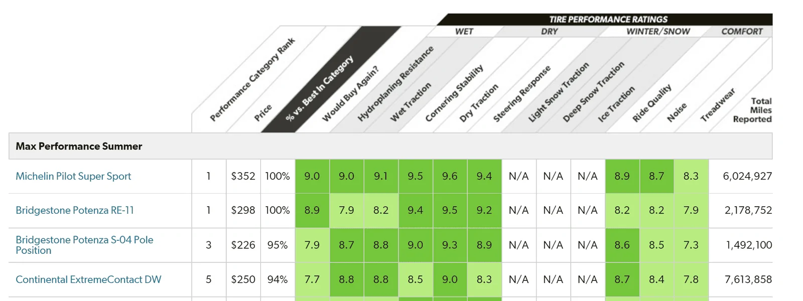

Everyone says MPSS are great for everything, and that's most likely true. However, I have my limits too, and I don't see the point in spending over $300 per tire when I can get similar performance for less! Bridgestones (S04 or RE-11) will be the way to go for me.
This chart is for 285/35r19

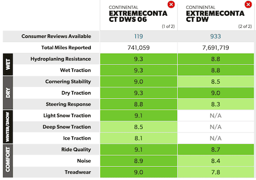

Cloak,
You can't compare tires from different categories using the TireRack compare tool. For example notice how the DW scores lower than the DWS in the dry:
Since the DW is a summer tire, it should out perform the DWS which is a all-season.
I even emailed TireRack about RE11 vs MPSS since the rankings of MPSS are higher than RE11. I was told the RE11 should outperform the MPSS. I was assured the rankings posted on TireRack are relative to the tire's category.
The RE11 is a extreme performance summer tire and the MPSS is a max performance summer tire.
