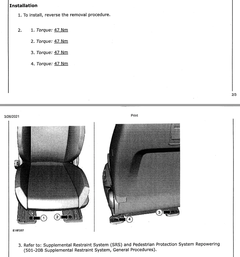

I looked it up online a while ago and came up with 21 ft-lbs on the seat mounting bolts.

I need to have a fire extinguisher mounted for this weekend. I bought a product called the bracketeer I was told would work with he mustang. It is supposed to mount to the seat rails, but because of the plastic trim I cant seem to get it to fit. Alternative, it says it can be mounted using the seats bolts. I ordered a TP55 bit for the bolt but I have found different sources giving different torque specs for the bolts. Does anyone know what it should be tightened down to?
From my dealer :

This was my problem. I have seen both of those, and also 27 lb-ft. I am inclined to go with the 35 lb-ft as in the photo.
I don’t think you can go wrong with 35 lb-ft. If you haven't taken both seats out, try checking the torque on the bolts starting at 21 lb-ft and working your way up from there to see what the factory had them torqued to.
