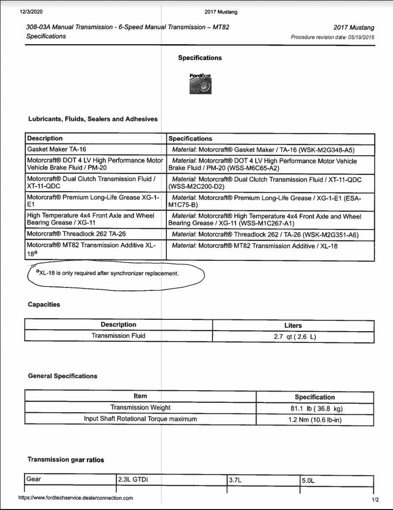

I was only looking for the MT-82 D4 (2018+), but good work . Okay, so looks like no additive is needed for the D4 tranny. Many thanks. Now just have to decide which fluid to use, but might stick to OEM, at least until I'm sure my tranny has no issues. The BG SS-II is a gear oil, vs a DCT oil, so it'd be pretty obvious I have the wrong fluid in there. Plus no noticeable differences with the D4 version, so not worth the gamble IMO. And if Redline is telling me not to put their DCT-F in the MT-82, not going to do that either. :Might do the same thing with the Torsen; just put the Motorcraft fluid and friction modifier. And I could try something different later on if I feel the need for that. But now will have to look into which sealer to use on the drain and fill differential plugs, and 2 pumps for each fluid. Any ideas where to get those? Thx.
