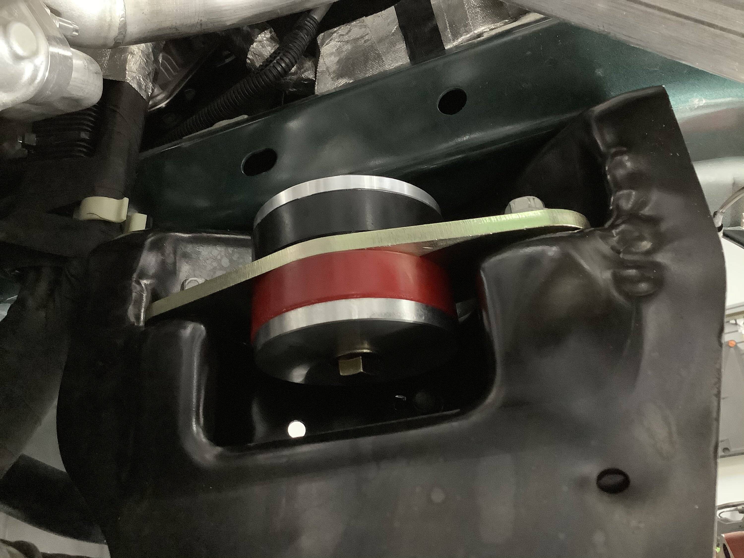

I i Stalled the Steeda adj. motor mounts when I did my LTHs. I stuck with the factory brackets though. No complaints at all. I ran them on my 2013 GT too. I installed the red/black bushings for the drag race setup per Steeda’s instructions.

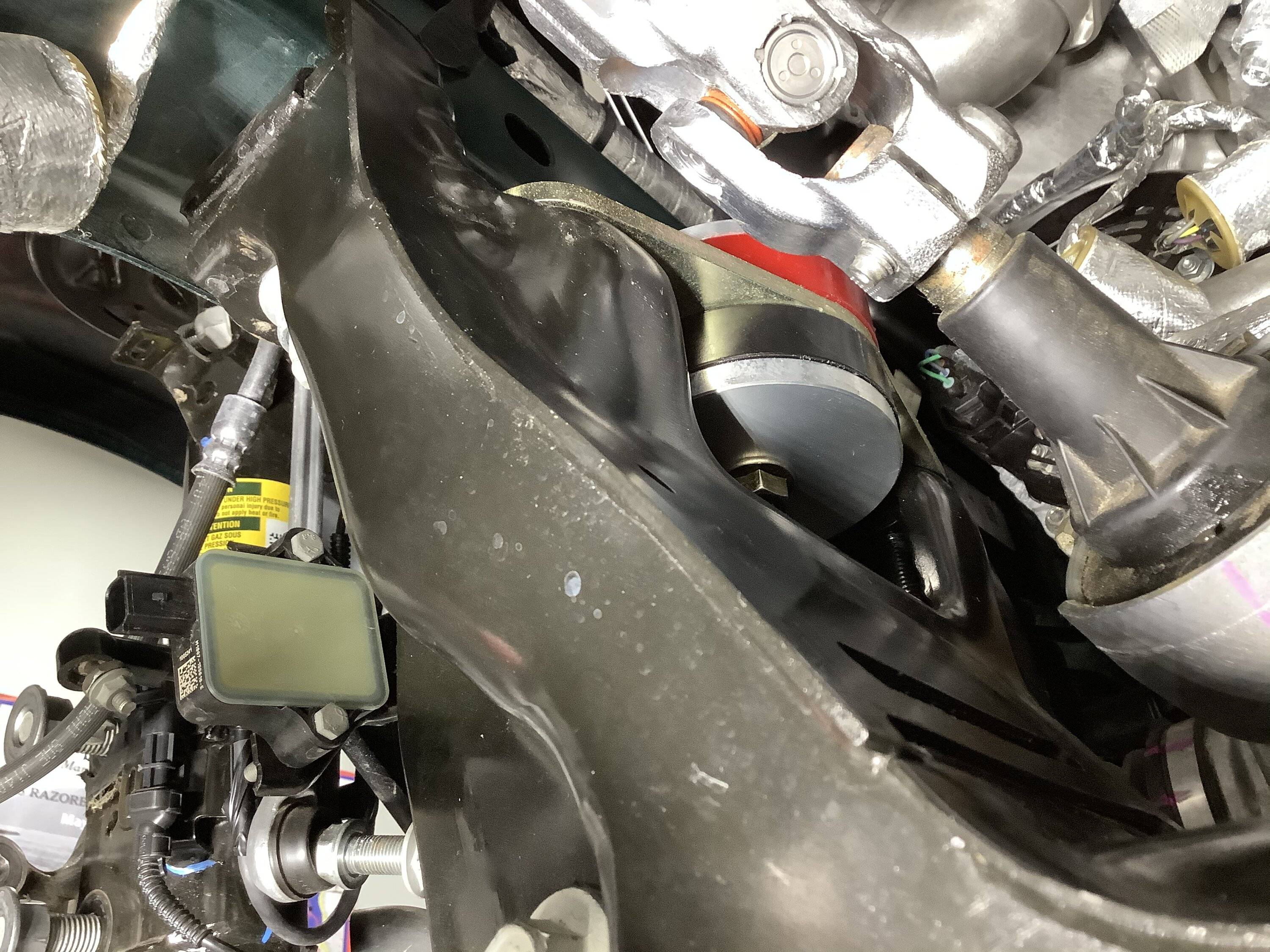

im running the bmr adjustable motor mounts with lth and it def gives more clearance
