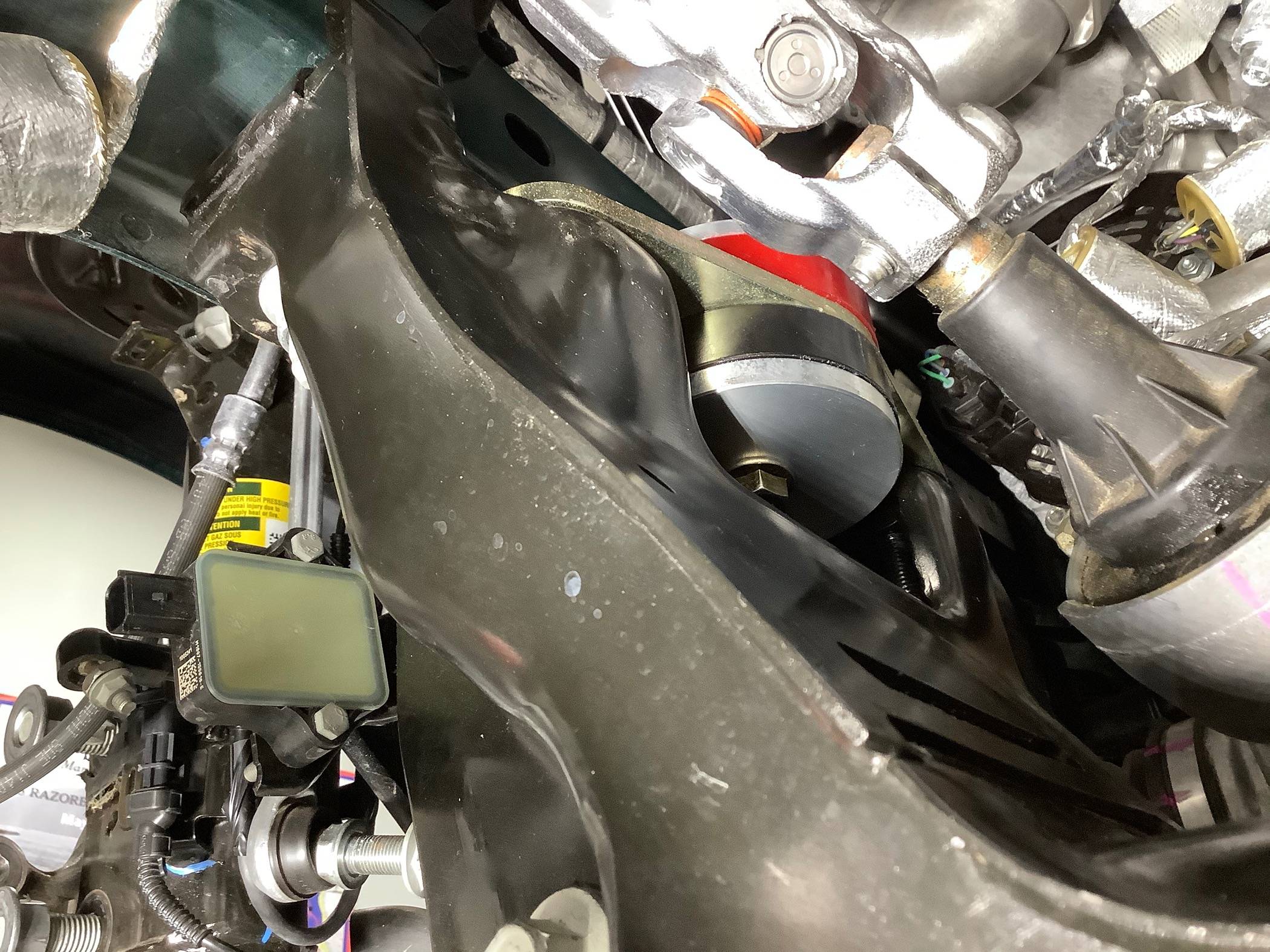

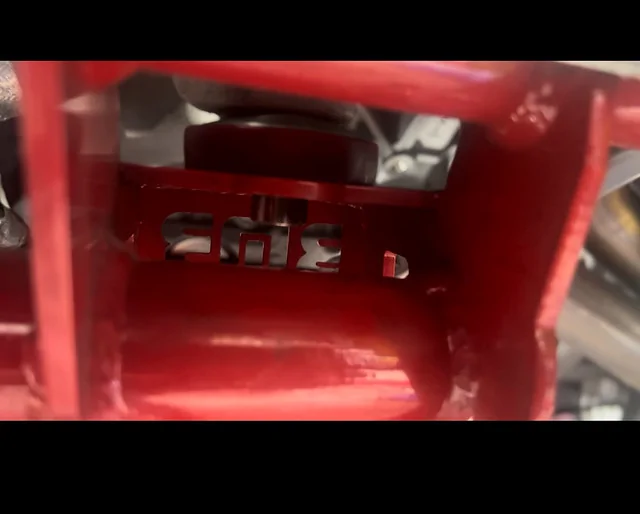

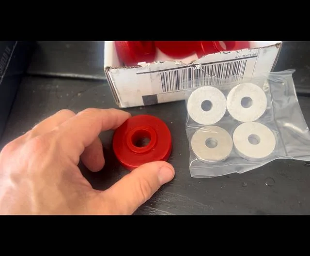

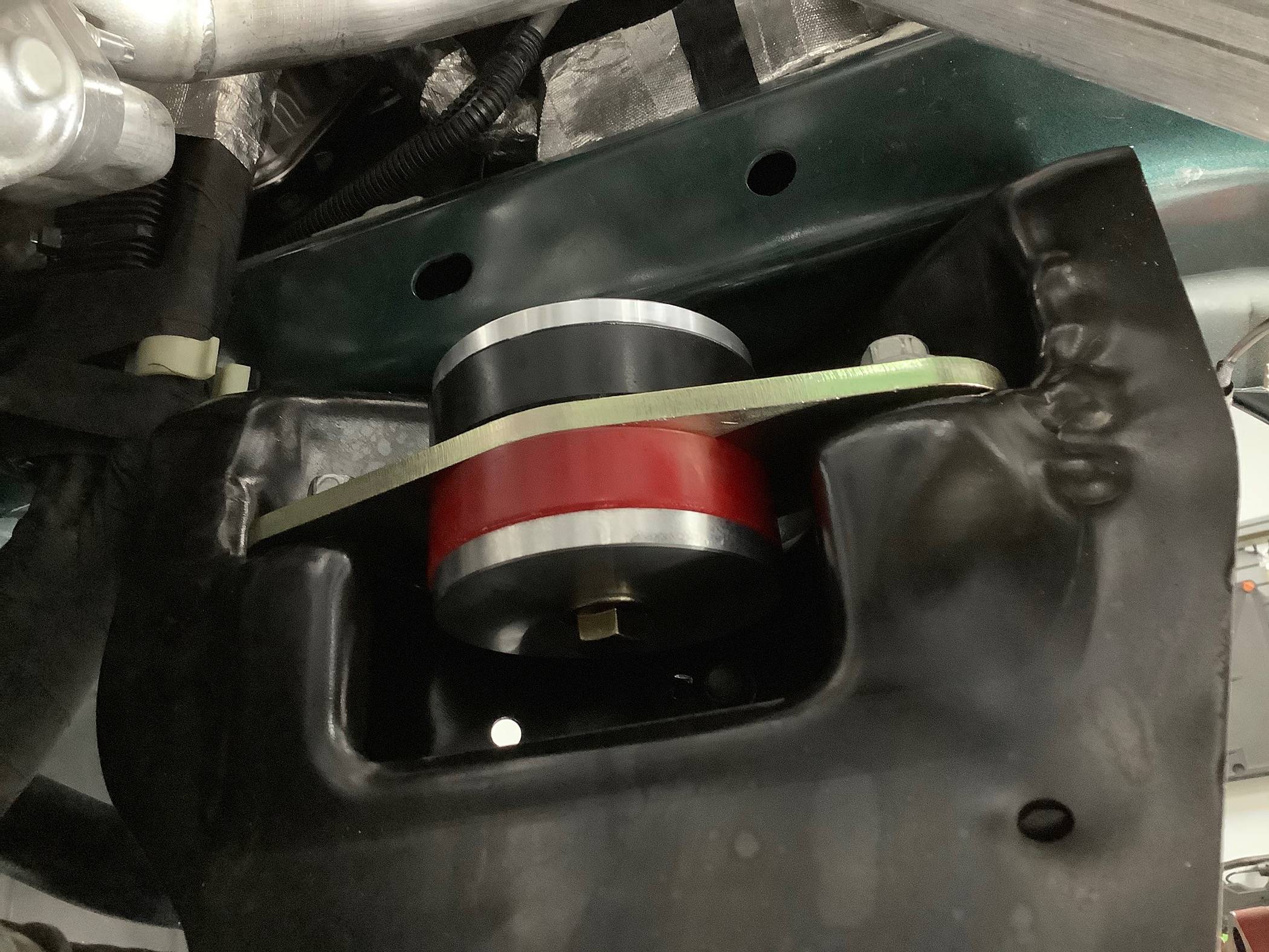

Here are the BMR Urethane Bushings, Steel Bushing Kit (If you want to raise the motor, I did) on a BMR K-Member with stock motor mounts.

I gotcha. Have you tried the way Steeda recommends setting them up for drag racing (with a red over black and black over red) before going to all black? If so, did you notice a difference in performance at all?
Yes, smashed the reds into oblivion. Went to all black and clamps on steedas recommendation.

Those urethane pucks are tiny vs the steeda units.
I think it's because they made them universal. They use the same bushings on the stock motor mounts, the BMR race motor mounts and another one they have. This way they can sell just one part number.

I suppose my point was that a larger puck will last longer.
They are 4 years old and not a mark on them. One of my pics shows a box full of them. I also have another box from the K-member with more of them.
