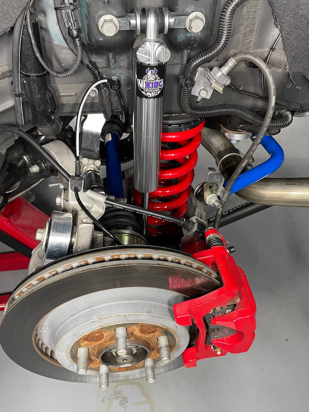

Just had Viking Warrior double adjustable rear shocks along with Steeda Adjustable Pro Action front struts installed. What a world a difference over stock.
Yes I know that’s a given but it’s a night and day difference and very happy with this setup. I also have Steeda sport progressive springs.
Car feels so much more planted off the line and overall handling.
Anyone else running this setup or either shocks?

@Fusion Training Systems what settings are you running on your Vikings? Are you dialing it in for street or track?
Right now we have it dialed in for street. Once I get my welds put on we’re gonna adjust it over to drag set up.
Hopefully in the next 2 weeks I’ll have it all set up.
Before I had these put on the car was so damn bouncy and was very uncomfortable ride. In the corners or going straight WOT it handled very well. But driving around it beat the heck out if you.
Now it’s perfect.
How you have yours set up?
this all new to me so learning as o go.

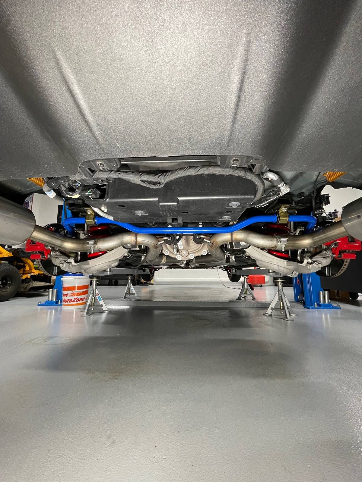

Sway bars help too, I loved adding sway bars on my S197. I am sure you will feel noticeable improvement on your S550 as well.

Did you add both front and rear?
What were the big differences you noticed when adding them?
Thank you
