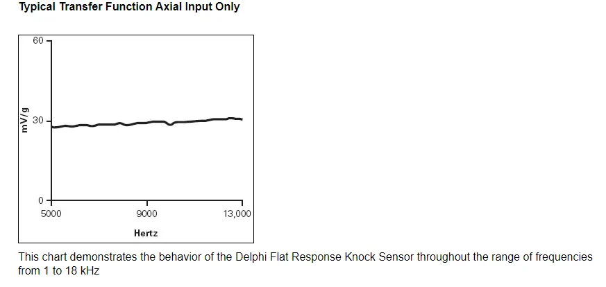

I think we have siemens sensors but the flat responce transfer would be similar.
Output stays within ± 15 percent of average value at the limits of 1 to 18 kHz.
The Knock sensor signal drives a Transistor as an amplifier that uses a 5v reference circuit through a resistor. The ecu uses that signal as its knock signal.
That 5 volt circuit is what sets the CEL for high or low.
You would need a almost constant sound in that frequency range to dive the voltage high or low enough to set a CEL. An engine wouldn't last long if that were to happen from real knock and a CEL would basically be telling you that. With false knock its picking up signal intermittently, like in constant tapping, so the voltage never gets driven high or low for long enough to set a CEL. I don't know what the exact threshold is that sets off the CEL, but it probably pretty bad. I'm sure a source of false knock could get there, but logs would easily tell you its false as the sensors would never add and be positive almost constant.
Gotcha,good info,thats why its so important to look at these looks very carefully and not just look to see if u have knock,but seeing what is really going on.Also i was not sure if it was a certain threshold or a certain amount of knock events that turned on the cel.
