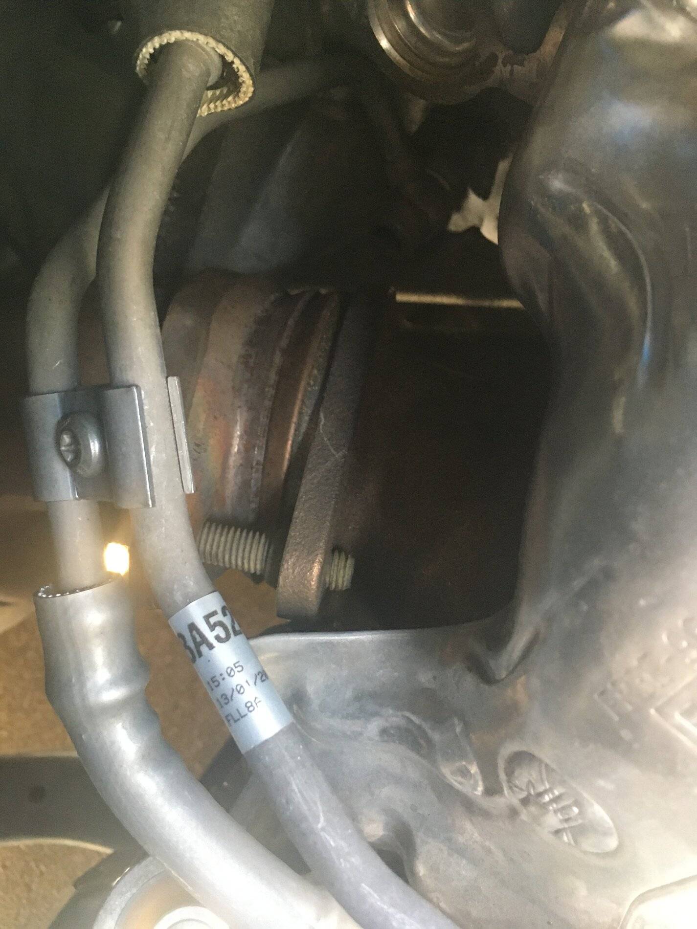

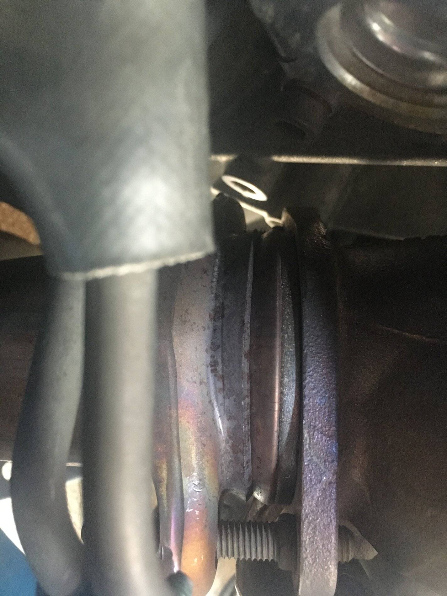

I just went to try and use a torque wrench to check my torque, was going to try 28 see if they turned at all, but I can’t get any of my torque wrenches in that area. I just went by feel with a ratchet when I did, nice and snug.
here’s mine just took photo. You can see my downpipe is kinda smooshed on bottom left, it’s from when it was over tightened, one side was tight and other side wasn’t, it was cocked. And deformed metal a little. No leaks though
I loosened them up, and went even.
Yeah after the reseat I did last night. My DP looks identical to yours. There's a little of the turbo gasket donut showing all the way around.

Yep, that’s what you want. It’s even tension all way around the donut gasket. The downpipe is actually over the gasket, but the bracket pulls it too it and then it to the block.
then you tightened up everything after it. You don’t want to tightened exhaust up and then do downpipe, it needs to be positioned first
Originally I had like 1/4" showing on the top and like 1/8" on the bottom if that.
Now it's even. The only difference is your turbo gasket looks way better than mine. Mine is like a bronze color almost. Probably because it's so used and beat up.
