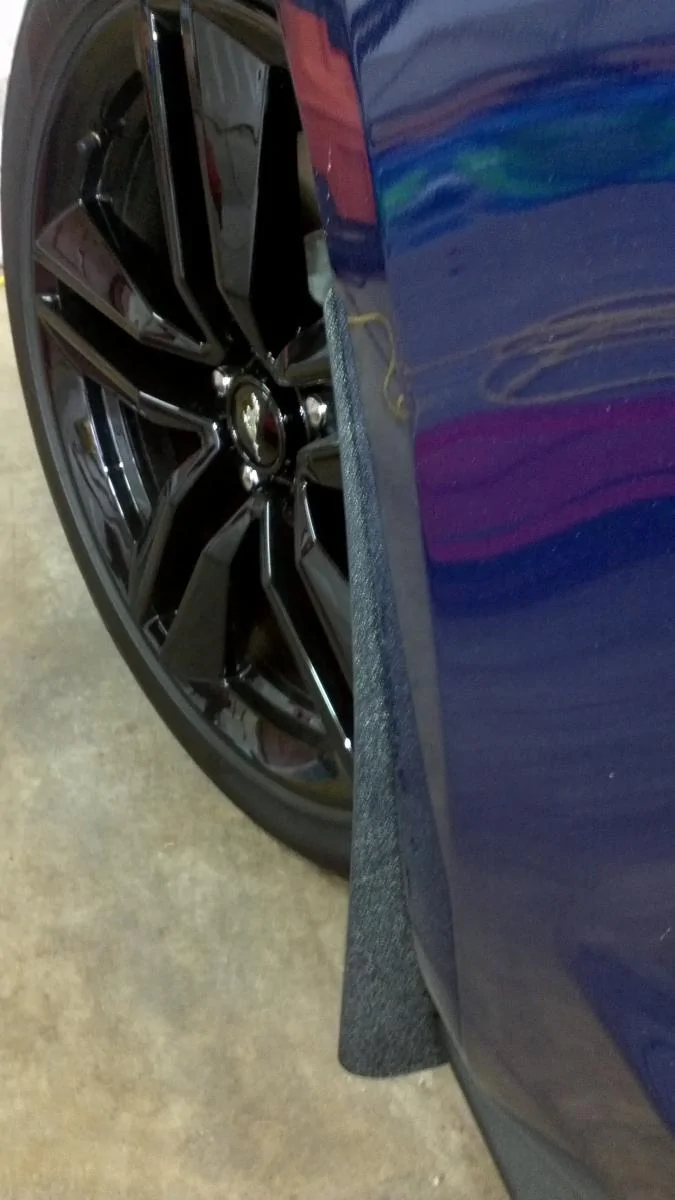

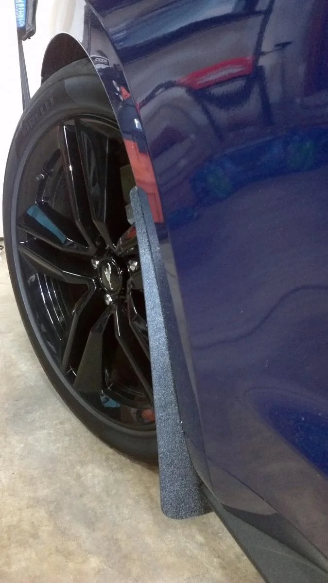

Fronts stick out about 1/2 inch. Shouldn't they taper at the top? Did I install wrong or do they need to be cut to taper at the top?

They should but they don't. The rears fit much nicer.
You can try to draw the tops of the fronts in a little with the clips, but they will probably just lose grip and they'll pull back out again, just like mine do.

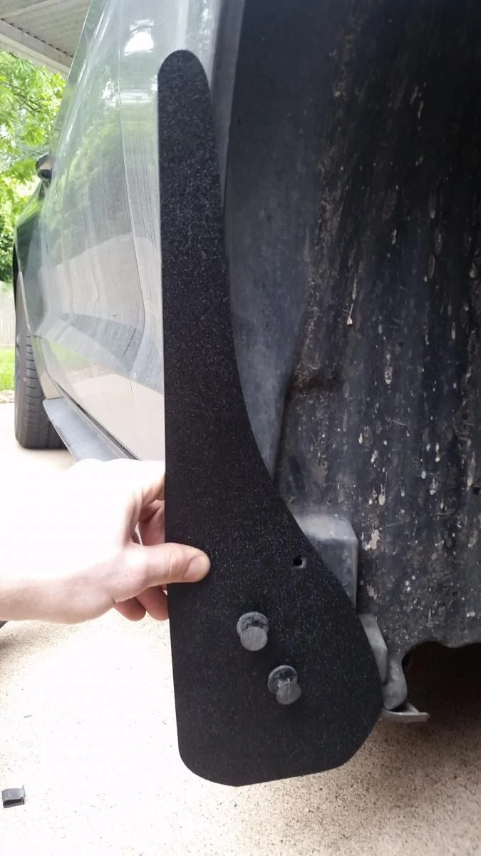

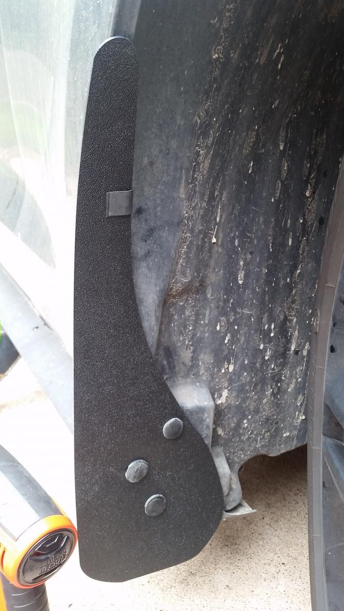

Problem solved!
Why didn't I think of this before? Simple solution:
  1. Widen the top two holes with a Dremel, so the flaps can be tipped in at the top. Yes, I know it's some ugly Dremel work, leave me alone. :p
  2. Snip off the top tip so the clip can reach the fender lip.
  3. Reinstall with perfect alignment!
Took 20m, tops, including cleanup. The material is so thin, I made the cuts with a household scissors.

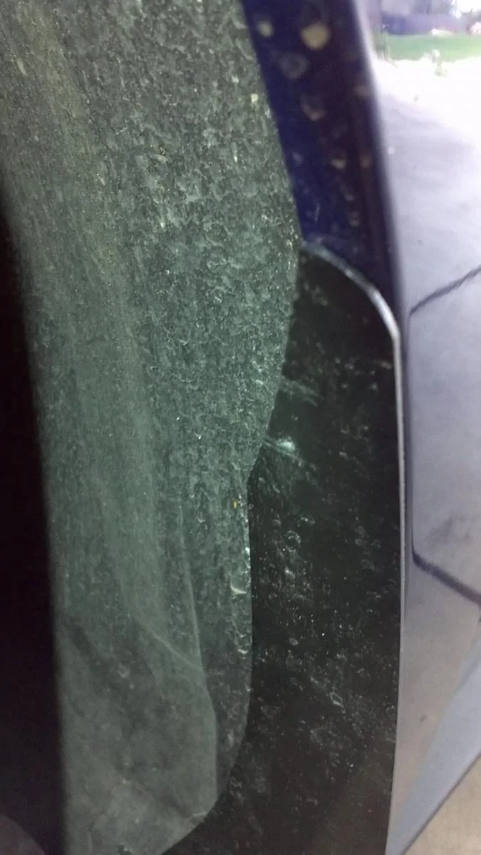

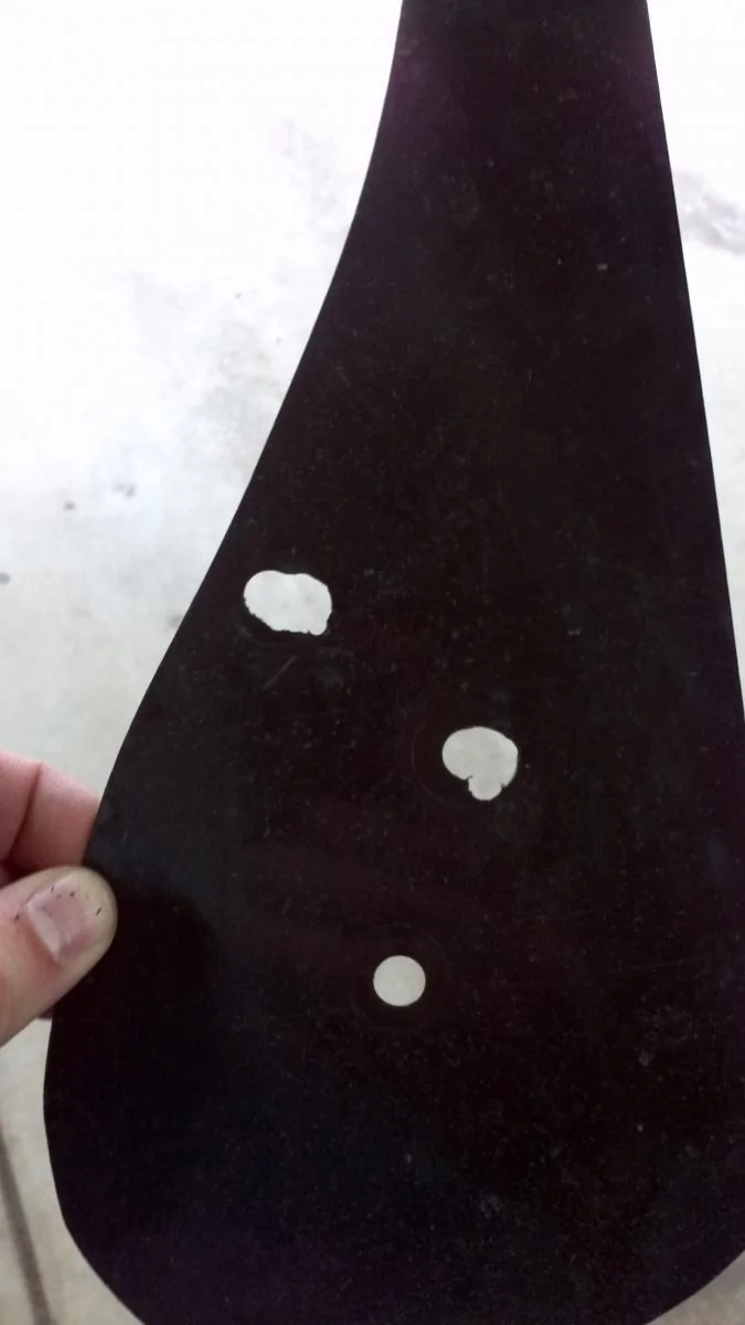

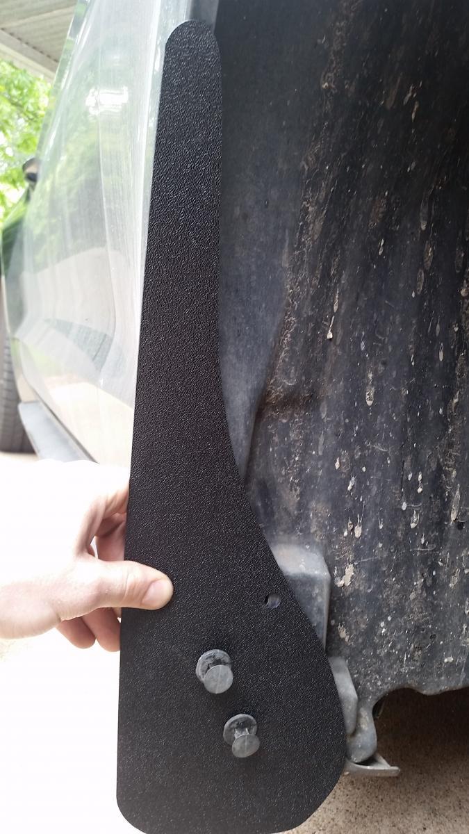

I had to trim as well, but I just took a drill with a large bit to the top hole.
Originally, the top sticks out way too far, it looks super goofy. I can't believe they sold these like this. But after some quick work, it's acceptable. Can't say I'm too pleased, but they do the job.
Out of the box:
Drilled out:
Final:
