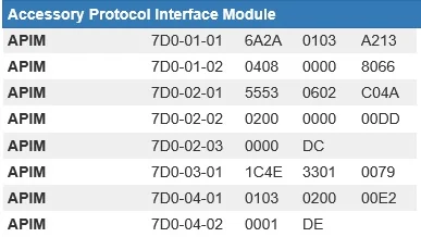

Could you please share:
7D0-01-01
7D0-02-01
7D0-04-02
Thank you.
7D0-01-01
7D0-02-01
7D0-04-02
Thank you.
Here's mine:
