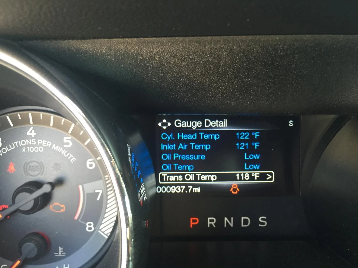

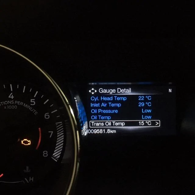

None of the S550s have transmission temp sensors (and that display will stay on 15C or 59F the entire time).
We need the Rear Diff Oil Temp, not Trans oil temp

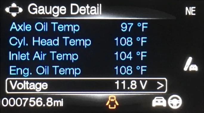

I've been wondering - the GT350's have a different instrument cluster. In terms of physical gauges the tach shows revs all the way to 9K instead of 8K, speedo goes to 200 instead of 160. Is the center LCD display (and whatever controls it) different as well? Could it be that we'll never be able to enable GT350 features without a cluster swap?
I think mattlqx in the GT350 thread added Axle Oil Display with 7F6D 1664 9E32. My OBDLink MX has not arrived yet so I have not tried it.
Seems like I missed the pending request list update ;) Well, I want that Trans oil temp, not Rear Diff Temp.

xxxx 1xxx xxxx (axle) and xxxx 9xxx xxxx (both) do not work.
The data is there because people run it on their phone app; it's just getting it to display in the center list.

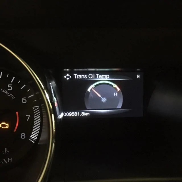

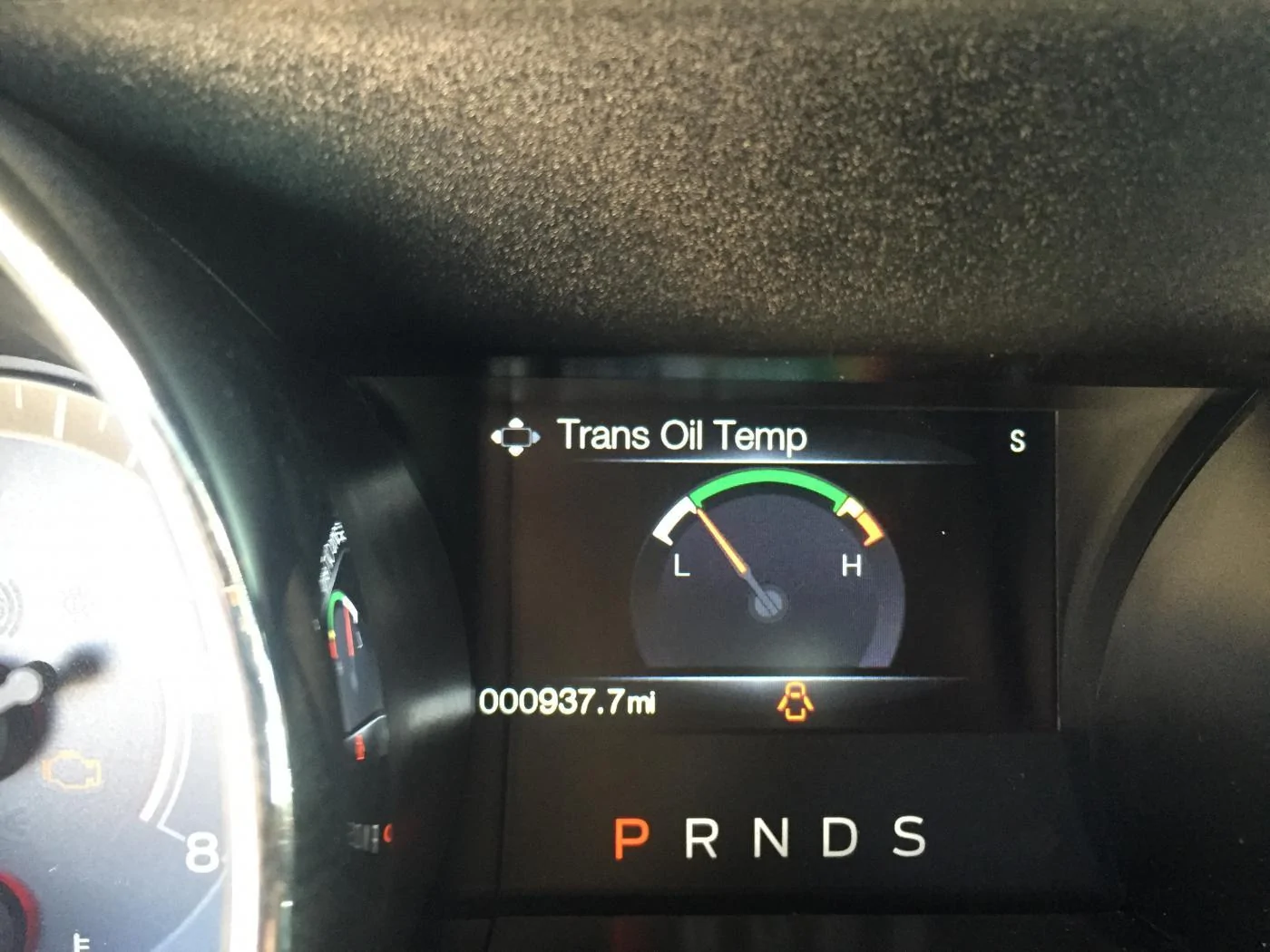

I disagree. This is just ambient temperature data now, but the trans gets up to ~196 that I've seen.
Seems like NightmareMoon is right as far as it is a 15 or 16 GT. Trans Oil Temp is stuck at 15° Celsius - and right now even outside temperature is 30° (86 F).
So maybe this is a 2017 feature?
