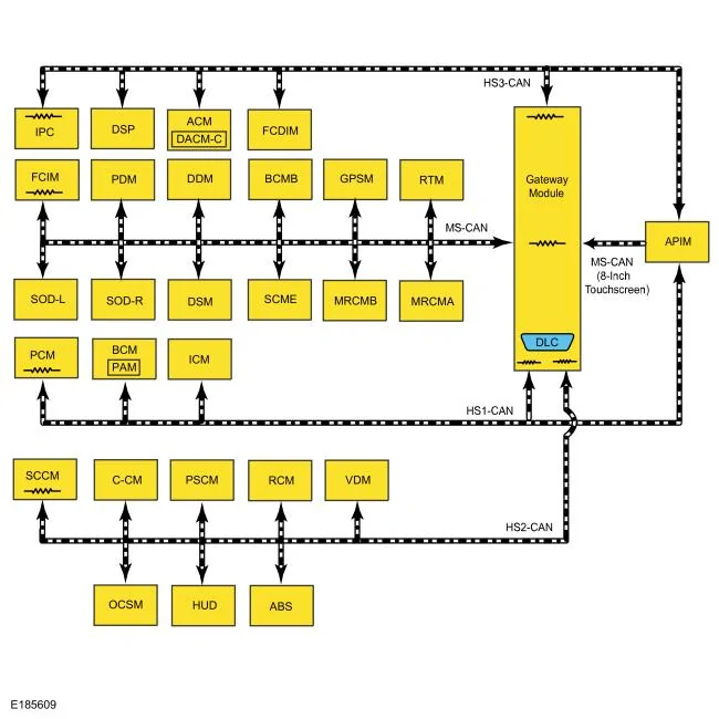

It was under this heading
418-00 Module Communications Network 2016 Mustang
Description and Operation Procedure revision date: 07/15/2015
So section 18, 418, Then just Comm Network Description of operation.
My workshop is actually Fords internal site for Technicians. It's an interactive "catalog" if you will of the multiple pdfs and pages. They make it saveable but in pieces. Suppose it's because they revise pages all the time.

Thanks a lot. I saved it.
Regarding hosting it separately, is there a reason you think that makes it more accessible, particularly down the road? I figured hosting it in the forums made it more likely to still be accessible in the future. Its just that I see old DIY threads that are now useless because the OP has deleted the pics or their account wherever they hosted (or the hosting company changed policies - are you listening Imgur?). I'm sure forums do periodic housecleaning but can't remember threads with missing forum hosted pics.
Just interested for deciding where I should host.
You raise a good point. Here's a proper file attachment.
