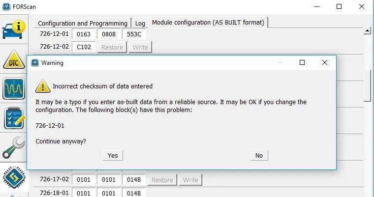

Is this correct?
Total n00b at this.
Is this OK to write? On the first page of this thread, the last digits in the third box are in a 2-hex. As you can see I have 4 (553C).

User Spart helped me in another thread.
Thanks!
