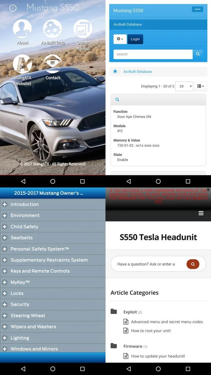

Alrighty, I guess it's time to introduce my app that I'm working on... I know the Excel spreadsheet doesn't get updated really often. So, I created a quick app that will have the AS-Built Data information. Whenever I(Or you if interested) will add a value. The app will be updated in real time. You will be able to make a search as well. Here's how it'll look like... (For now it's only available for Android Smartphone and HU. I might make one for Apple devices later on. Also, Disregard the one screenshot on the bottom right. It was for the Tesla HU thread).
:cheers:
