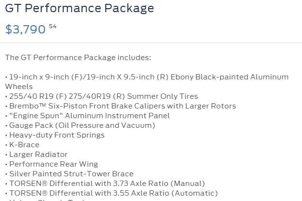

Did you size the full-size for the front or rear? 255/40 front gives 6.375cm tire height; 275/40 rear gives 6.875cm. Yes, I'm concerned about damaging the Torsen LSD (the clutch type--forgot what Ford calls it--can probably take it over a short distance).

2.3% difference across the LSD if you use a front tire on the rear. Now, what constitutes an acceptable spread is one of those "Who really knows?" kind of things, so YMMV. Another issue with using a full size front wheel is that it won't let the cover of the spare tire well sit flat. I think I've seen people say that they have done that, though.

The LSD in the Bullit and PP1 GT S550 is a Torsen-type, which is a geared design that I believe doesn't have a clutch.

So 'base' 'Stangs get the Trac-Loc clutch pack LSD.
