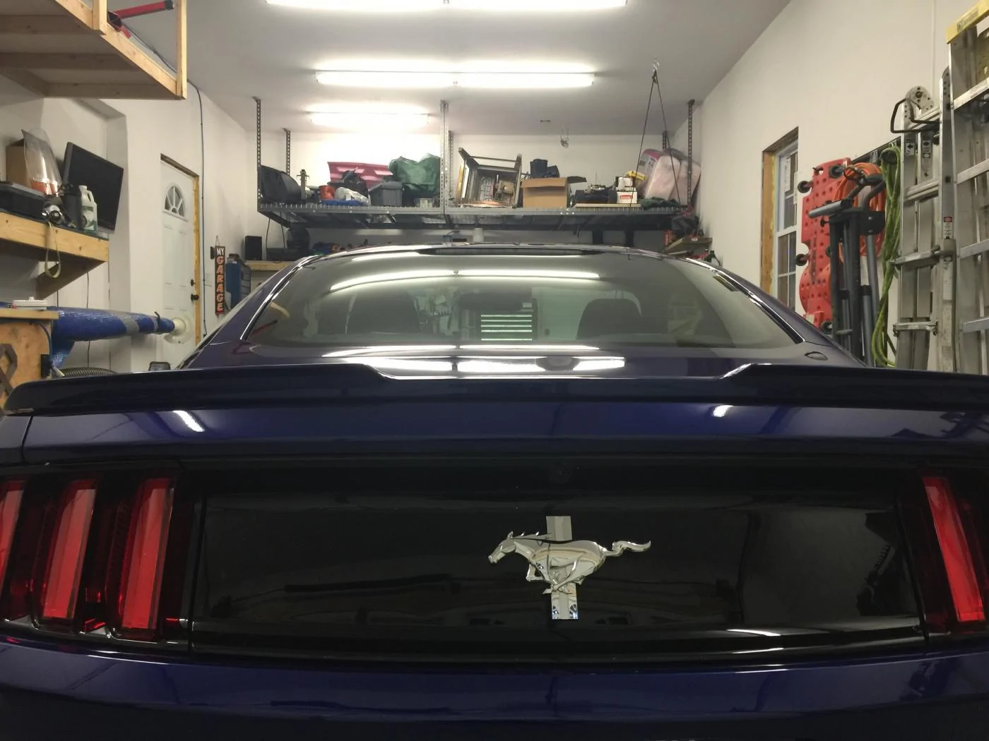

The MMD spoiler needs 4 holes drilled from the top. I recommend 1/4" bit as what they recommend is a little too tight for the screws. The screws are installed from inside the trunk in existing holes on the inside. Also recommend a magnetic screwdriver for the screws as the middle 2 holes are recessed. Besides that it's pretty straight forward and easy to do.

I'll get some more pics later this week. Any particular angles? I'll also take a pic for the inside part of the trunk to show the screw locations.

Thanks for the info. I like the fact that I wouldn't need as many holes and certainly not as large of holes as the Roush. The pics of the inside would be great if you do take some. Looks great. Up until I saw this MMD by Foose spoiler, the Roush was the only one I liked. The CDC is just too big for my liking. I'm glad we are getting some good choices in rear spoilers.

I really like this spoiler. It's very natural and it's not obnoxious.

Can you take some shots further back so we can see the whole car?
This is on my short list with the steeda one.
