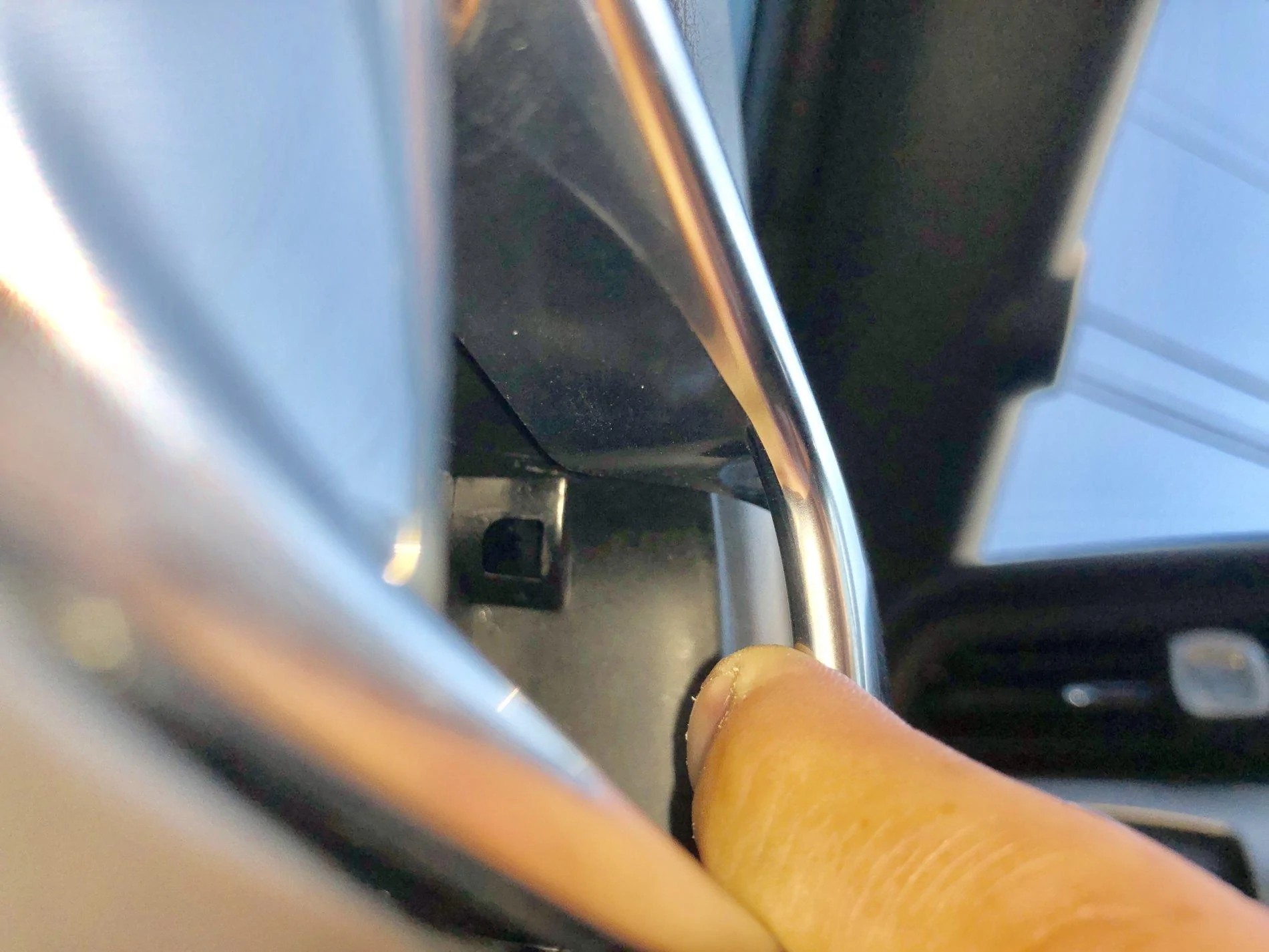

I just noticed after 2,000 miles that there is no driver side led in the handle. When I look inside the handle there’s not even the white led cover that the passenger side has. There’s just a empty hole where the led would have been.
Has anyone had this issue?

It’s there - it most likely fell inside the door...
I also didn’t notice it for a bit, because you just become used to the ambient lighting. I had this same issue on my prior (lemon’d) 2016 S550. It had to be fixed 2x.
The LED assembly would fall out of the door cup assembly, into the door cavity.
Take it back to the Dealer and have them fix it - it’s covered under your 3/36 New Car Warranty.

Yes the inner door handle. I’ll take a picture when I can today. The passenger side has a white led cap on the top part for the ambient light. The driver side is just an empty hole. I honestly can’t remember if it ever lit up or not.

I pulled up photos of when I first got the car and it appears I did have an LED light. So it seems the LED did in-fact fall into the door. Maybe I can get them to fix my extreme A pillar rattle while they are at it..

Well took it to ford today. And apparently the top part has some roughed plastic, which Ford basically accused me of tampering with the housing. I had no reason to ever open the housing of the handle on a car with 2K miles.
Supposedly the led is fixed to the housing and now the entire assembly has to be replaced. Can anyone confirm that?
Your dealer is an ass. Honestly, what difference does the assembly make? Just have them fix it.

Just bought a used 2022 Mustang with the same issue. I can see the light pushed back into the door. It is out of warranty. How does one go about fixing? Can you remove just the door handle section? Looking for some help here.

Not sure if just the door pull section can be removed, I think it’s part of the door panel.
You’ll have to remove the door panel and then access the rear of the panel to make the fix.
If you’re doing this yourself, definitely try to take some images of your steps and post them here, because it seems to be a common issue with the S550 on the driver side.
