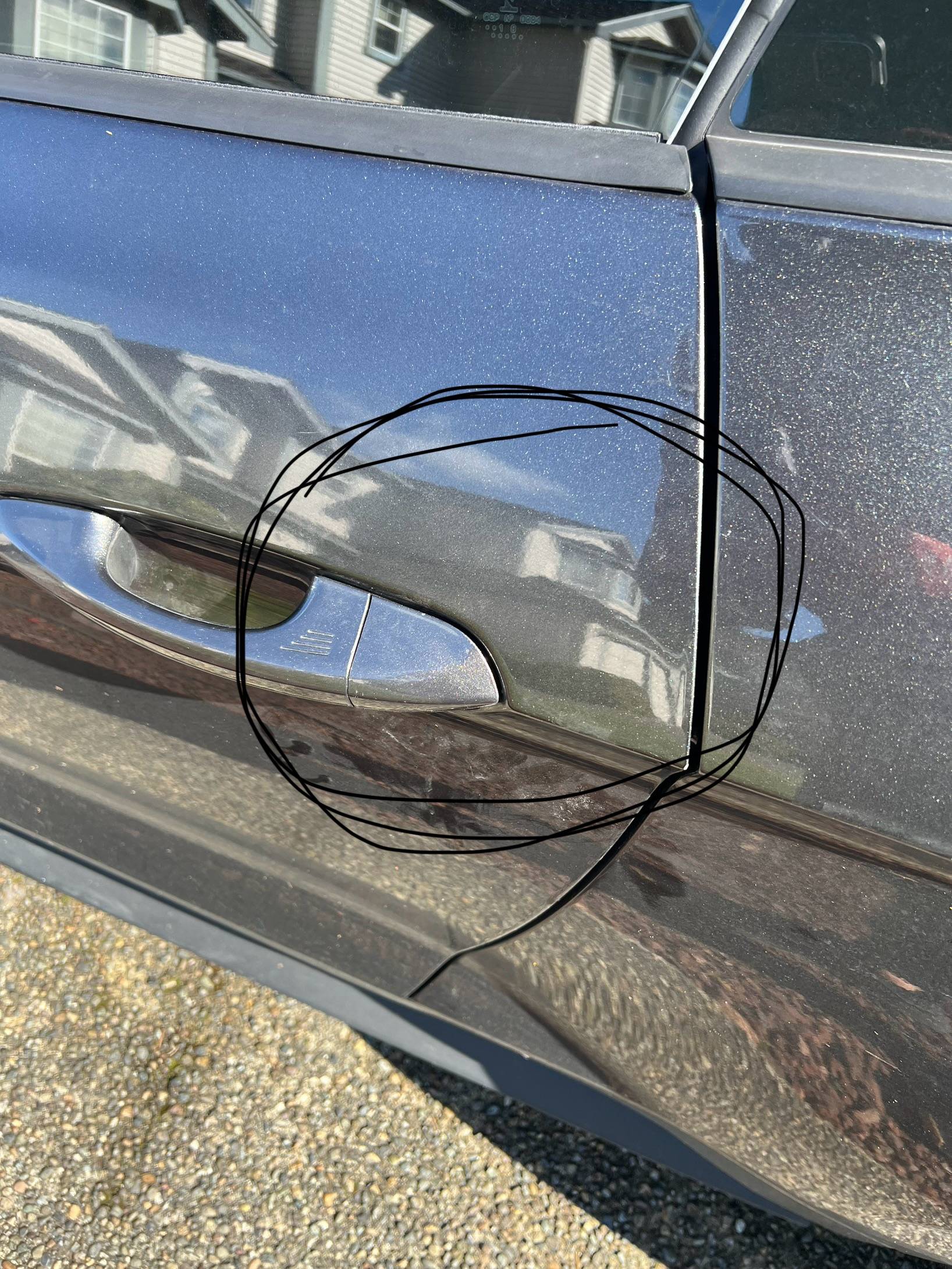

My driver door handle stopped working. The sensor unlock works, the interior door handle works, but I can’t open the door from the outside. The passenger side works perfectly fine.
Last night I got in my car to go get food, after coming back to the car it just stopped working.
I hate working on doors. I always end up accidentally breaking something. Do I have to take apart the whole door to see what’s going on? Has this happened to anyone else?

Just a tip: Don't touch the area with the four lines to the right. That tells the car to lock the door. If you touch both sensors at the same time, the lock will do nothing. Unlocking is done by touching the backside surface of the handle only. In your video I see you're grabbing the door handle and putting your thumb on the lock sensor at the same time.
