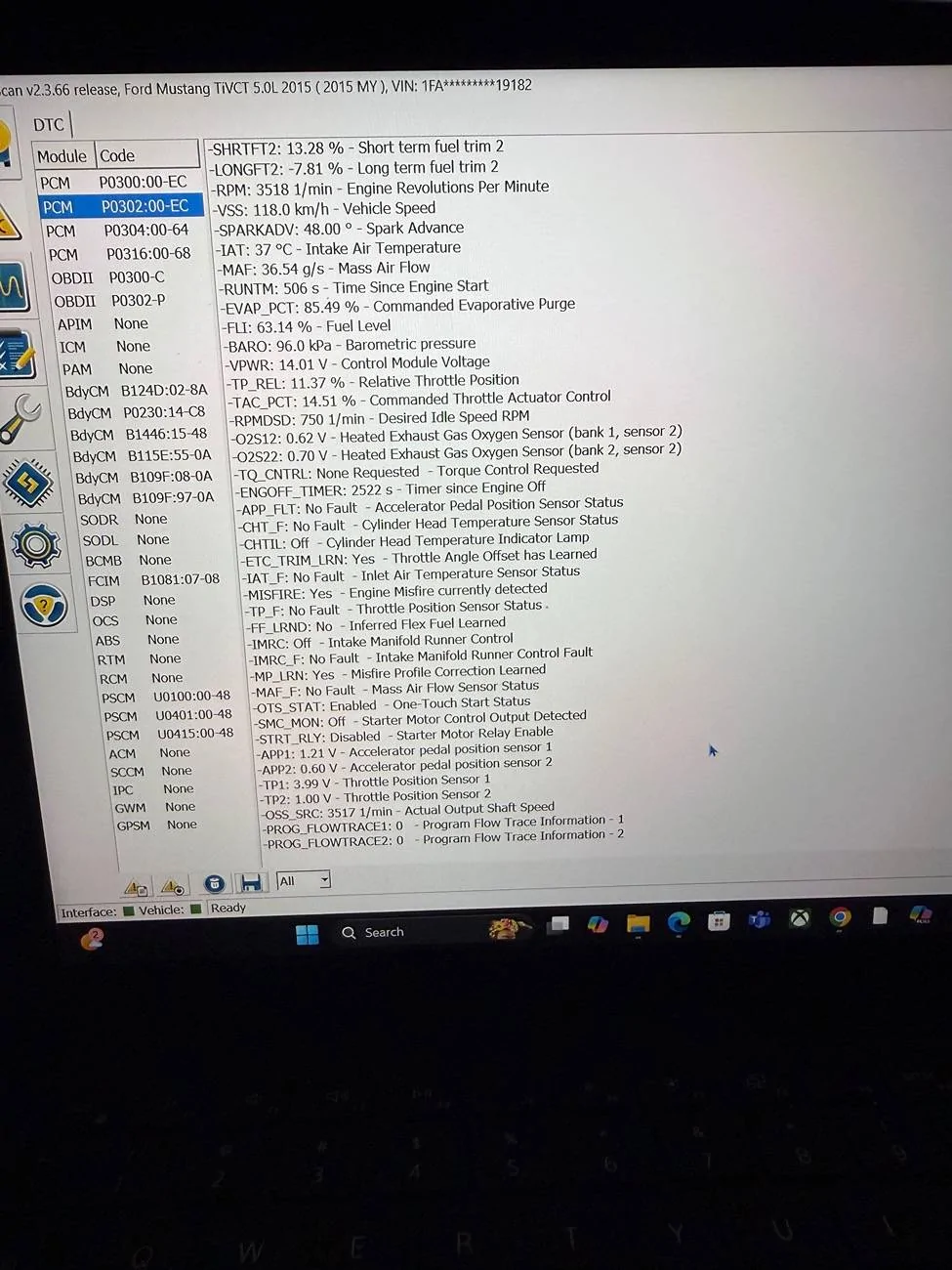

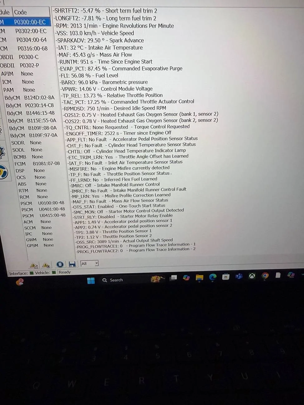

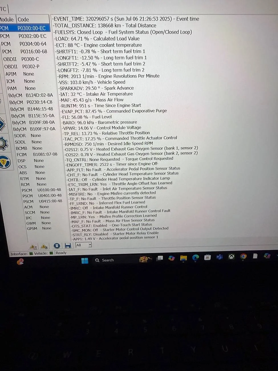

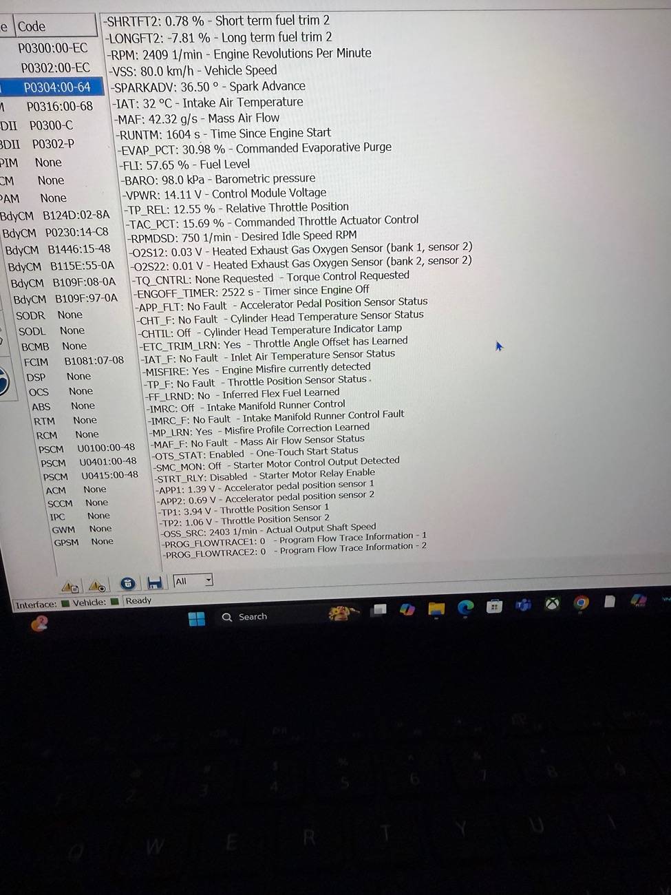

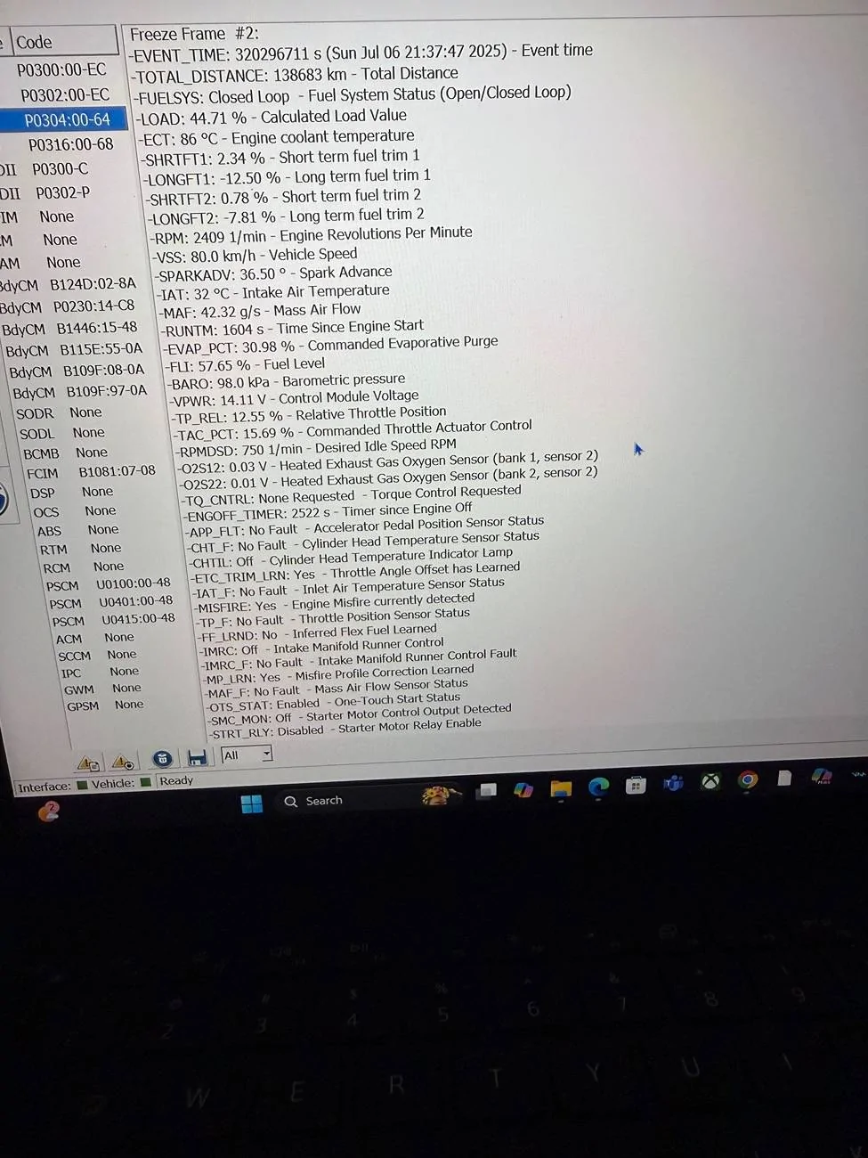

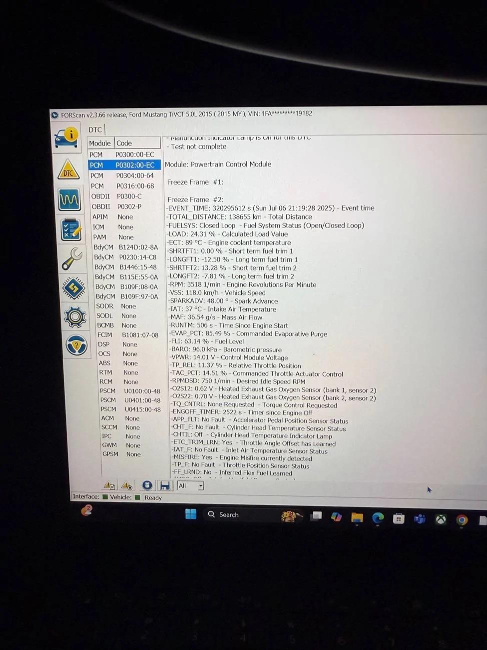

Hello, so I have been trying to solve this issue for the past 2 months. I had opg&crank sprocket, twin disc clutch lpx, and dss carbon fiber drive shaft put on, as soon as I got the car back starting the car became slower, 7 seconds for engine to turn on rather than like 3. I didn’t think much of it until I got p0316, then while driving on the highway my CEL flashed and instantly lost power, the car felt rough. I have freeze frames for P0300, P0302, and P0304. I have literally thrown parts at it and nothing has worked to fix this issue, I even got a new tune.

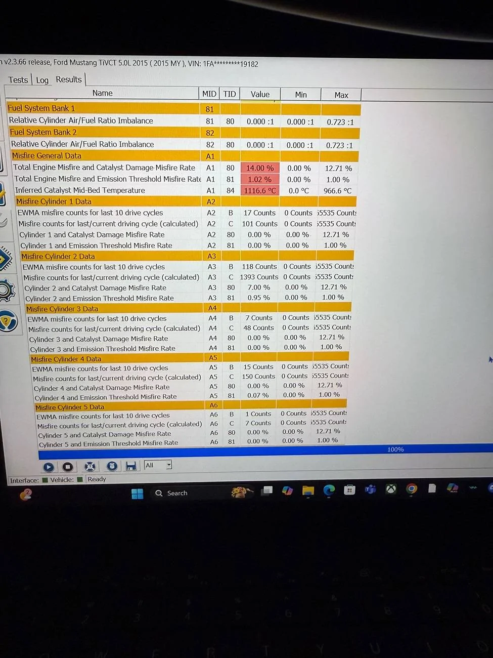

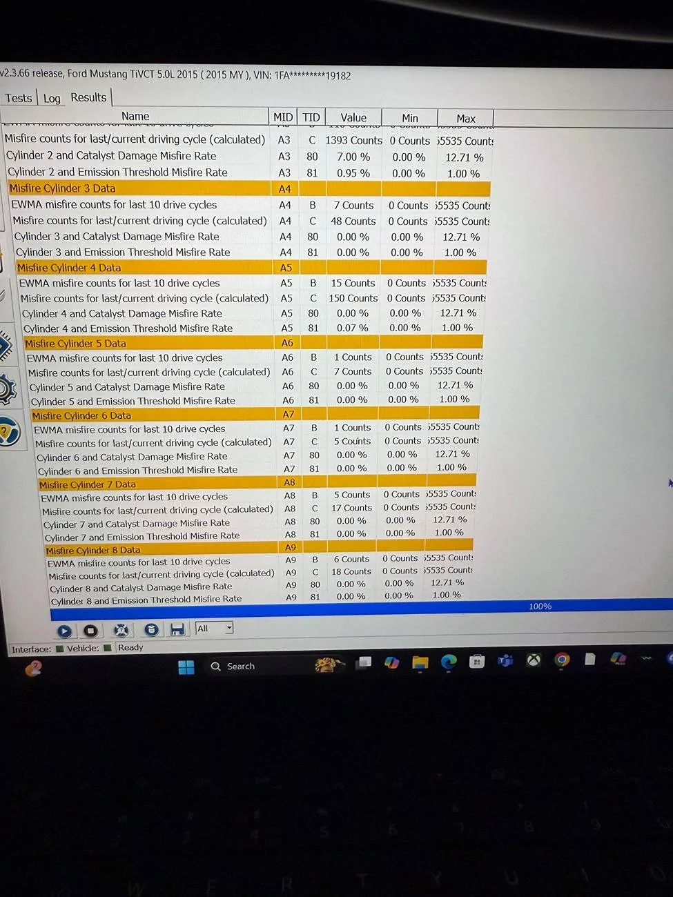

Here’s what I have done, new coil pack on cylinder 1&2, new spark plug on cylinder 1 only, new injectors on cylinder 1&2, fuel pump, CKP sensor. I have looked at the reluctor wheel/tone ring with an oscilloscope, looks normal. The only thing I saw that was weird was the oil and gunk around fuel injector ports on cylinder 1&2. Mode 6 tells me that cylinder 2 has 1393 misfires 🤯, cylinder 1 has 101, cylinder 4 has 150, cylinder 3 has 48, cylinder 5, 7, cylinder 6, 5, cylinder 7 and 8 have 18. One thing I haven’t done and I’m scared to do because of the results is compression testing it, but I find it extremely odd that after I got work done on the car, it started acting up, last time I took it back to the shop they said potentially a fuel pump issue. I will upload pics of the freeze frames and mode 6.
ANY HELP IS GREATLY APPRECIATED!!!
