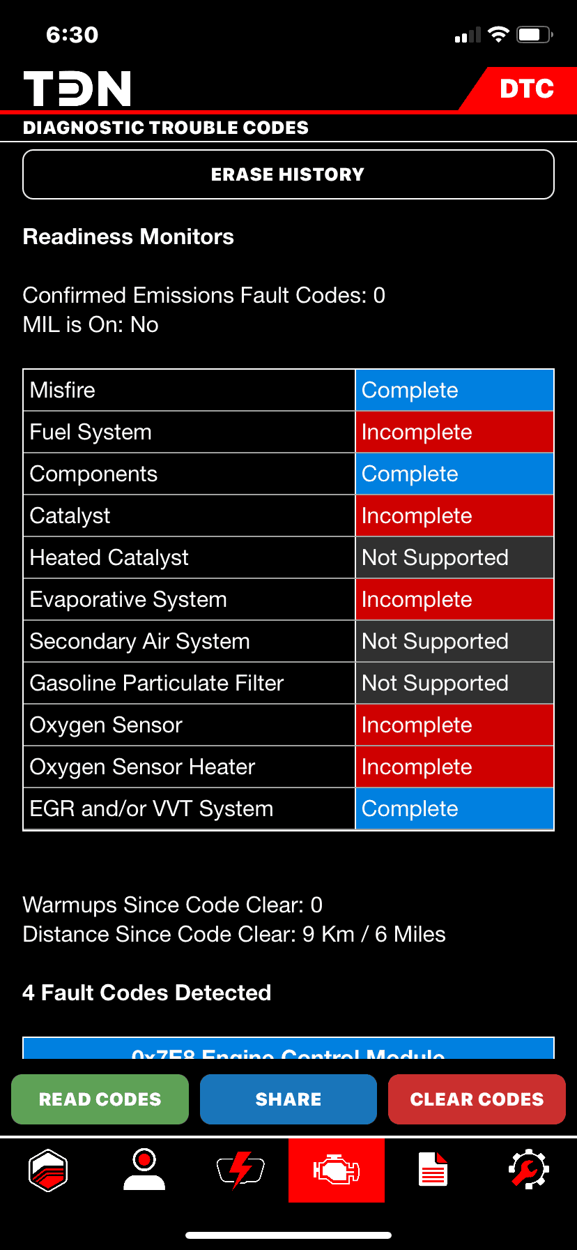

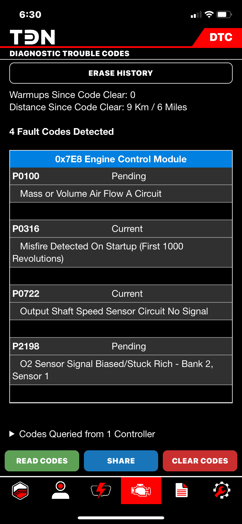

Need help on how to diagnose these codes.
Maf sensor replaced with oem
Speed sensor also replaced oem
2015 GT 29k miles
Car seems to run ok.
Not running in limp mode.
Fresh 93 octane 5 gallons( but 2 year old gas about 3 gallons was in car before refill)
Smoke test performed no leaks
New plugs

I've had a lot of 02 sensors go bad because of running E85. They just don't like that fuel. Do you have headers and are you tuned?
zerolash
zerolash
Jan 2, 2022
61
Huntersville
Jeff
2015 GT 91 LX
Headers and a Lund tune. 30% lean because of a code
Noyz5o
Sep 18, 2018
72
Detroit
Jeremy
2017 GT PP
I'd put a set of O2 sensors in it and see what happens. You are likely tuned with a Flex Fuel tune so you will need to drive the vehicle and allow it to learn the Alcohol percentage. Monitor the ALH_LRN and ALH%.
Noyz5o
Sep 18, 2018
72
Detroit
Jeremy
2017 GT PP
Also perform a Misfire re-learn using the N-Gauge. Clear all codes
