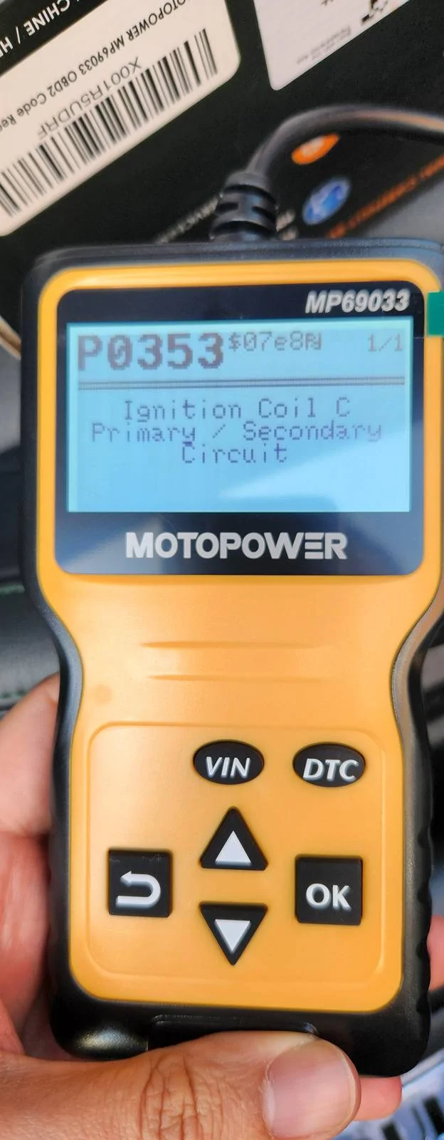

I bought a cheapo code reader from amazon and have P0353 fault code.
Would anyone be able to explain this or is it a workshop job?

That is the the number 3 coil pack. Check/examine the wiring for the coil and or replace. You can also move the coil to another cylinder to see if the misfire follows is.
