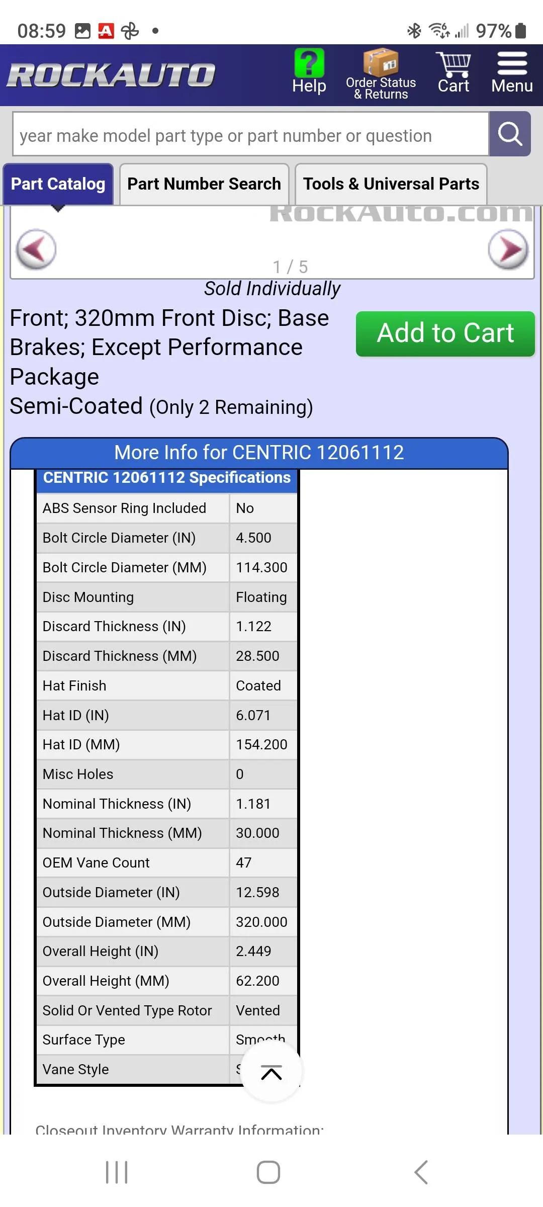

Front? Rear? Base? Premium? I think it matters.
For aftermarket base front rotor;
