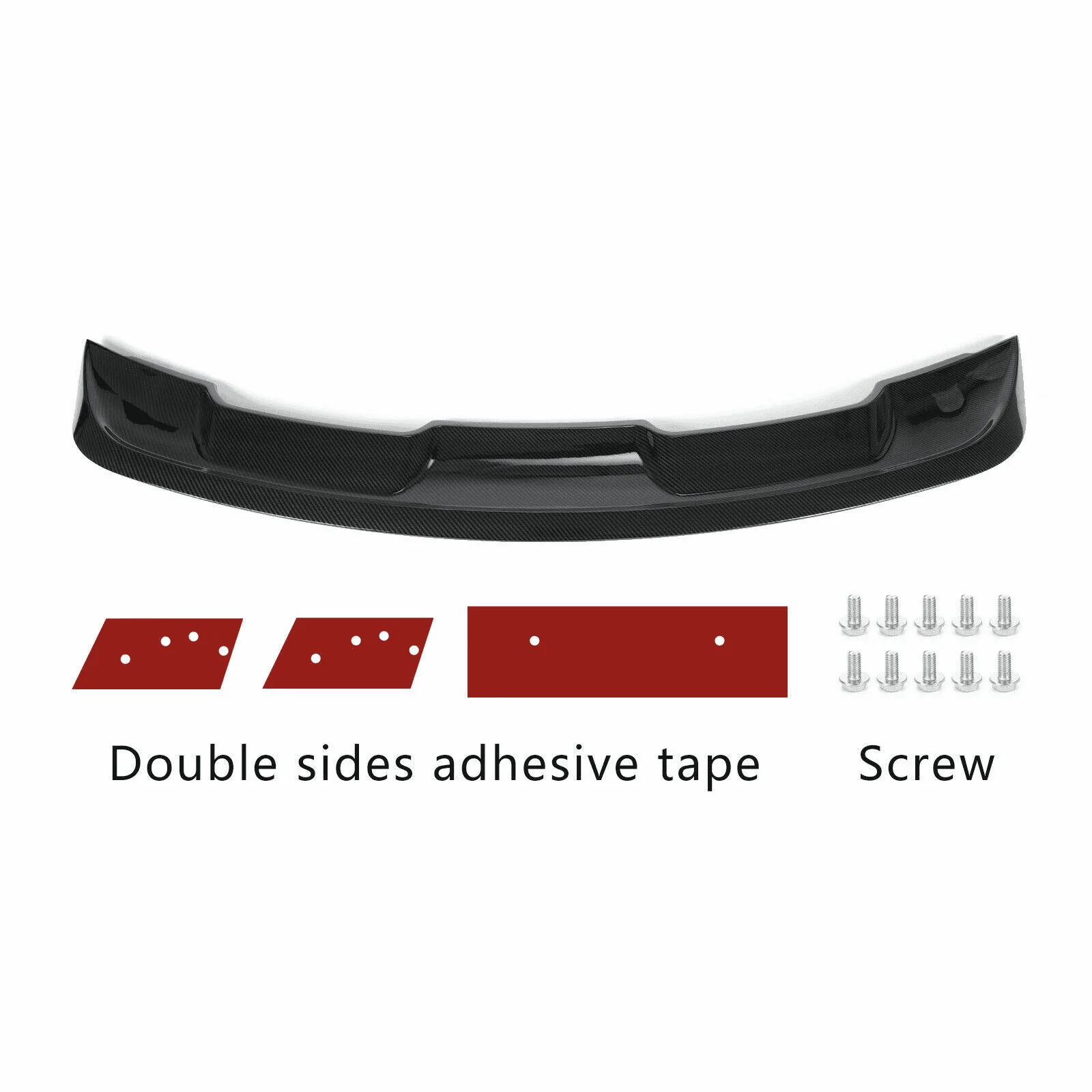

By any chance would you guys know where I could find this type of double sided tape or what size to use?
