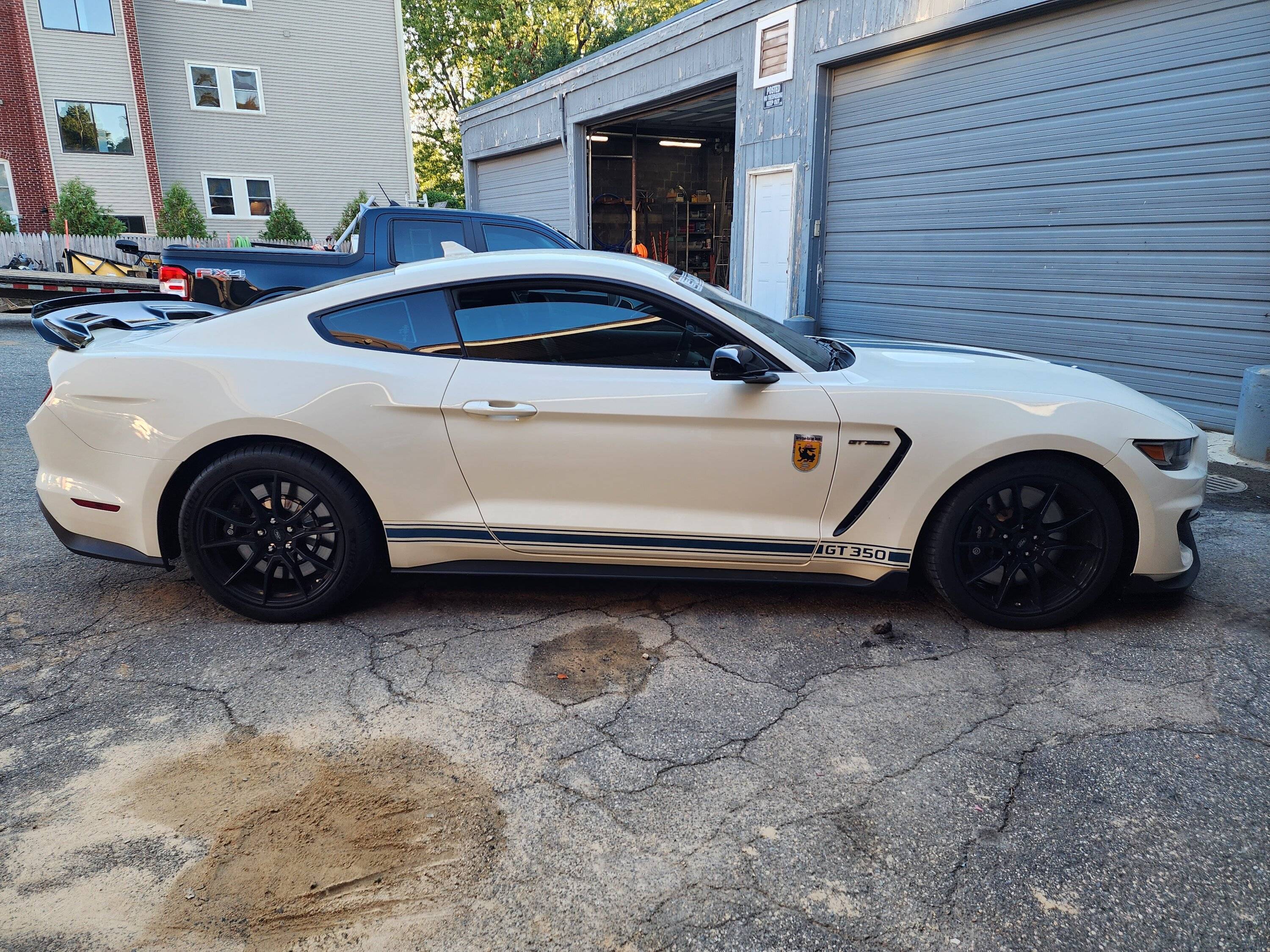

2020 GT350R
If I were spending your money, I would bite the bullet and buy 20" wheels. The 295/30/20 and 305/30/20 are the exact same height as your OE 19" 35 profile tires but there are a ton of readily available really good tires available in those 20" sizes.

thanks, but can I get the 4s models in a 20 size?
Yes, definitely. I have the 2020 GT500-spec 305/30/20 front and 315/30/20 rears. Slight rub of the plastic inner fender at full lock. A 295/30/20 would probably fix it.
