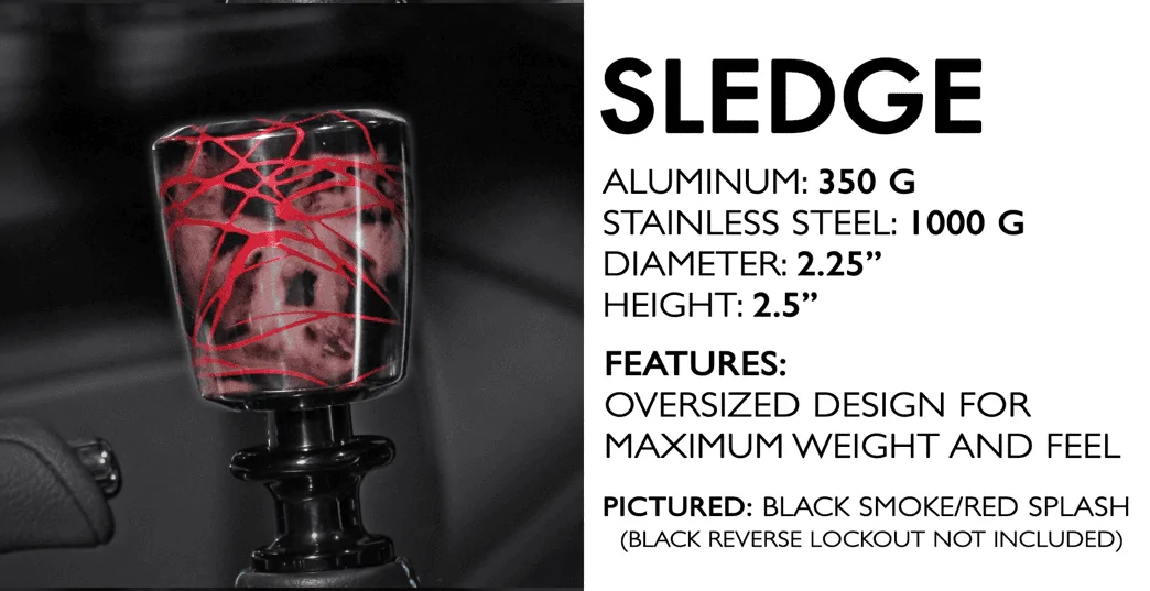

Anyone try the Billetworkz Sledge? 2.2 lbs of Stainless Steel:
