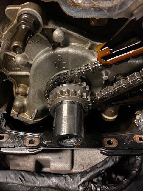

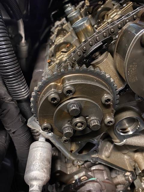

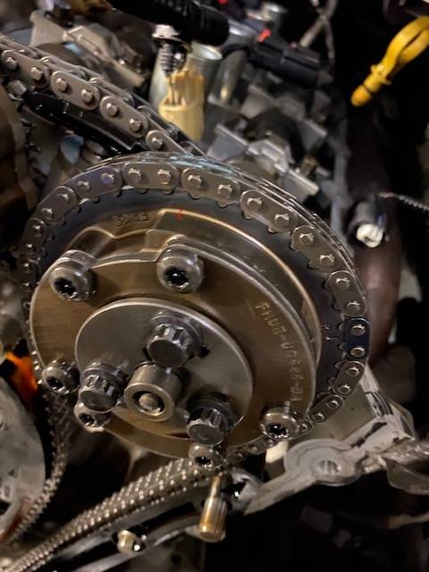

Before I removed the RH chain I set the key way to 12 o clock but did not verify the RH timing mark to also be on top. I then rotated the crank to 5 o clock and proceeded with the install. Does anyone know a way to fix this? thanks for your help

Take it apart and start over. Just follow the instructions to time the cams. It's pretty easy. Watch a YouTube video that may help to give you a visual of it.

If anyone else gets lost while doing this. I was able to rotate crank backwards to re align everything and then restart procedure. Running good now
