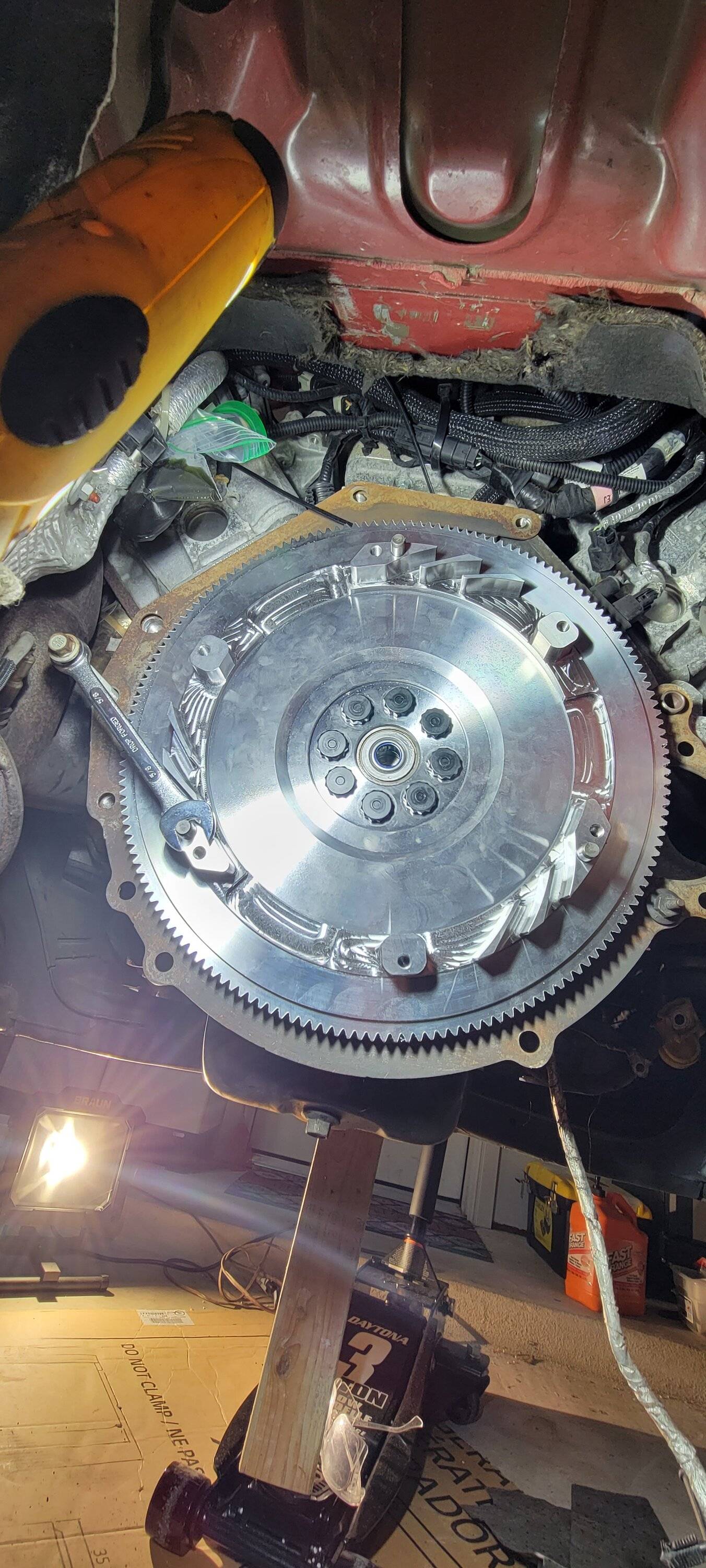

Anyone have any tips for the flywheel installation with one person? Trying to torque those bolts has been challenging by myself and I'm trying to find a way to hold it while not damaging the new flywheel.
Use a wrench to bridge the flywheel to a stud like this

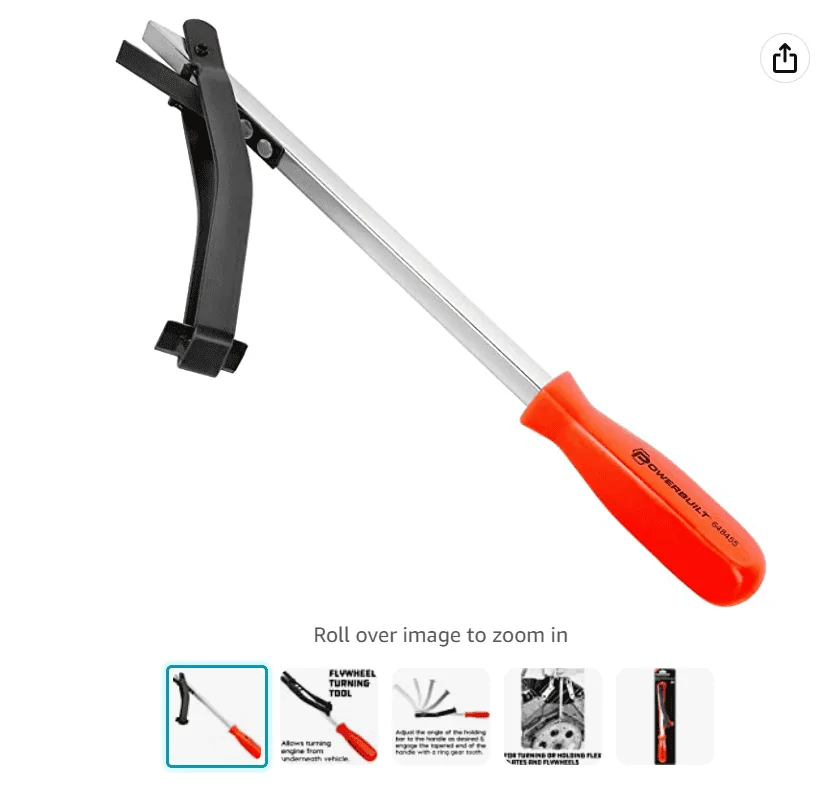

Pick up a 'flywheel turning tool' and easily hold the flywheel back when torquing down the flywheel bolts and the clutch:
