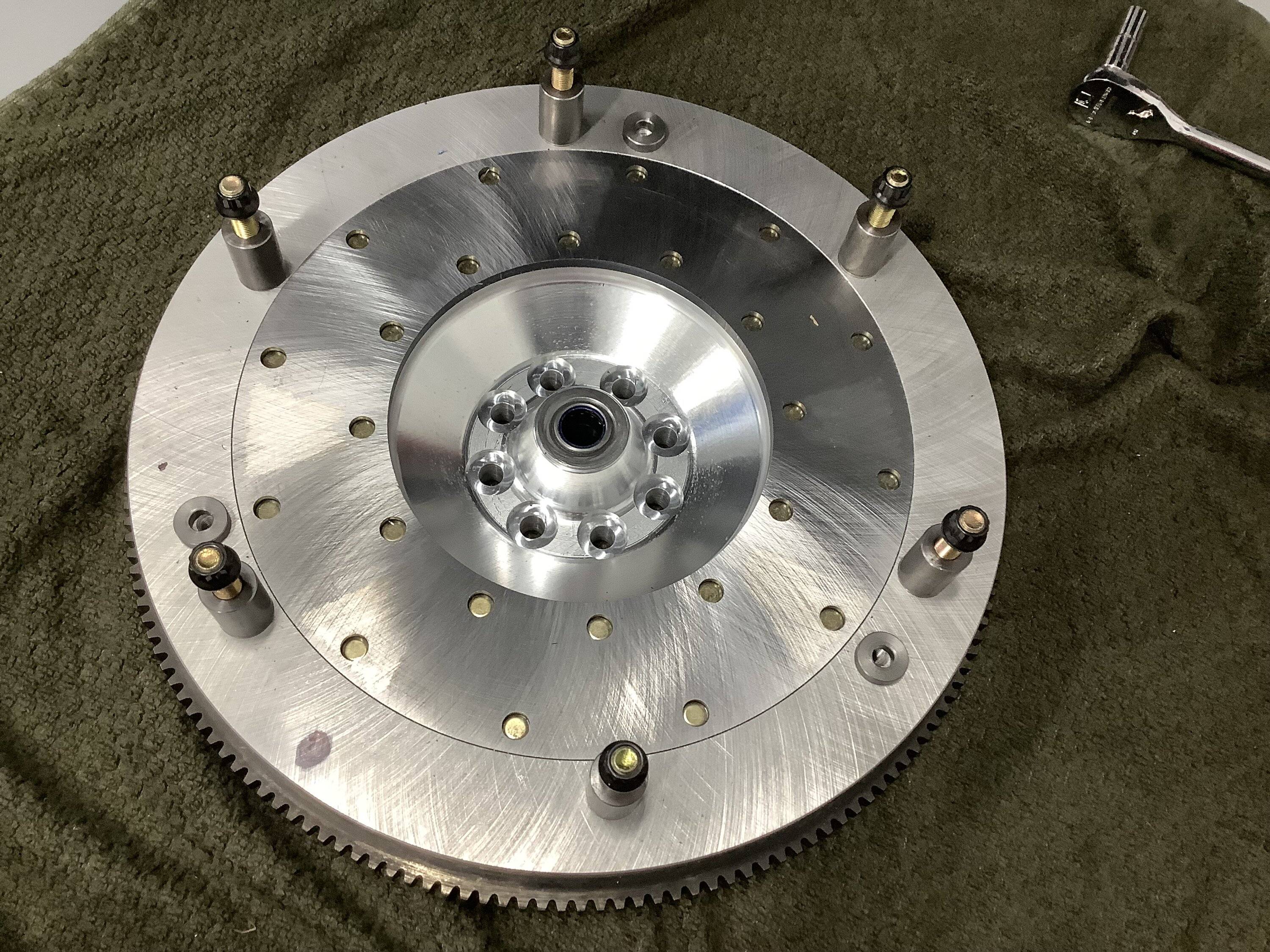

I have it out in the garage. Pardon the ignorance, this is my first clutch swap. It seems like the 2018 up kits have it built in, looking at the clutch in the package, it's already assembled but based on what I can see, it looks like there is a pilot bearing already.

Tough to see, it looks like the second disk is all that can be made out in that picture. You would be looking all the way to the back of that hole, where it bottoms out there should be a bearing up against the back of the hole. Is it possible to get a better picture focused down the dark hole in the middle.

Mine is a Ram Pro Street Twin Disc, but perhaps you can look at my flywheel (which has the pilot bearing installed in it) for comparison to yours to see if it looks similar.

Thanks for the info, I was able to confirm that the flywheel already has a pilot bearing installed, I'm not sure if that is the case for all clutch kits for the 18 plus cars, but it is for the RXT-1200.
