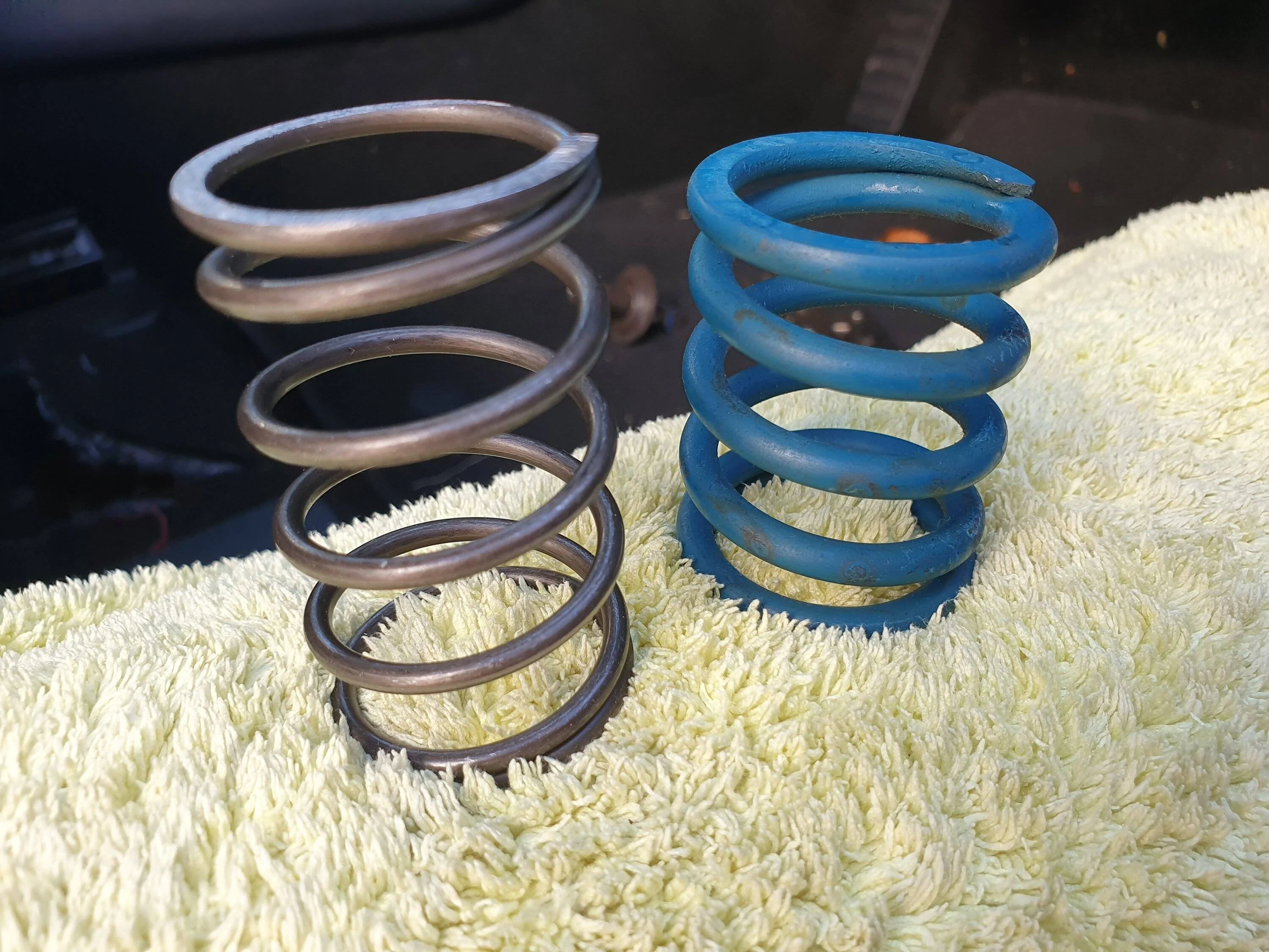

First things first.... Clutch spring, that inaccuracy has to go.
A 5 minute job at the most. In my personal opinion the new spring gives a much greater feeling of control when it comes to the friction point, overall a good mod. The only con i can think of is the clutch is a bit heavy while is stop start traffic.
Also, Why is my OEM spring blue? All the ones I have seen on the internet are the same colour as the new Steeda spring. Any ideas?

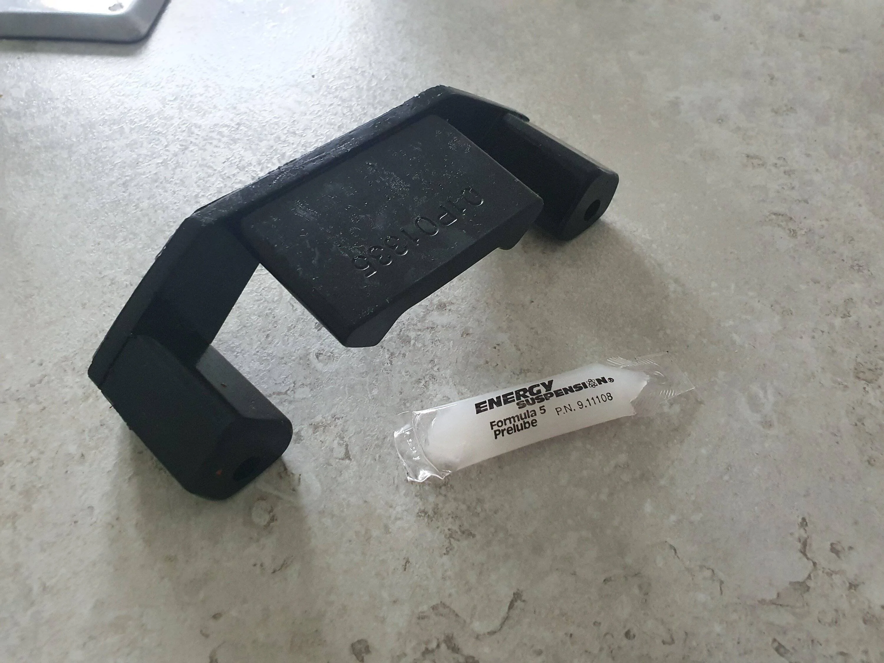

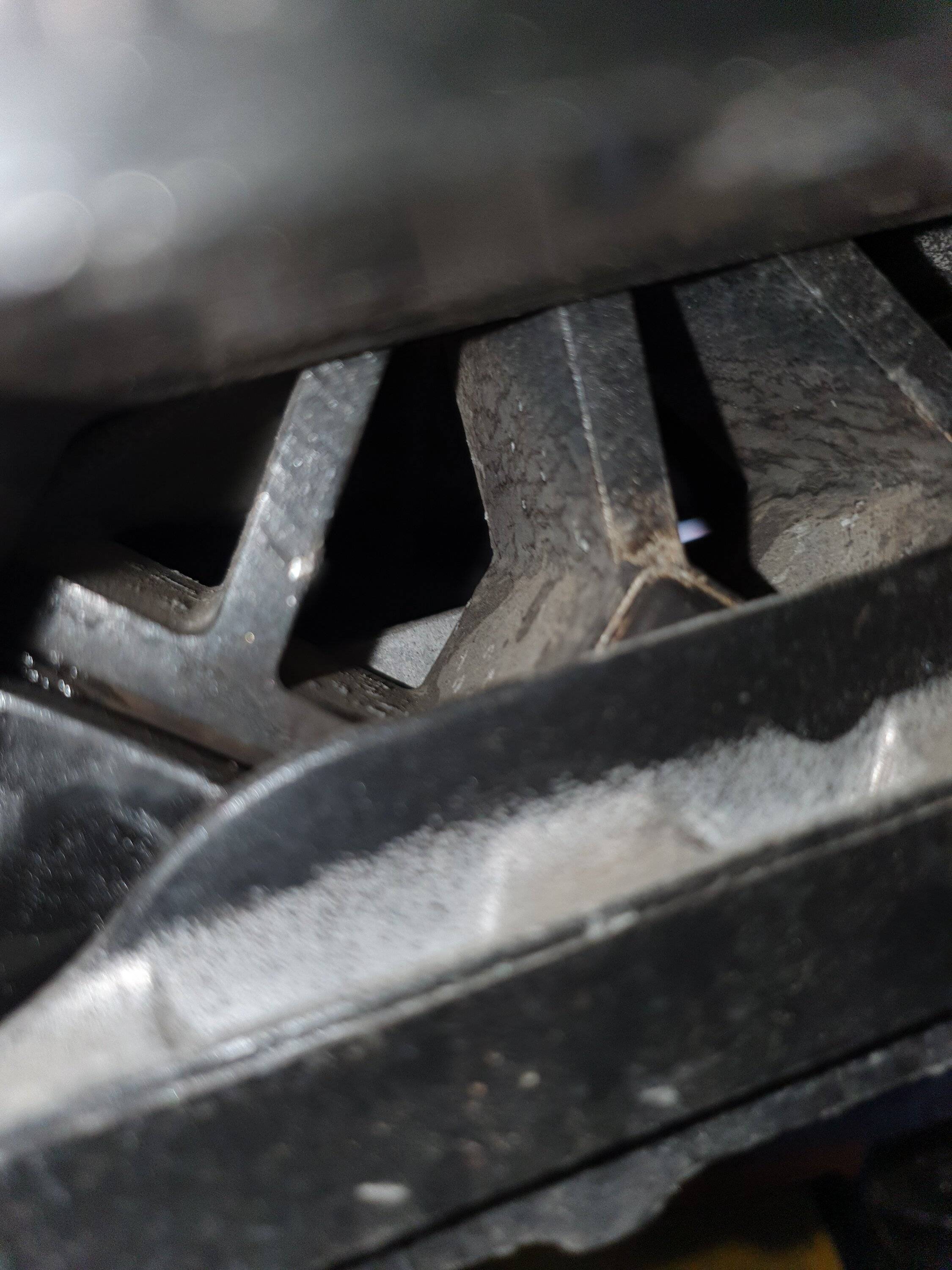

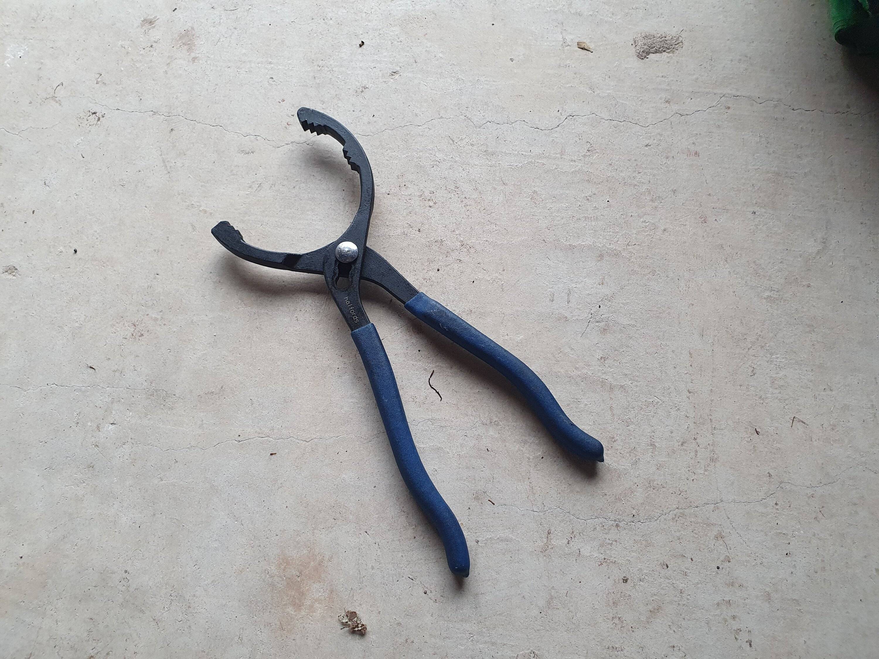

That another mod down, the Steeda gearbox mount insert has been inserted...
Overall not a bad little job to do more than possible with a jack, stands and a bit of arm strength, if you dont have a buzz gun. Pushing the insert in is probably the hardest part. Just use lots of grease, my biggest recommendation is get an oil filter removal tool (Weird I know, I have added a picture of the tool so you know what i am on about) and use that to squeeze in the insert. This makes the job way easier.
Steeda insert:
Oil filter removal tool:
insert in place (Hard to see. it is the bit on the left):
Final Thoughts:
Pros:
I think as far as "bang for your buck" goes this is a great mod. On first impressions i have notice how crisp the gear changes are while under acceleration and how much more alert the car feels when you get on the throttle. If you are thinking about doing this mod, just get it done.
Cons:
Absolutely nothing, due to the insert being polly and not aluminium you dont get that increase in NVH, that a lot of people complain post installation.
I will update the thread with my long term thoughts when i have put a few more miles on it.
Mine was blue too, perhaps its a RHD pedal box identification thing ?

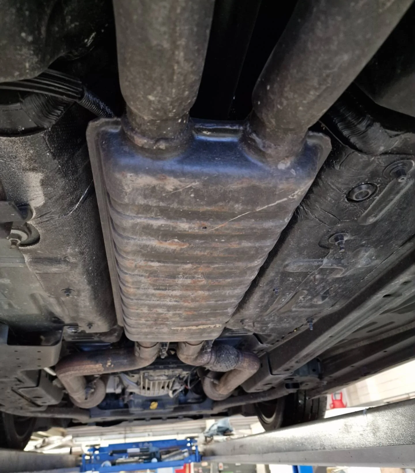

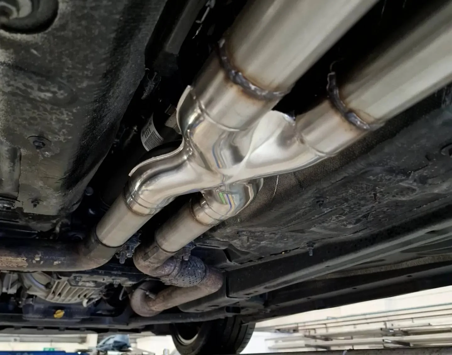

So in my original plan, I said H-pipe. More specifically the Steeda H-pipe but, an opportunity come up to fit a development X-pipe fabricated and fitter by a local company.
Very happy with the sound. In my opinion this is what a Bullitt should be like from factory.
